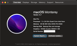

Flawless!

I simply did the Open Core Legacy patcher process similar to what video the other user posted however there are other steps needed if you want to boot into OS without your thumb drive installed.
Remember the install process has 3 - 4 reboots so you have to wait quite a few cycles before the install is completed. To boot without your USB drive, you will need to likely complete the following steps.
1. Install OpenCore to your intended new boot drive. (this needs to be done in a working OS)
- I'd also suggest going into options and set a longer boot picker selection time.
2. Boot into recovery mode (MacOS Installer also works (IIRC))
3. Go into Terminal.
4. View your drives in Diskutil
5. Mount your EFI Partition
6. Bless / set boot to your Open core EFI instance.
7. IF your system does not show boot screen (such as the case of my system) you will have to (perhaps with trial and error) blindly select your boot instance and hit enter (side arrow keys).
Link to article on this
YOU HAVE TO CLICK "Note for Mac Pros/Xserves/iMacs with unflashed GPUs" to see detailed commands
My 3,1 only has one OS so my boot picker (if shown) would have few options to select.
Overall mine has been reliable and stable.
