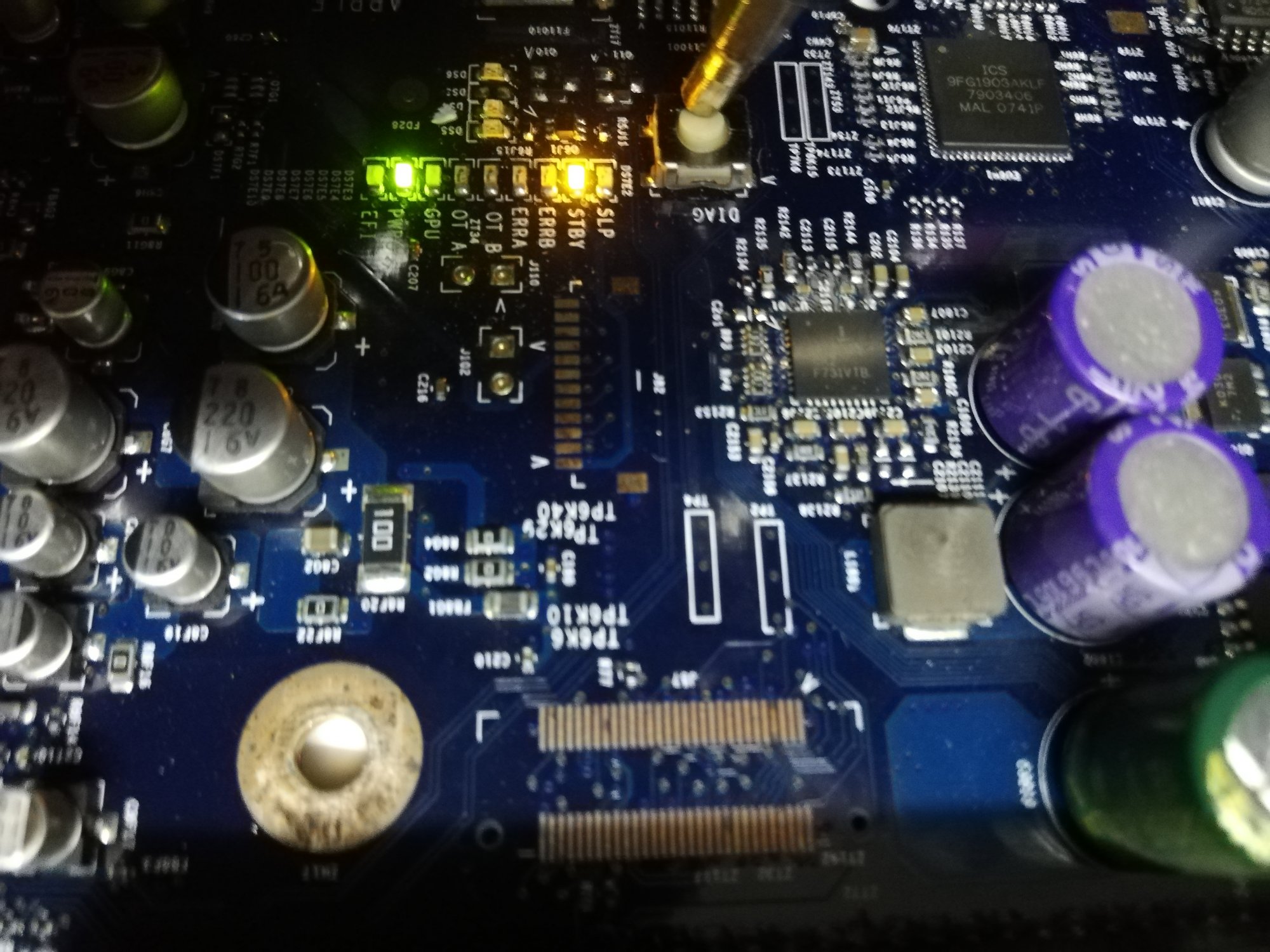

And there is no error (red) Led on indicator. Just I see 2 led. led 2 (yellow ) and 8 (green) is on when I click check button.
I have suspect about PCIe Slots or controller of them.

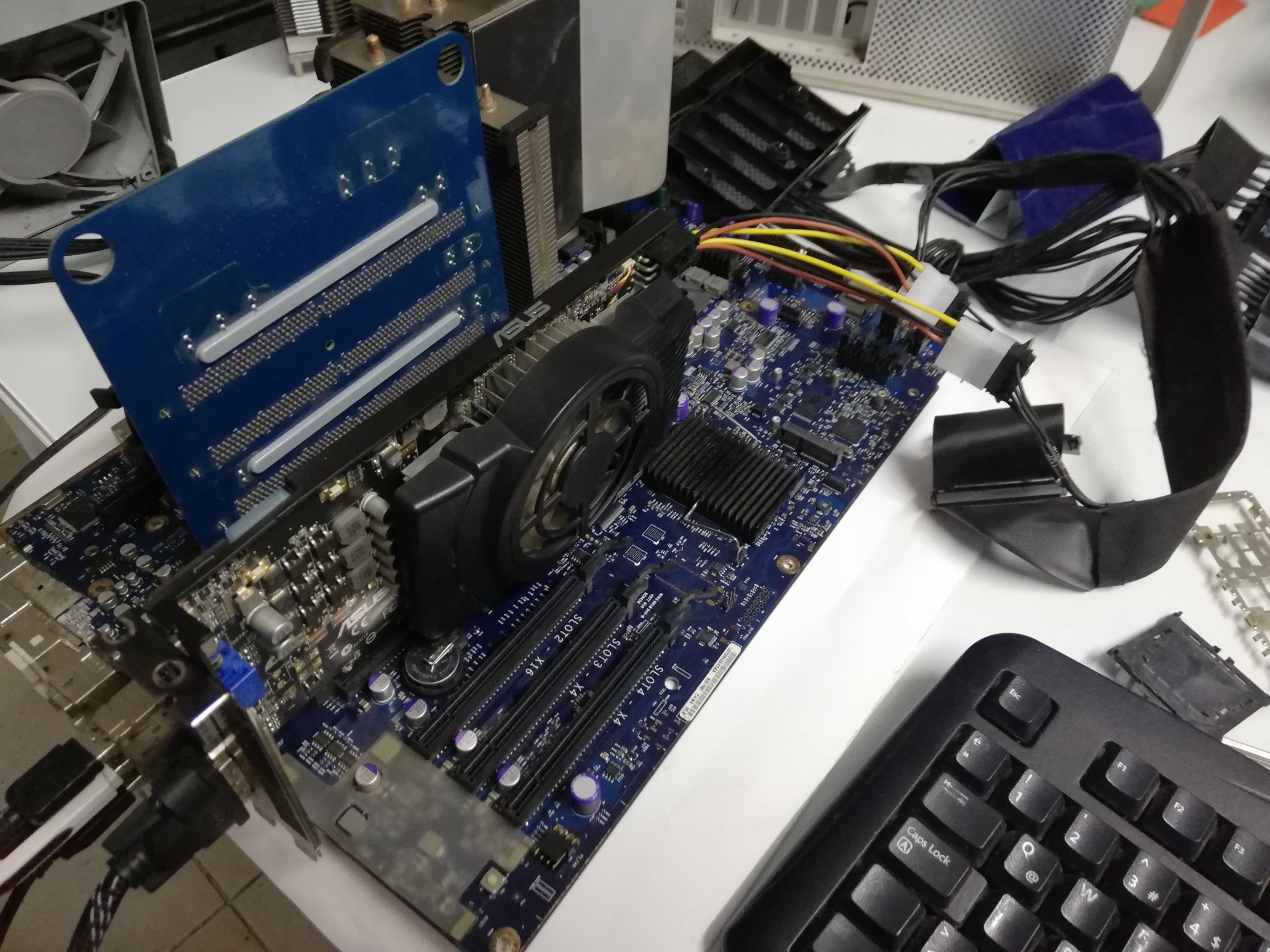

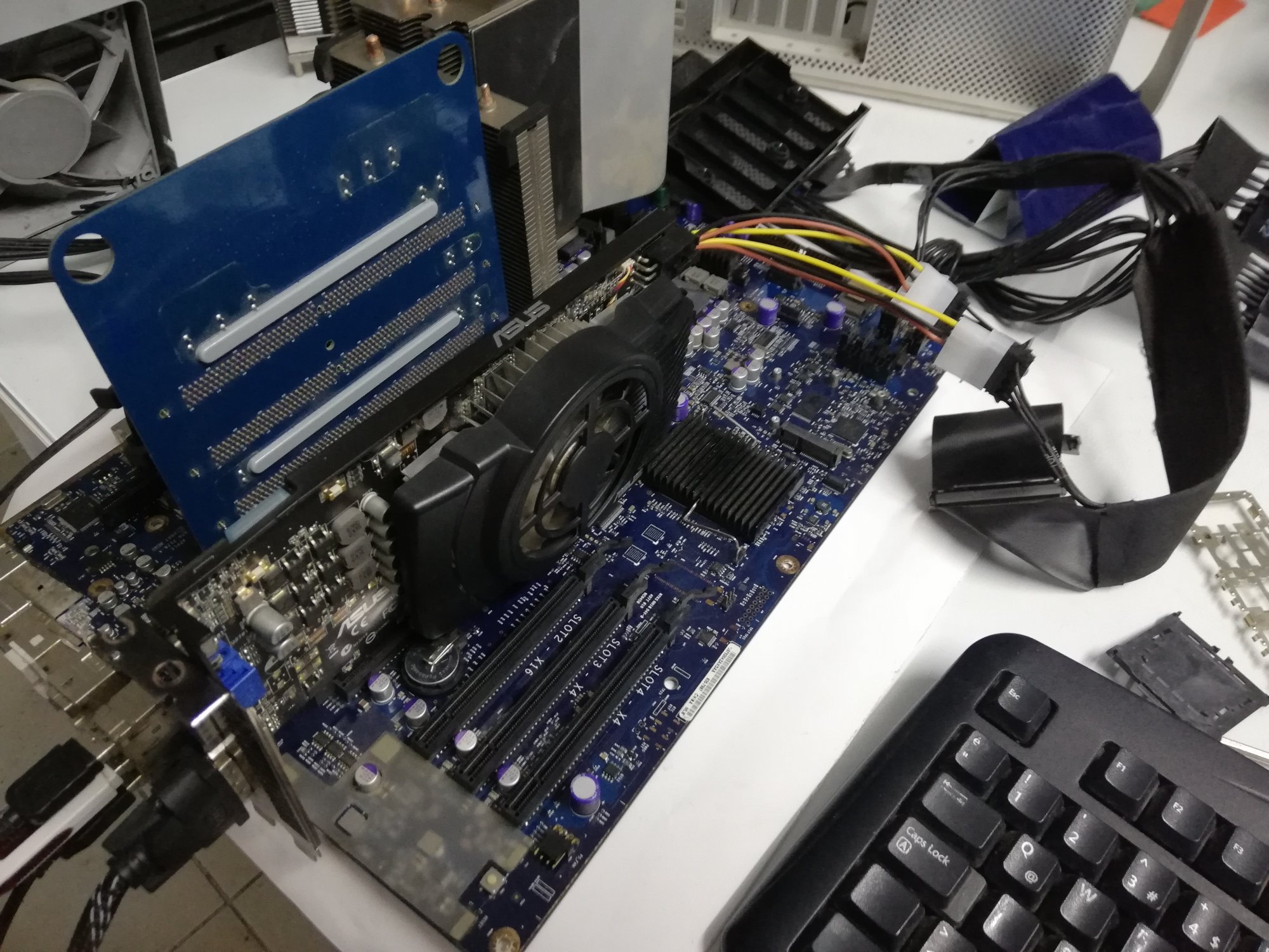

I Guess I find my problem. My problem is No GPU power on logic board.
This morning I was reflash my Asus 5770 Vga Card For mac. And this card have Power connector for extra power. and I Pluged power connector to dvd power supplay cable. and My mac open correctly.
nvidia 7300 and Ati 2600 Card don't have extra power connector. and that supplay power from logic board.
Anybody know How can I fix Logic board Gpu Power?

I checked psu With my Electronic technician Friend. All Voltages is correct. İt's mean my Psu Working correctly.
İf Graphic card have extra power connector, it is working correctly.
But if graphic card just using Pcie slots Voltage it is not working.
When I install double gpu I can see Gpu information on Mac os.
But I can not get video from thats video cards
Re flashed Asus 5770 with Extrarnel power supply . -------> Working Good
Oginal Radeon HD 2600 XT No extra power connector ------> Not Woking
Oginal Gforce 7300 GT No extra power connector ------> Not Woking
