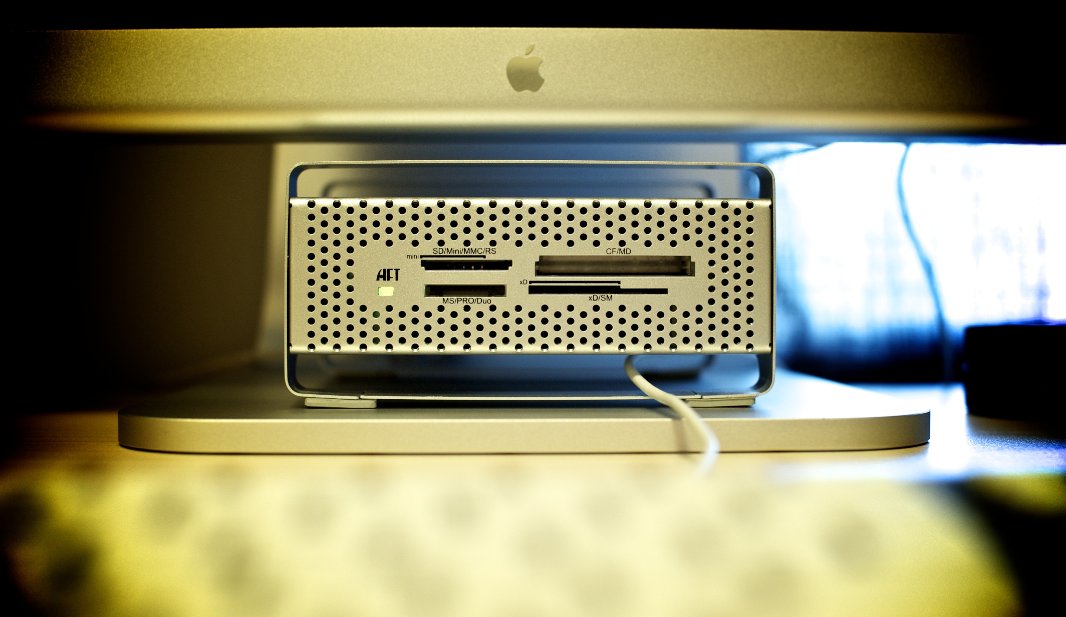

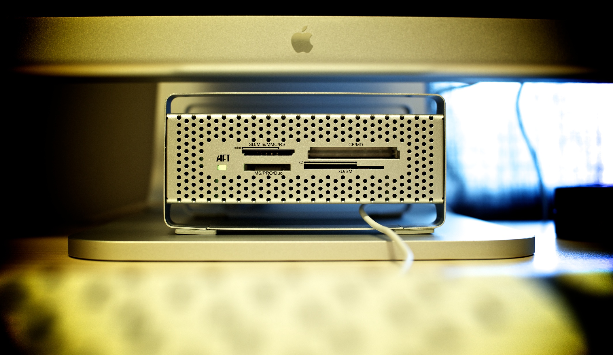

Unfortunately only USB 2.0.
Available here: Nervian
That's the one I was thinking of, but couldn't recall who made it, let alone a model number. 😱 But it seems to be the best fit IMO.
Just put small items such as SD cards, CF cards, USB sticks,... in a small plastic container that the cat can't get into. Makes them easier to find anyway, as I have had issues where they've fallen off of the desk and been hidden under furniture (or even rolling over it with my chair... crunch... 😱).
The Mac Pro optical bay door is a slider, so I don't see how it can work; as with CF, well unless you use the high-end 50MB/s CF cards, I don't see the benefit in wasting a SATA port; if anything you can always get a FW800 card reader.
Also site hasn't been updated in 2 years 😛
