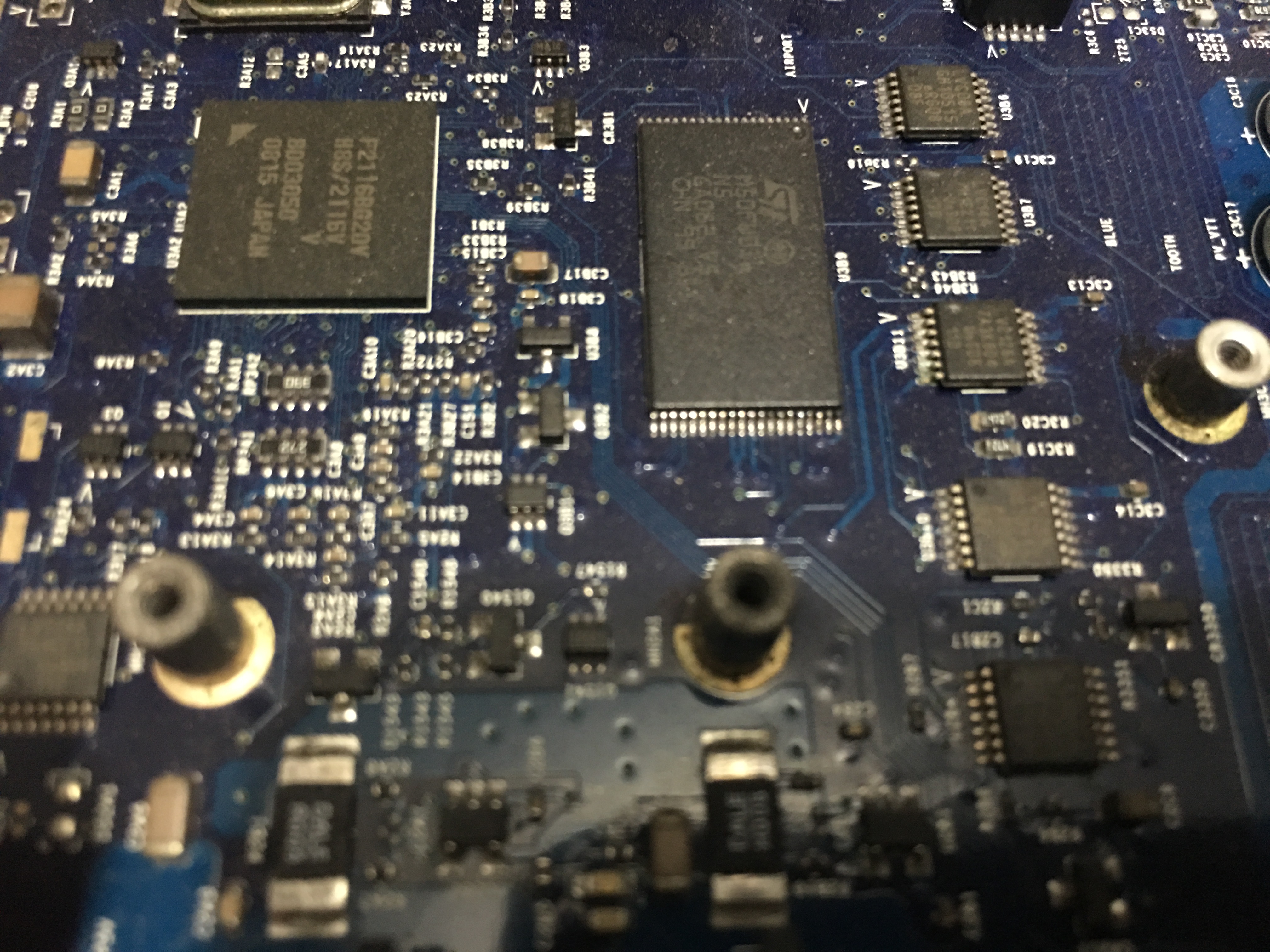

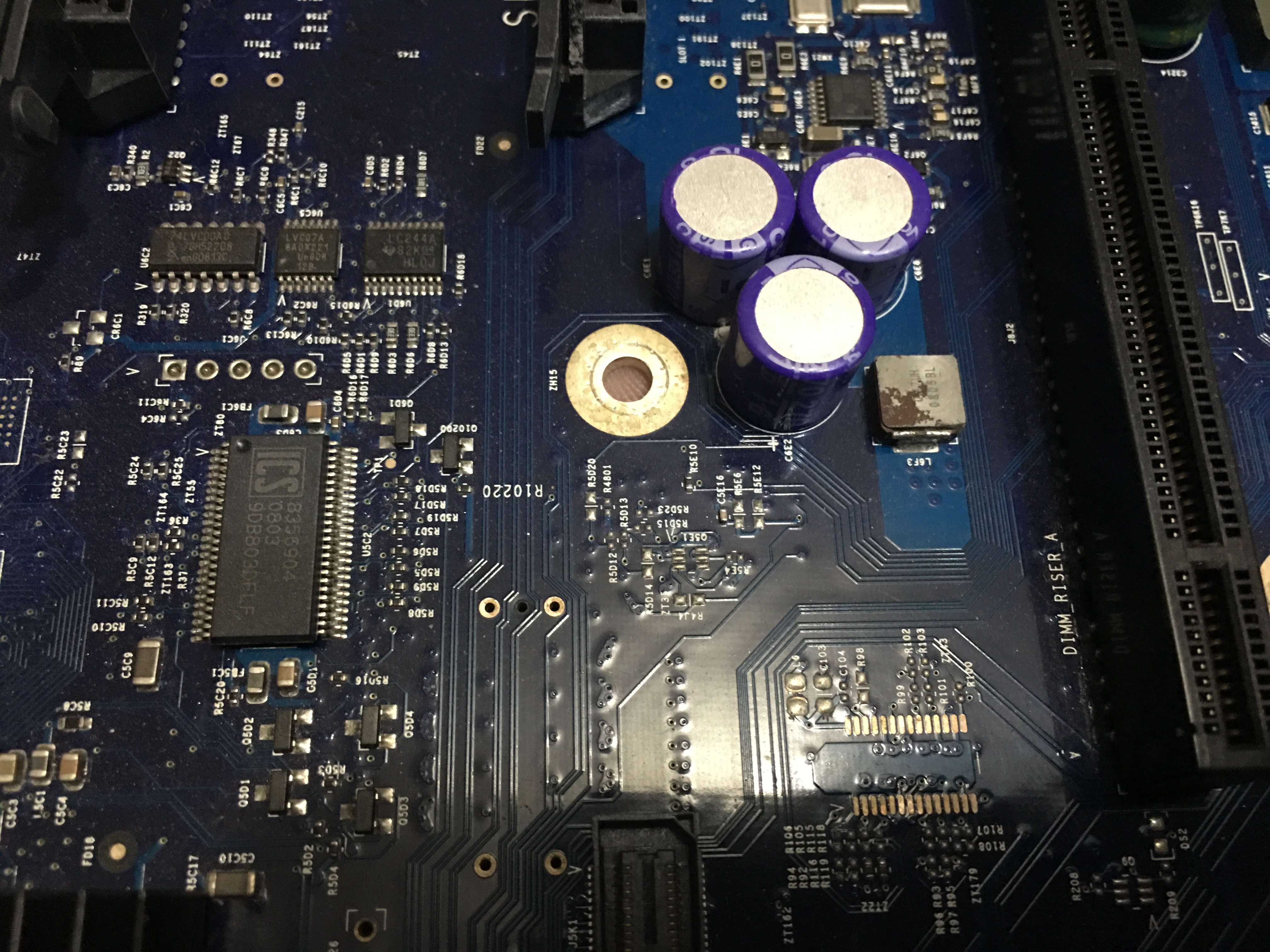

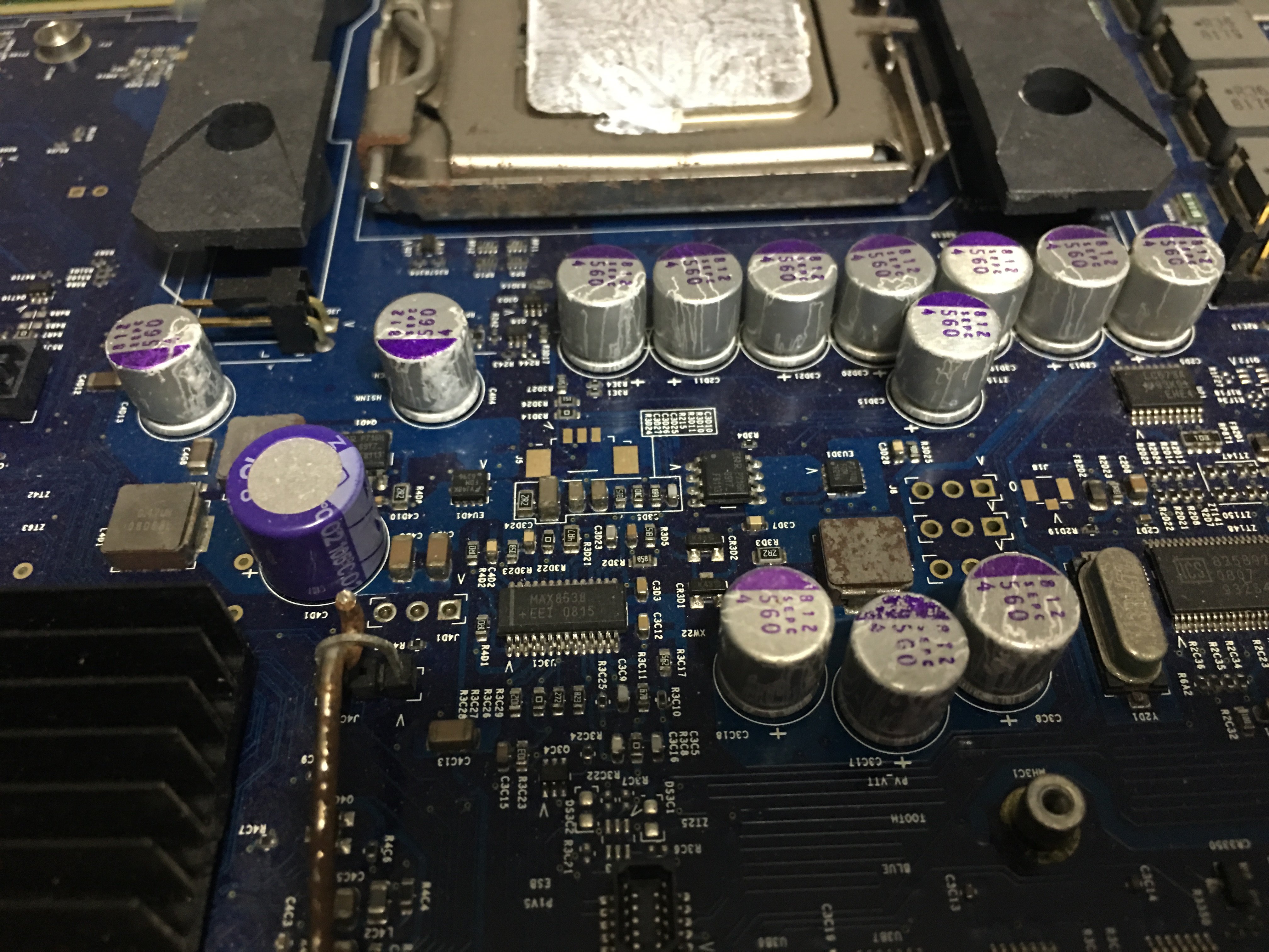

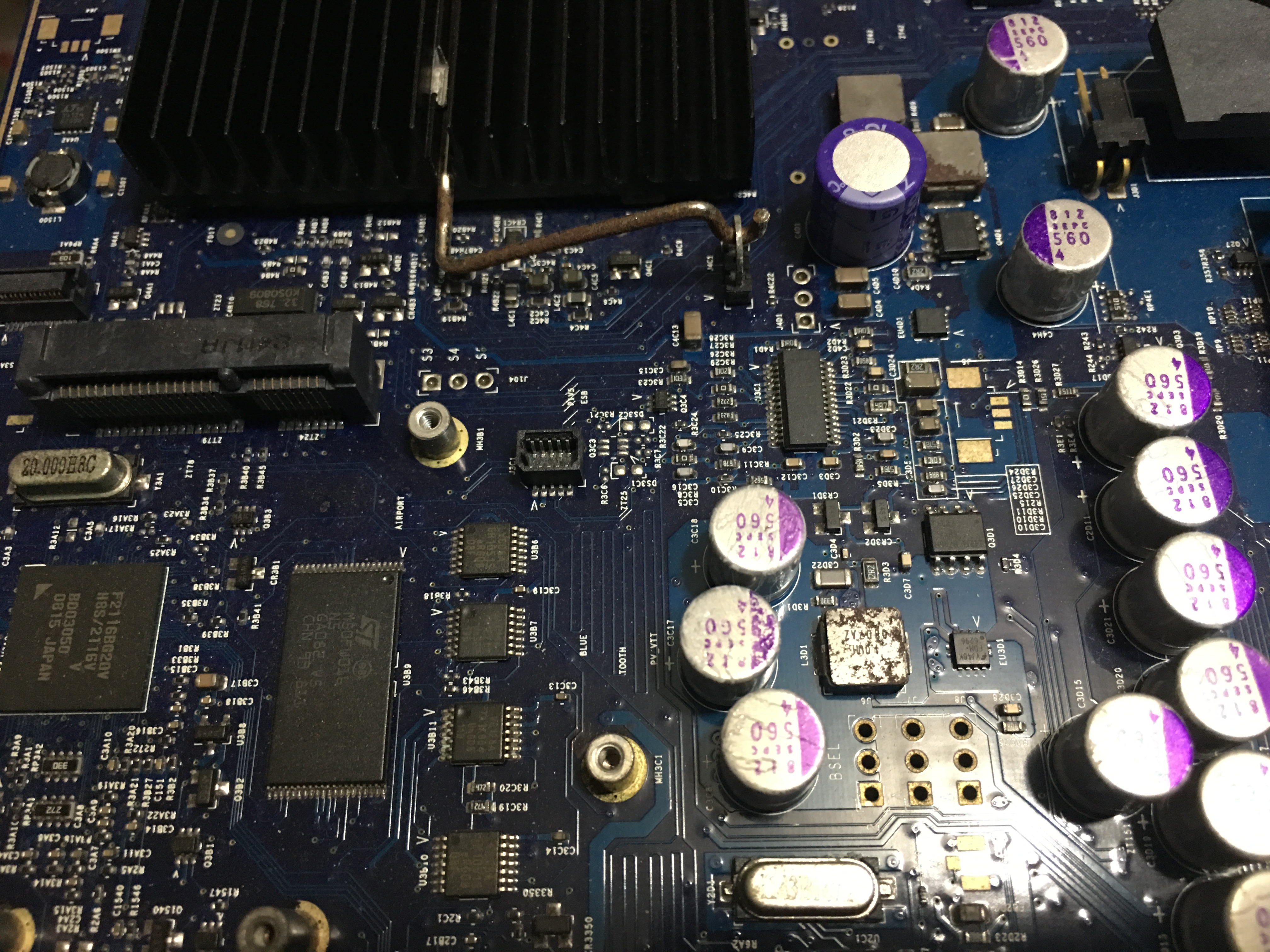

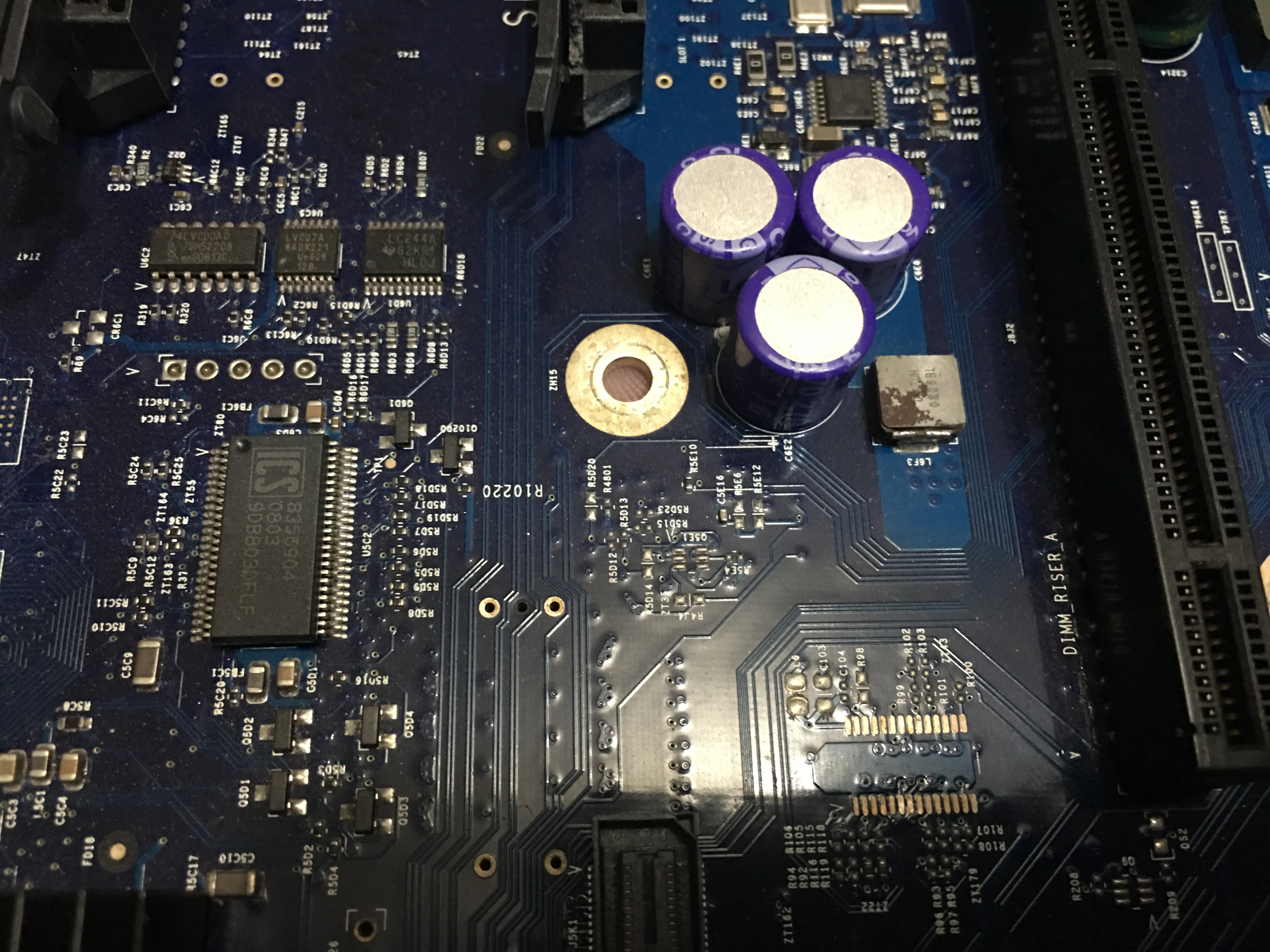

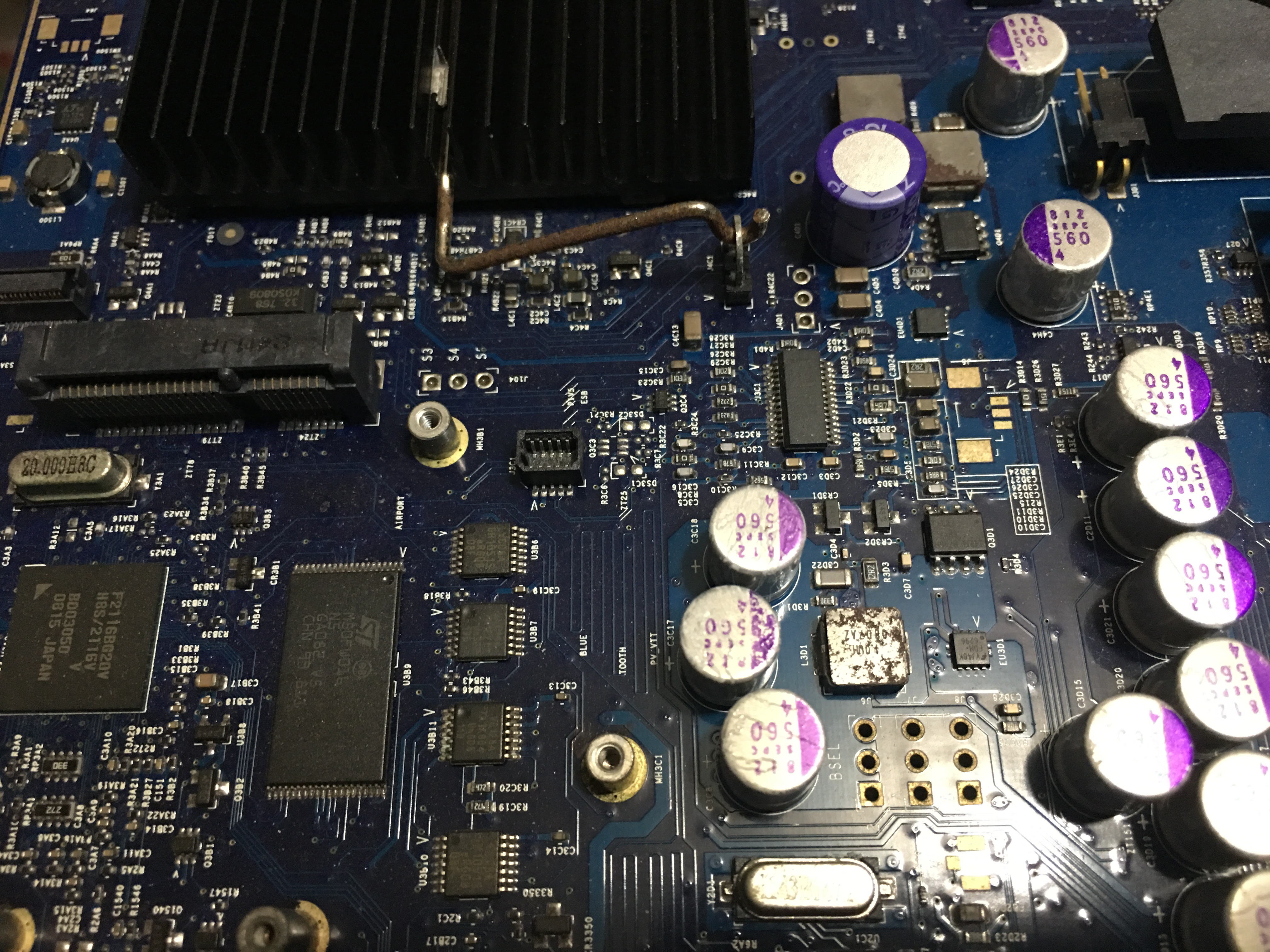

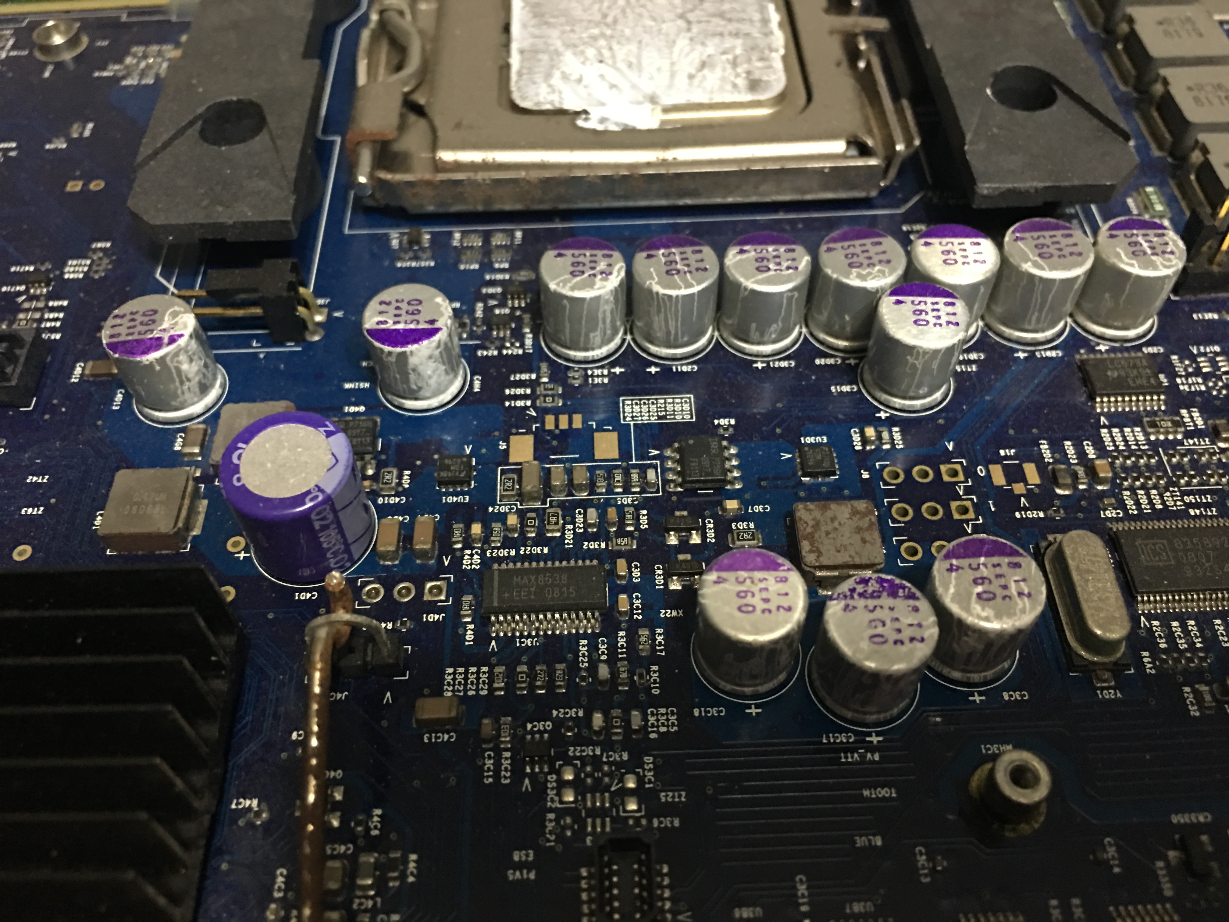

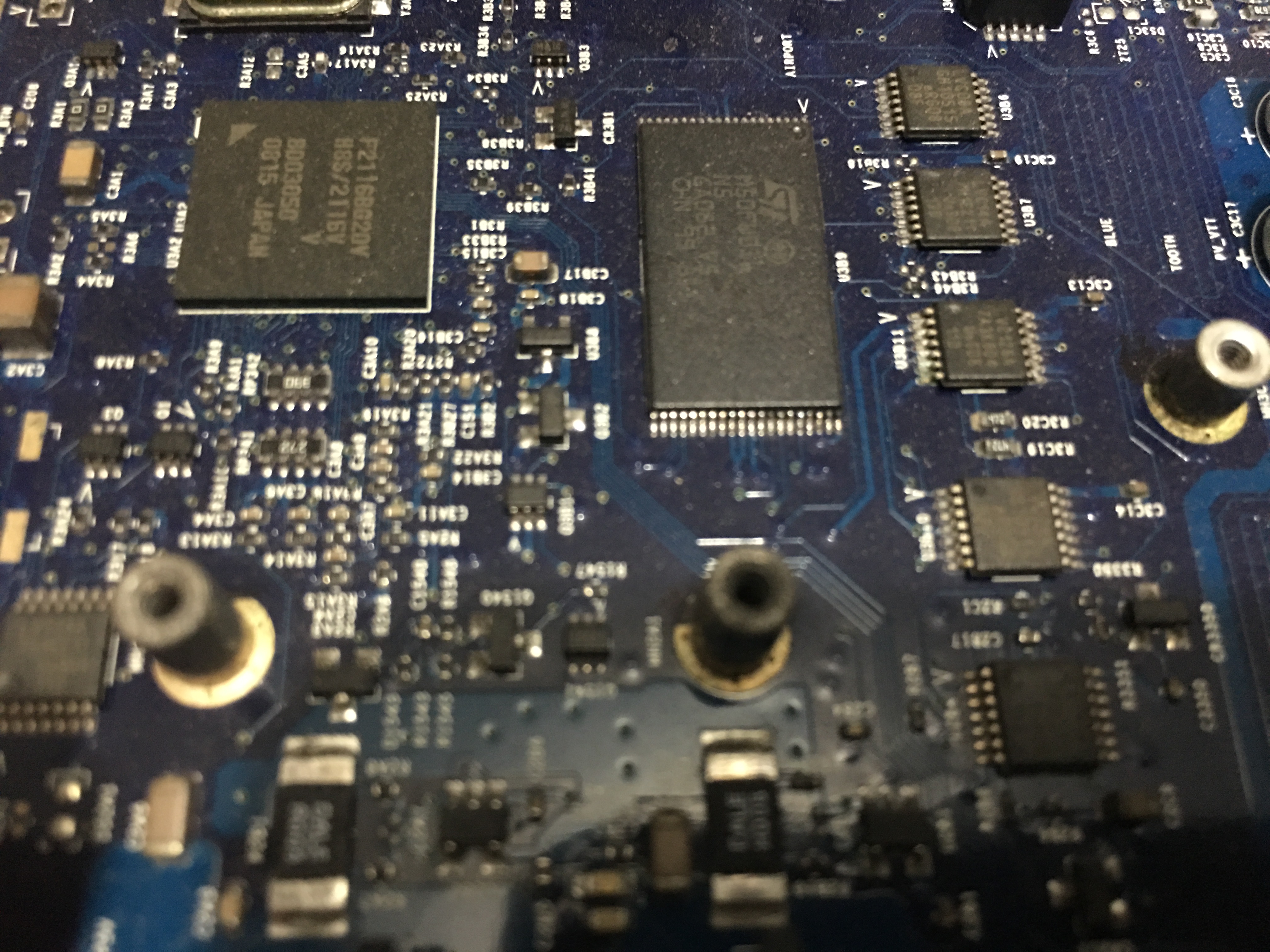

A little bit everywhere, two Macs originally from cities that have strong sea air corrosion, don't know the correct english term for "maresia".
I still have both boards, I can take pictures of what is corroded. One you can see it clearly, the other is subtle.
This is the less corroded one, if you just look rapidly on the board you think that is almost new. The other is a lot worse.
Look at the SMD inductor:
Processor A socket, every capacitor, south bridge heatsink:
Look how the corrosion went on the pads of the TSOP FWB flash memory that stores the BootROM:
Thanks for the reply! the logic board looks pretty flawless to me. Im the original owner, has never been left in super humid environments.

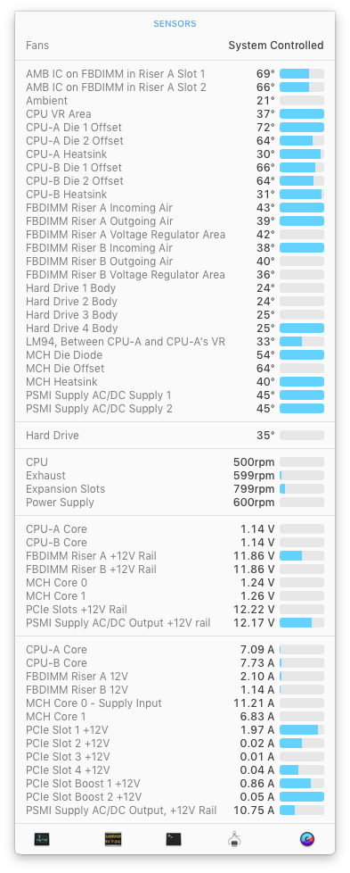

Staying mostly between 40-46 C....
