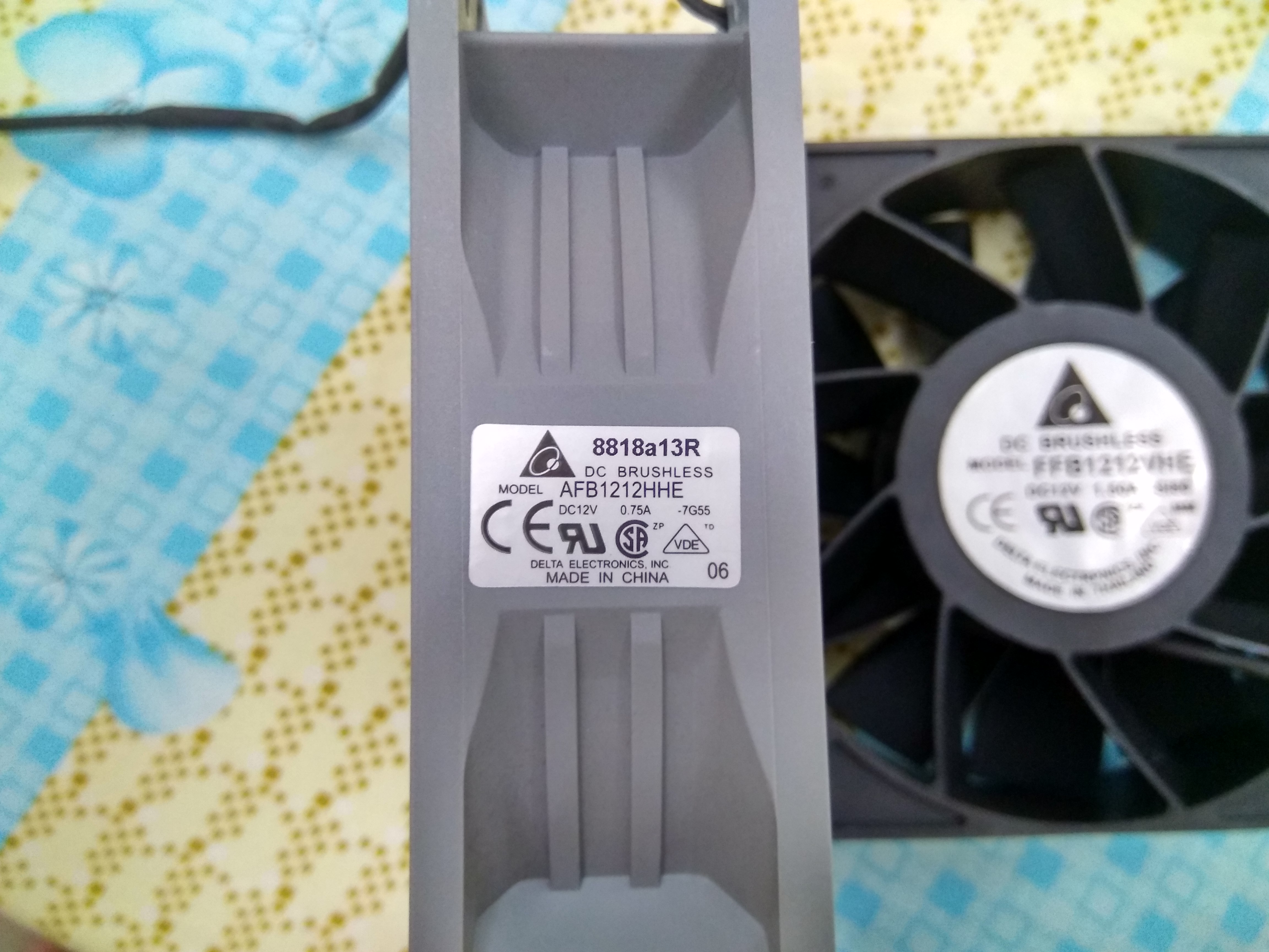

it is indeed a beast,a monster.this is what i found.both fans have the same dc12v but different amp,0.75a vs 1.5a.this could be the cause.Still,following the approach to draw the current direct from the molex is it going to work or not?

Yes, drawing power from the molex will work. Use a splitter so you aren't hacking into the factory wires. And also makes is undoable in the future if needed.
On regular molex splitters, the yellow is 12v and red is 5v. Black is ground.
If fan says it's 12 volt, then run on 12v for highest speed. If you connect it to 5v it will spin slower.

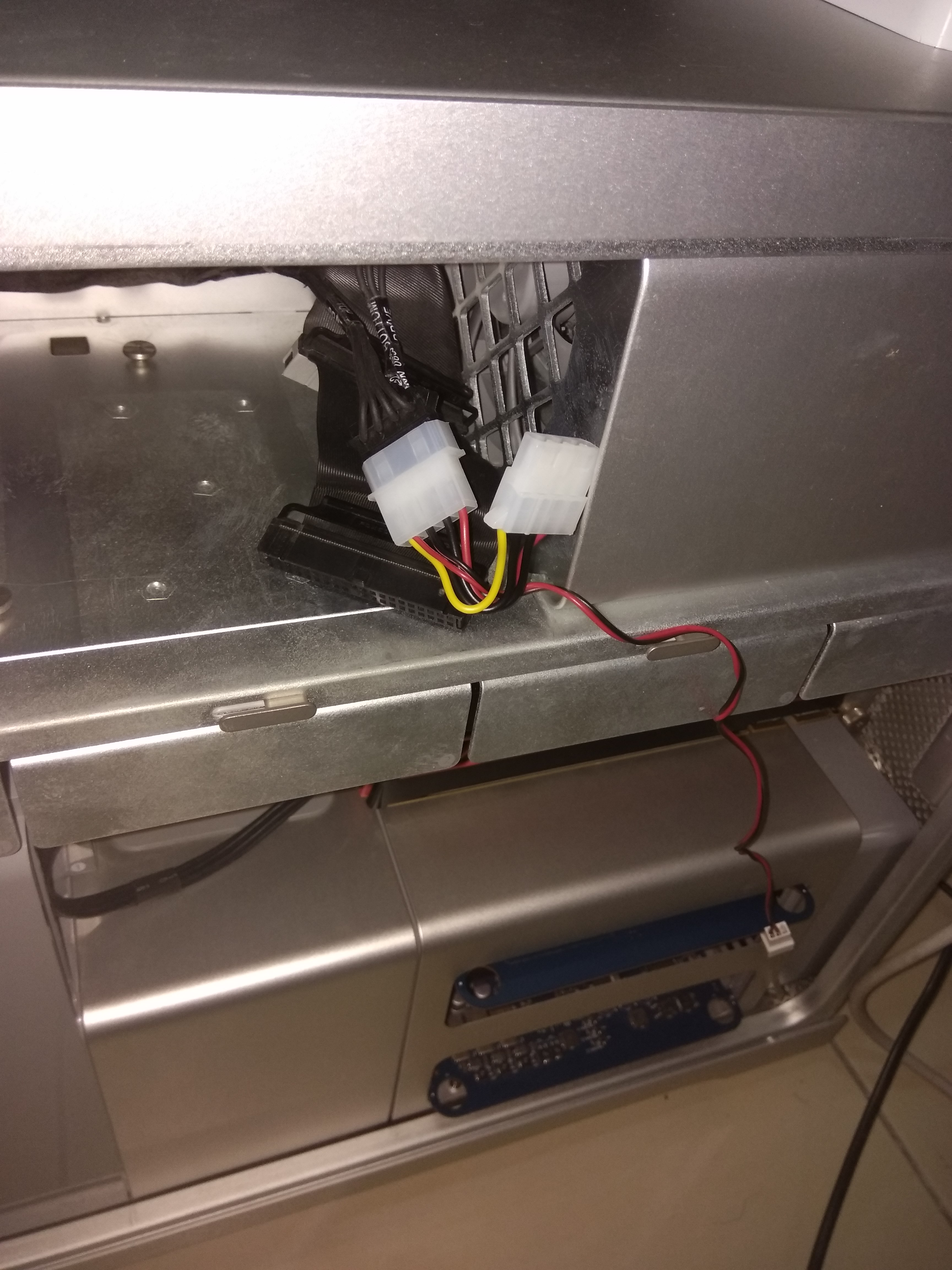

hey guys
sorry to update the post late...ordered the molex and it took 2 days to reach.
It works finally! though not from the rear fan connector but from the PSU via 2 different molex connectors.
thanks guy for your input 🙂

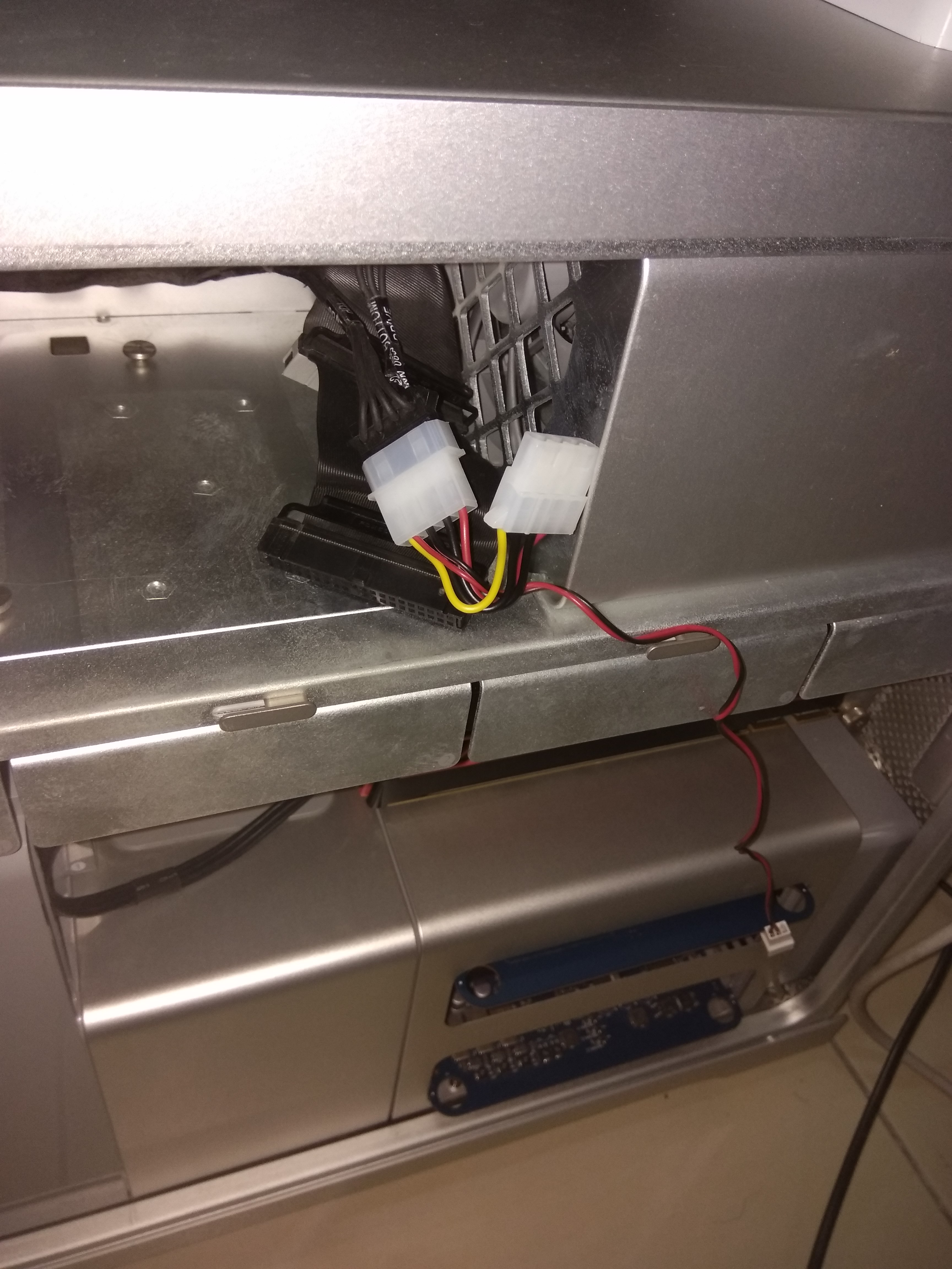

[doublepost=1474645070][/doublepost]given a photo,this is what i have done.

Glad it's working. Always happy to help.
If you're looking for a cleaner routing path, you can snake the wires through a hole near the front of the machine in the DVD compartment. There's a cable pass through area there.
It'll come out about where the front case fans are. Then run it under the housing for the memory modules.
Just watch for heat sources. Like don't rest the wires against a heat sink.
Glad it's working for you. Always happy to help.
