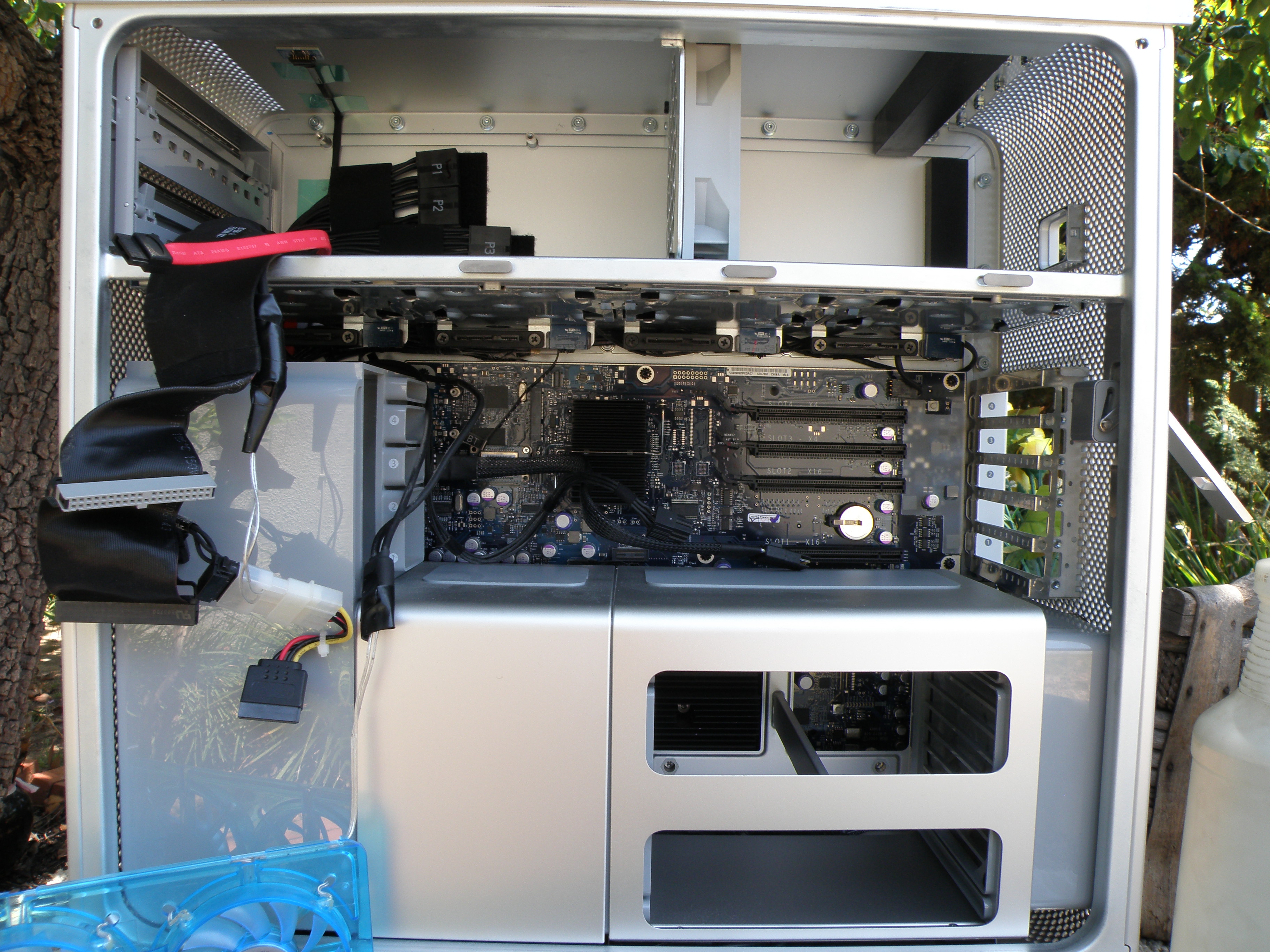

Is your 3,1 clean enough to eat off of? 😛
Check your PSU for signs of a dust storm!

She used to be, but of late....
Will go find the air cans and go make some mess 😀

Heat and dust cause tons of problems. Blow that guy out and give it a shot. I once "fixed" my friend's Quad G5 by taking an air compressor to the thing. It wouldn't even power on, and then POOF. Totally fine.

Did give it a clean, must admit that it really wasn't that bad at all.
