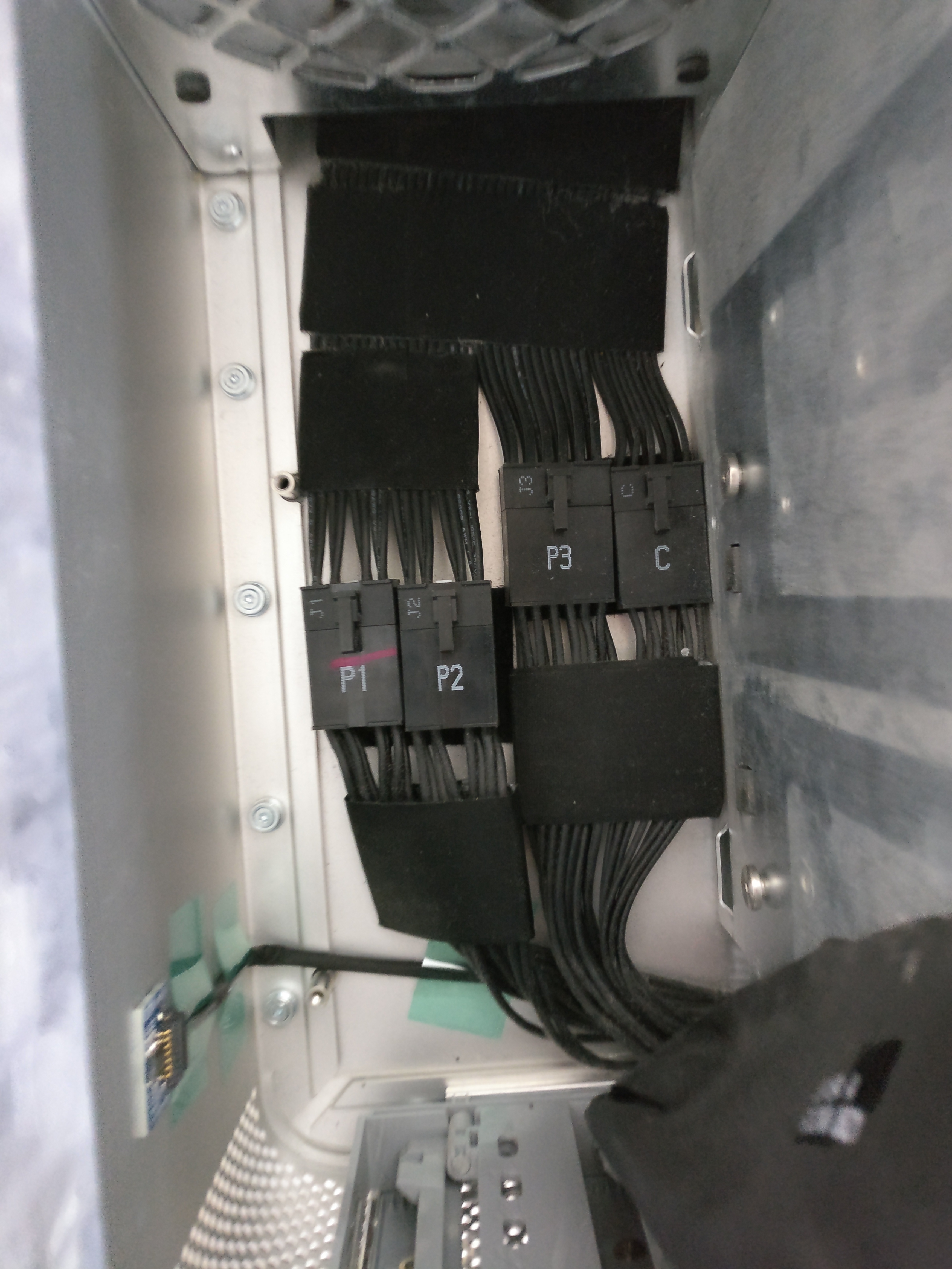

Please forgive me for bringing this old post up again. I understand that I am VERY late for the party.
As you guys agreed, that led really means sort of power problems. It is also true in my case.
Mine started to shut down randomly yesterday, and it would not power up any more this morning. When trying to take the psu out, I noticed that the two of the connectors under the cover plate behind the superdrive were loose. ( P1 and P2 in the image) After I replugged them, the mac works fine again, at least by far. I just cannot understand how they became loose in the box. Possibly sunlight heated it up lol?
Hope this could be useful for you who have the same problem.
