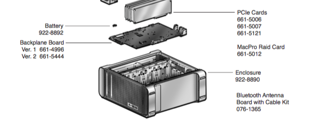

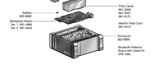

I have BootROM dumps from @calmasacow backplane and the one here, both are from the start of 4,1 production. Apple has two versions for 4,1 boards, maybe it's something that they improved on version 2. I'll check this when I have a v2 board on hand.
I have 2 MP4,1s...would a BootROM dump from one of them help you if it's v2? Where does one look to determine that?
Part Number:
Backplane Board
Ver. 1 661-4996
Ver. 2 661-5444

I have one backplane with the blown fuse to repair, can't find the right one to buy and replace.
May I know where is the fuse location? I didn’t realise there is a fuse on the logic board, and want to know more about it. Million thanks in advance.
My 2 boards have the same markings. Cannot find the ordering # (661-...) on them, but the part numbers I did find are the same:
To the left of the CPU Tray connector: 820-2337-A
Bottom right of board under barcode: 631-1009
Would either of these help you?
EDIT: Checking serial #s shows approx. production dates of Mar 2009 and Aug 2009. So, I'm guessing these will be V1 boards.
Apple have order numbers and part numbers, it's so confused. Take pictures of both labels, left and right of the CPU tray connector and PM me, I'll check with mine over the weekend.
