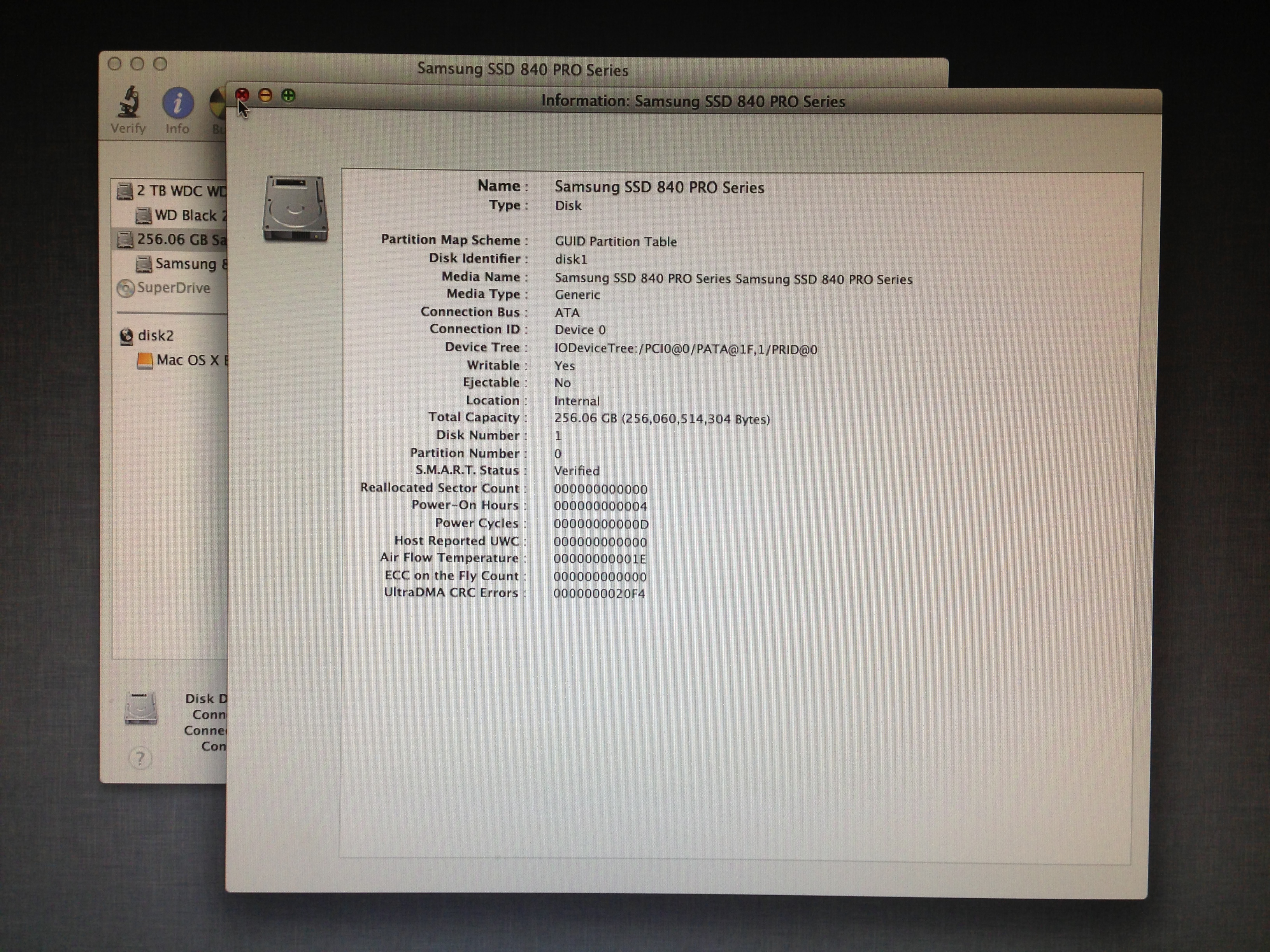

Hi everyone, been having issues with installing ML onto a new MP 3.1 which have purchased recently.
Currently have the SSD drive sitting in spare DVD bay connected with a IDE-Sata converter which drives a SATA B.Ray drive in another MP.
My issue is that while i can copy a version (using CCC) which is installed on 2TB drive (installed myself earlier today - no problems) it wont boot on the SSD drive and quits during loading and results in the Question Mark Icon flashing afterwards.

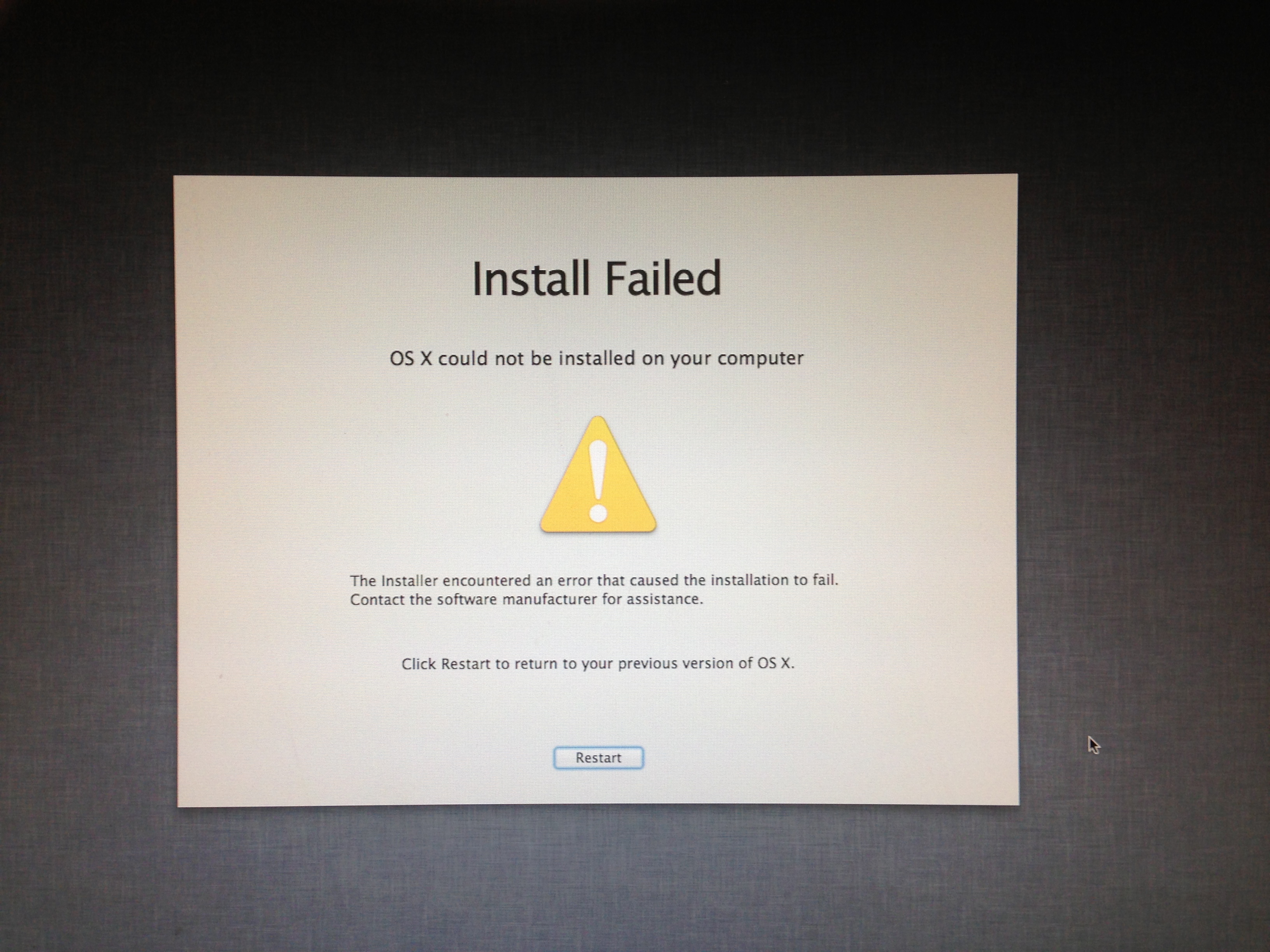

alternatively when trying to instal a fresh copy of OS X onto the drive it fails at the end with the following message being shown.
(some images attached as reference)
hope there are many forum viewers out there who may be able to provide a solution?

Curious how you first initialized and formatted the drive. Did you unbox, install drive, and use disk utility to format? If so, did you test read/write abilities as just a normal drive first?

Unbox, instal then used disk utility to partition & reformat to GPT and Extended Journaled format. not sure how to test read/write abilities but it is writeable as files are written on it.

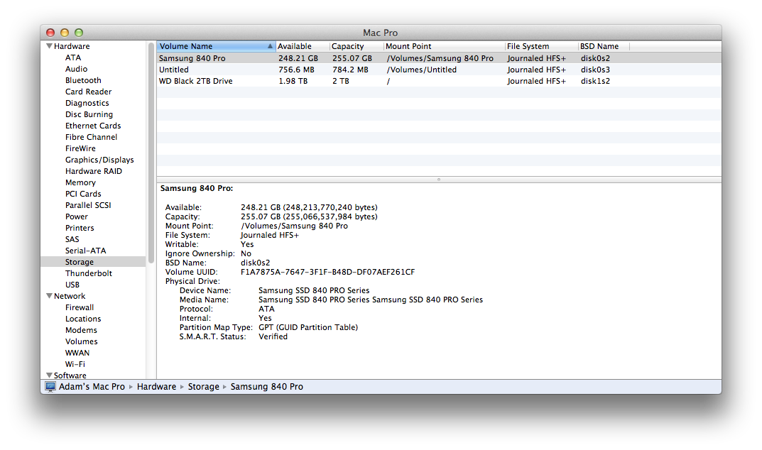

Hardware Issue solved
Hi All thanks for the input on this thread.
The items including a PCIe board are due to arrive end of this week over the interim I did plug the drive into one of the hard drive bay slots and..
Presto works like a charm.
Relieved that the Drive works fine as I had swapped it from a Vector OCZ drive after reading about hardware issues with those units.
thanks for everyone's thoughts and posts~!
Much appreciated
Sorry I didn't reply sooner - but yes - Mac OSX Installer dislikes (very much) attempting to install the OS on a disk that is mounted via a non-standard interface/connection.
