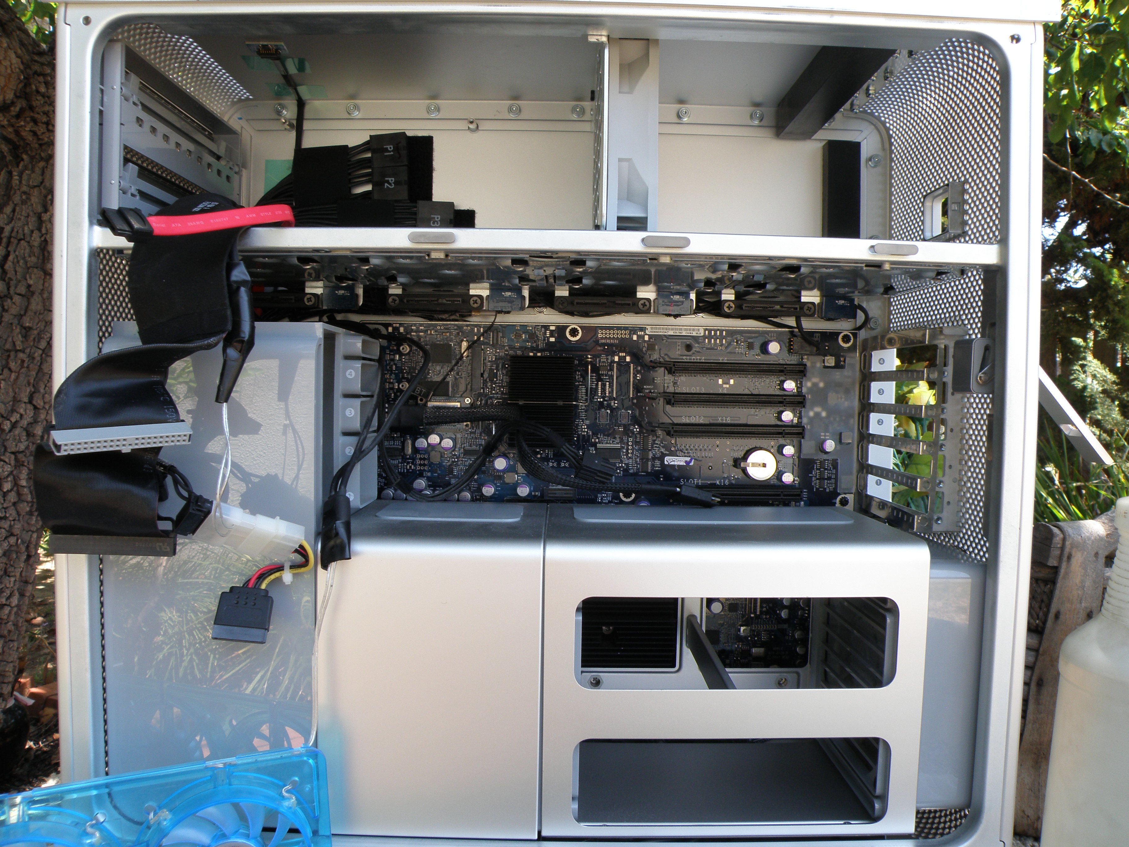

Agreed! I have very low temps and I clean it like this 1x a year. Every other month I just spray it out.
