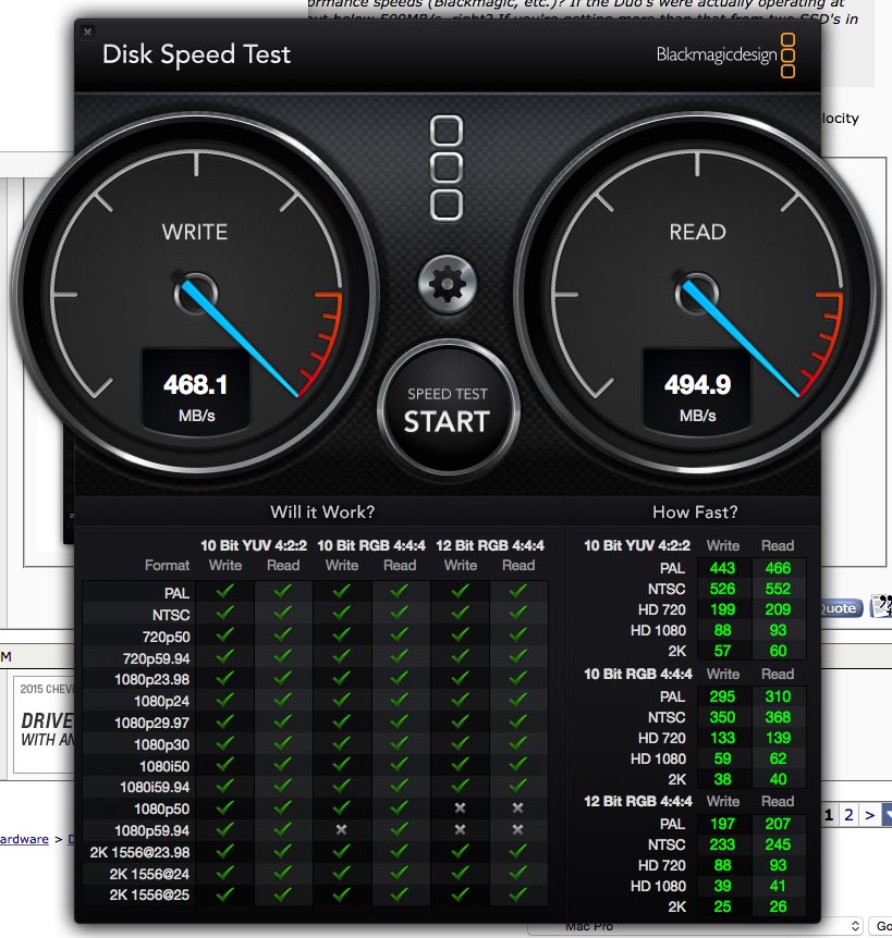

Hey all, I wanted to pick your brains on something I'm running into with my Mac Pro 3,1.
I have am running Yosemite on a 2008 Mac Pro. I have a Velocity duo card with 2 Samsung 850 Pro hard drives. I'm running them in RAID 0.
1. First of all, its not running nearly as fast as I expected.
2. I get a lag or hang up every time I wake up my computer.
3. Other hard drives in my mac pro seem to pause now, delay in accessing them, etc.
Generally it just feels sluggish compared to a single samsung pro 850 running on the Solo card.
Any thoughts or issues others had to overcome with this setup. I've searched around and it seems everyone has this setup working really well.

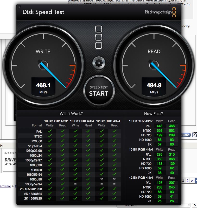

Note: I've attached a disk speed test screenshot. These test are ALL over the place. I never get consistent results, not sure if that matters - just a note.
The highest I ever got on write and read speeds is around 650MB/s.

the velocity duo card is a PCIe x1 card, and as such, you're going to have limited bandwidth. this speed is about what you can expect with an x1 card.
I have the Apricorn Velocity Duo x2
I should have been more specific. I'm not so worried about the max speed, etc.
The main issue is the pause on wake and the general sluggishness compared to a much slower solo card.
To clarify from the previous poster (vs. the OP): The Duo is an X2 card (two PCIe 2.0 lanes), not an X1 card. As such you ought to be seeing better results.
I have a very similar combination: A 3,1 with the Duo and two 850 Evos in RAID 0.
The Duo will always be limited to about 800 MB/s no matter what (probably a little less - high 700's). I get a very consistent 660-670 MB/s when it's in slot 1 or 2. That is similar to your "best" results.
You can go ahead and swap between slots 1 and 2, in case that helps (I doubt it, personally). Slots 3 and 4 get around 150 MB/s - don't even bother.
I have not seen much variability at all. It's always the same no matter what else is changed. Are your disks older or have they ever been even close to full? If so, TRIM may be the issue. As I understand things, this would affect writes but not reads. That's somewhat consistent with your attached image.
A delay on booting is due to the fact that the machine first looks at all "internal" disks before booting to an "external" PCIe drive. You won't be able to do anything about that, but my sense is that this is a minor issue if any. I haven't seen any special delay from a wake from sleep.
By the way, changing slots will cause the computer to ignore the Duo and actually boot from an internal drive, if any are bootable. You will then have to reselect the startup drive to be the Duo (it will be fine after that). This can cause some confusion until you are aware of it.

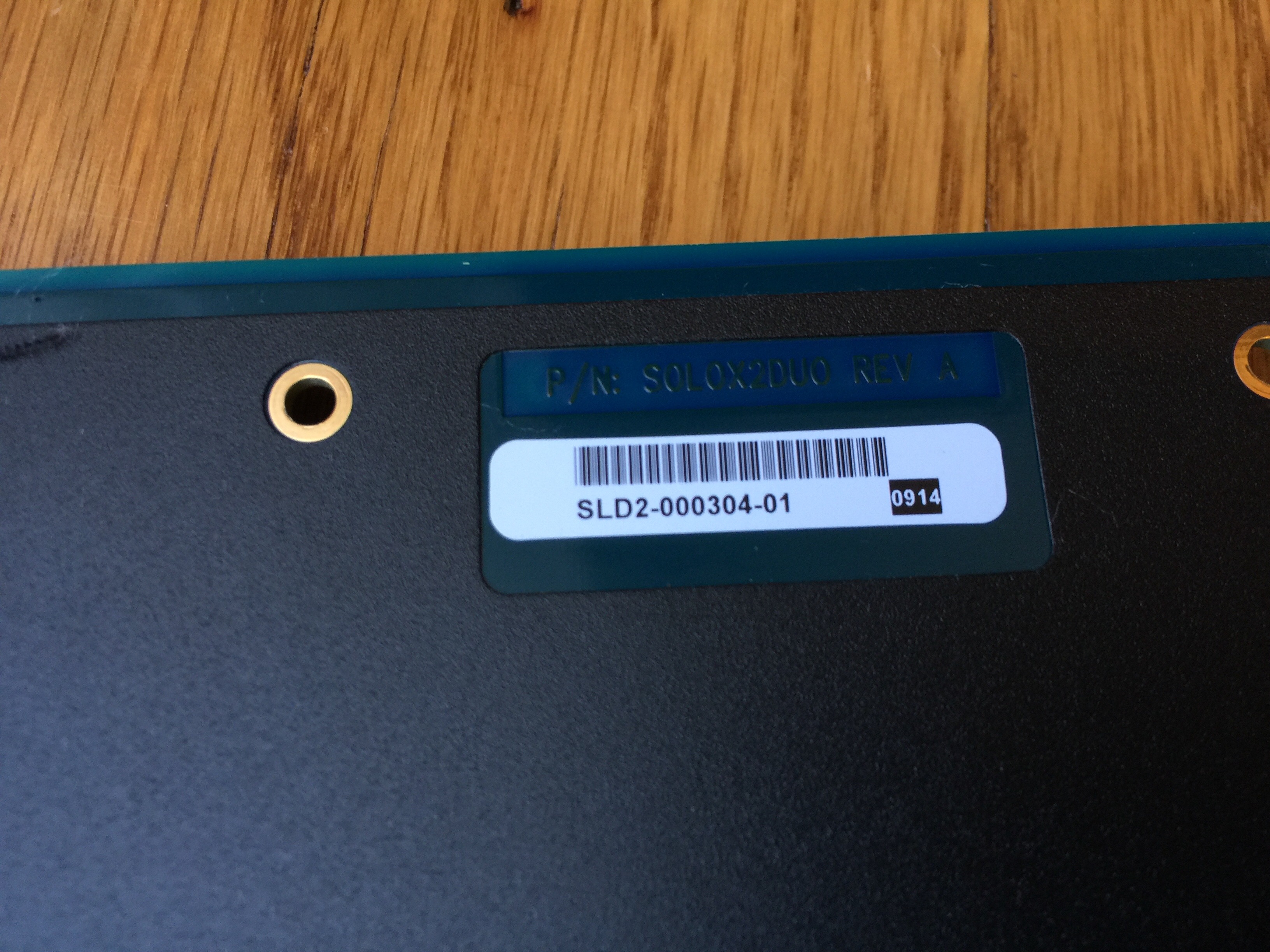

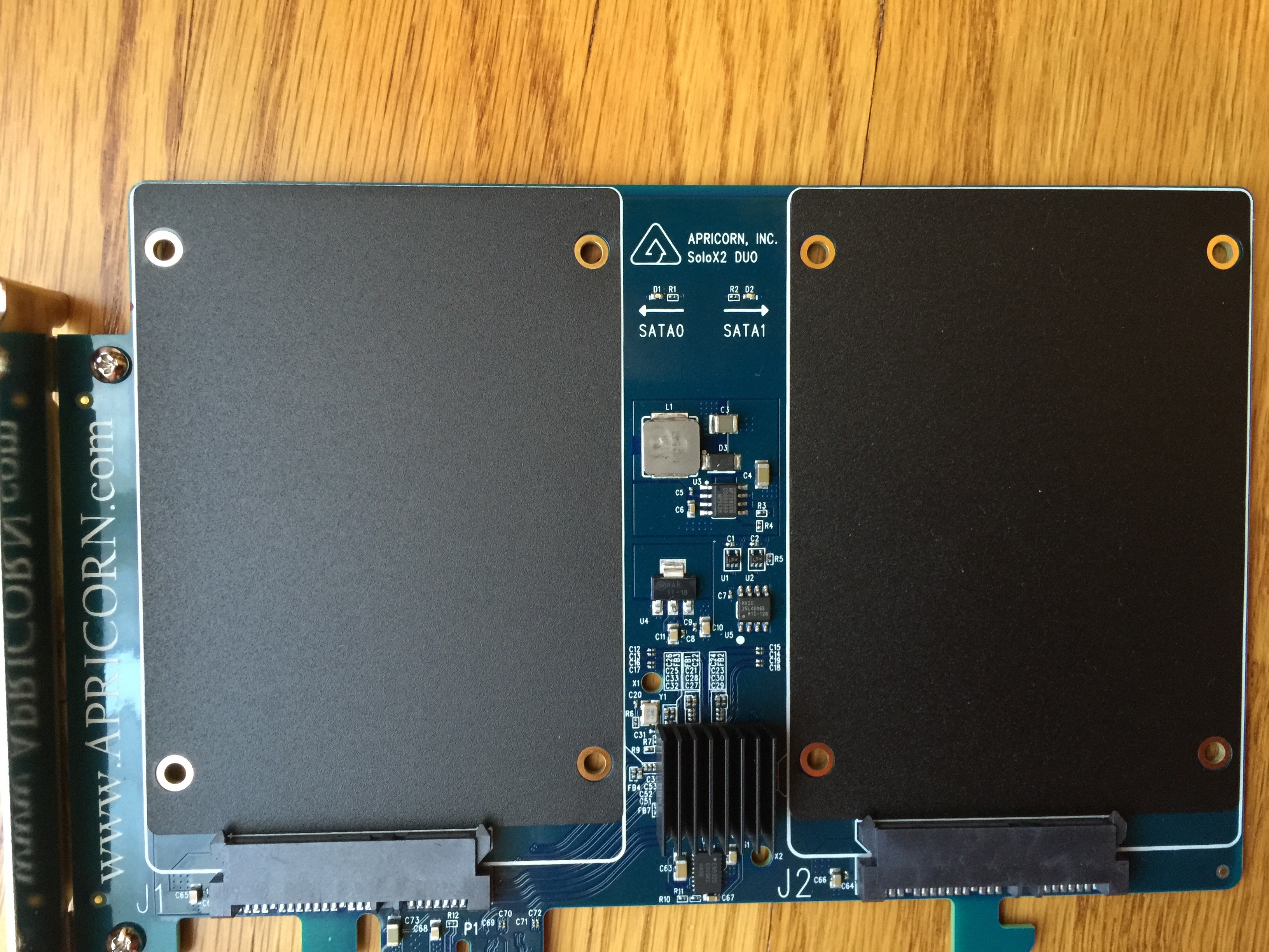

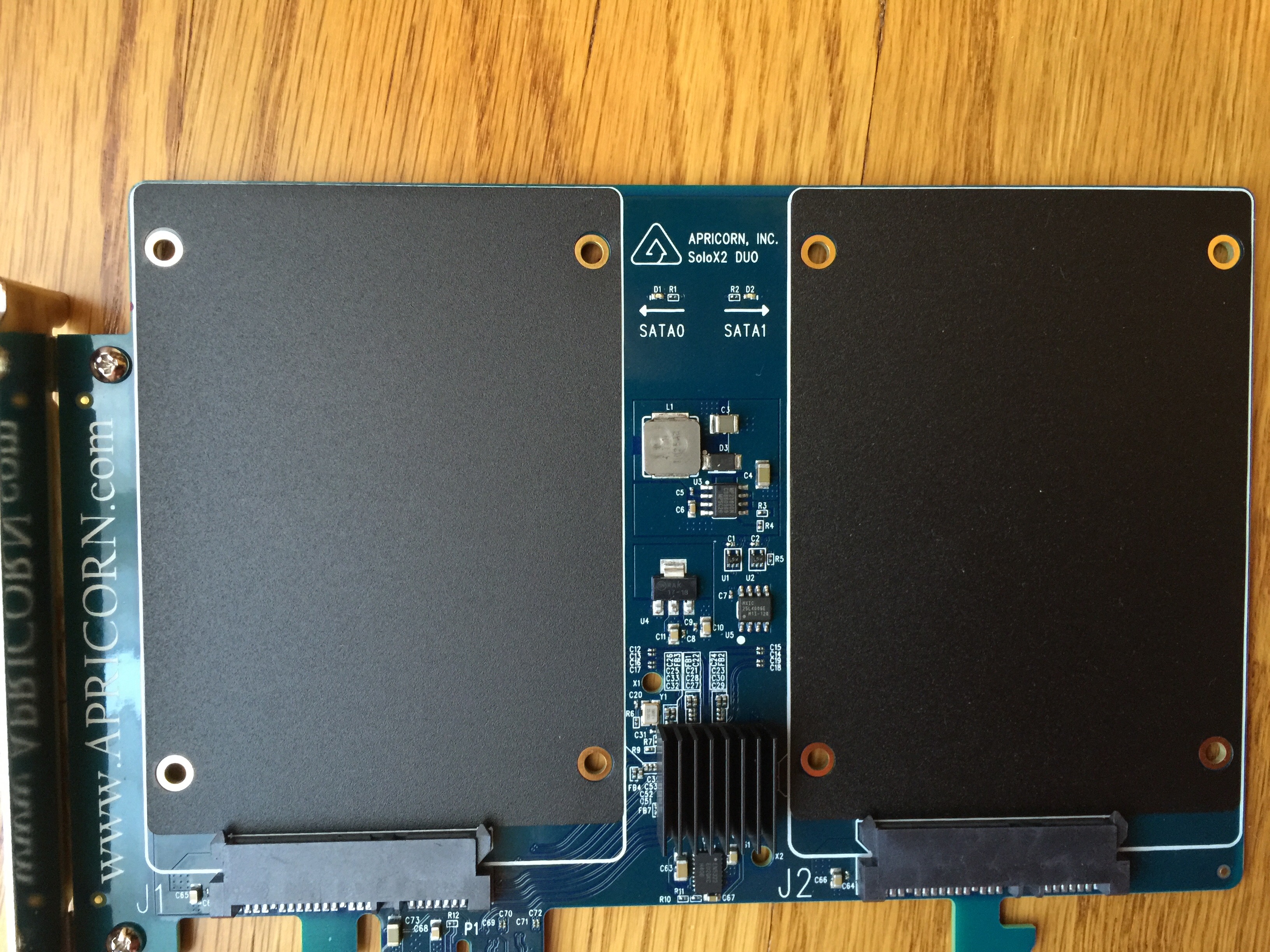

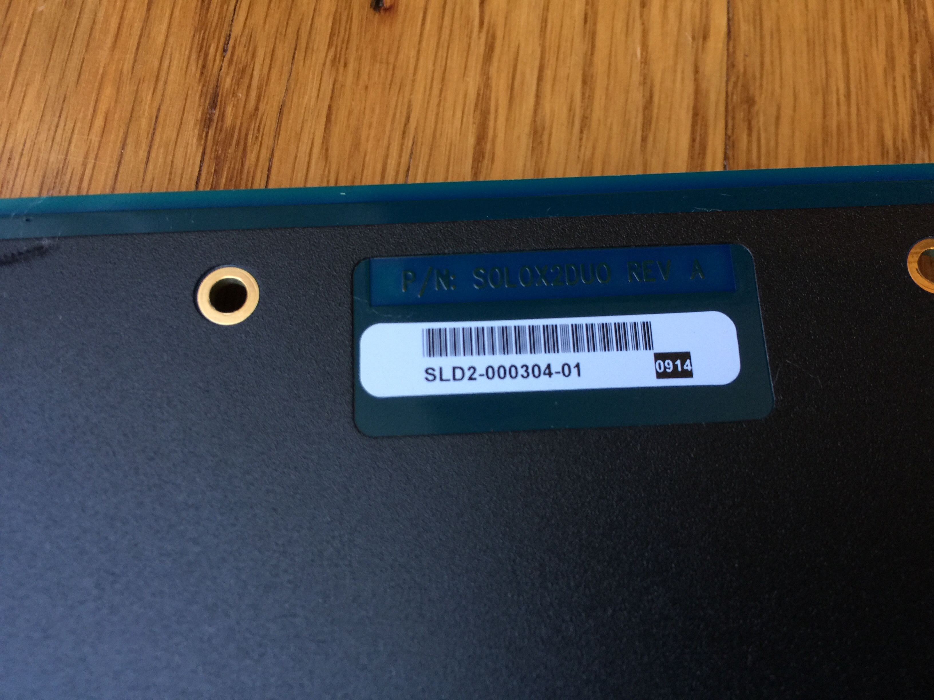

What card? Am I crazy?
Are there two Apricorn PCIe cards that hold dual ssd drives?
My packaging says one thing, my card says another. Not sure it matters but trying to eliminate problems with this card.

The Velocity Solo X2 supports 2 drives but only has a mounting caddy for 1. There is an SATA III data connector on the back of the card for the 2nd drive. You have to mount the 2nd drive and provide a power connection separately.
I guess I'm asking what is the difference between
Solox2 Duo and the Velocity Duo x2
My packaging reads Velocity Duo x2 and my card that came in that package says Solo x2 Duo.
Is that right? Doesn't seem so.

Well, it's the same thing. They probably hadn't settled on the exact marketing name when the PCB was produced. There actually isn't a Solo x2 Duo (officially speaking). I'm sure it was a name that was being considered, but then they realized the contradiction of terms, and the confusion it would cause (hence, your confusion).
There is a Velocity Solo x2
There is a Velocity Duo x2
They have different Marvell controllers. I'm guessing that the early production runs of the Duo were done with stock originally intended for the Solo x2 card. It's just silk screening that means nothing. The packaging is correct if you have a card that provides two mounting provisions for SSDs.
I have two Duos. As far as the marking goes, I just checked mine, and it's the same as yours? Never noticed it before. I'm sure it's just a silk screening error.

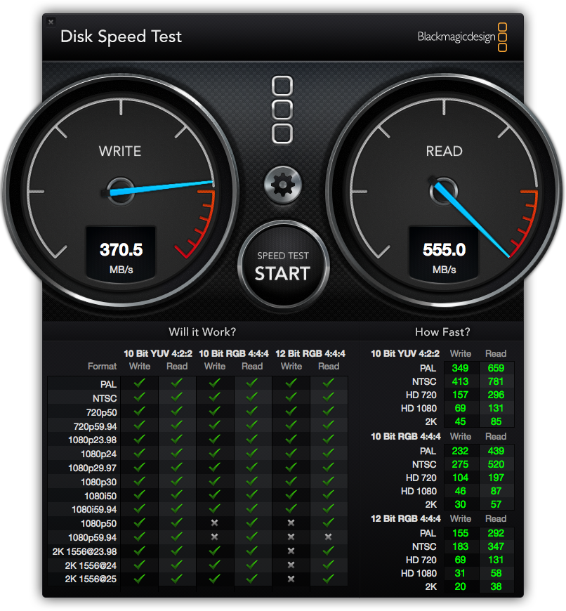

I have mine in a 5,1 Mac Pro - Slots 2 and 3 - Not in a raid configuration. My boot drive is on the card in slot 3. The boot drive is an 840 Pro. Speed is attached.
