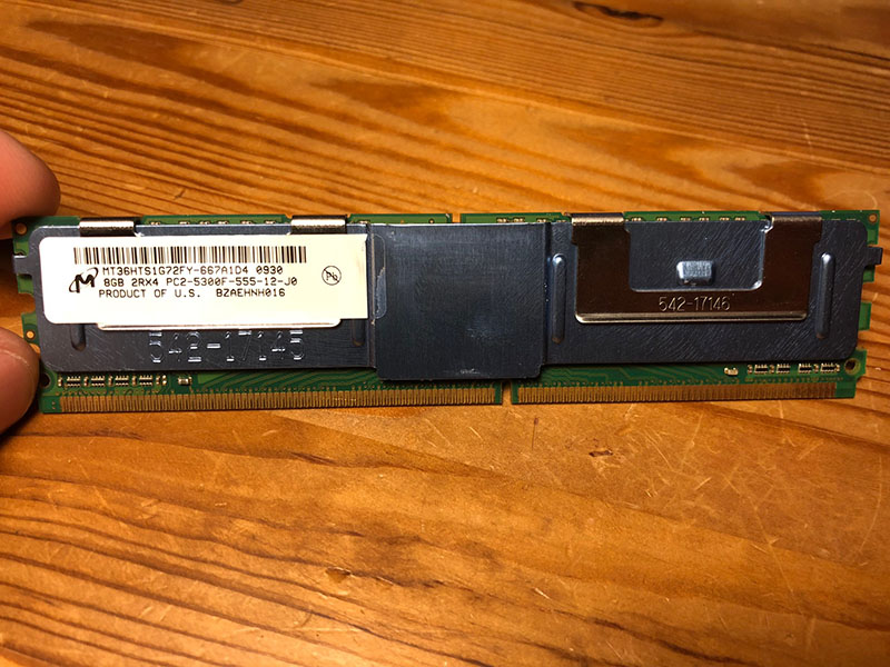

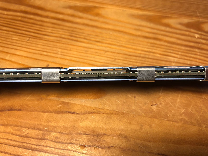

Hardware Monitor says that Riser B's four 667 MHz modules are at 73-79C.
On Riser A I have two 667 MHz modules which also are at 77-78C but the two 4GB 800 MHz modules are at a more reasonable 54-55C.
1. Has anyone else noticed increased fan speeds with server RAM installed?
2. Do they 667 MHz sticks look like they've got insufficient heat sinks?
3. Is it a question of not enough thermal paste? If so where - here in Europe - might I find that and how do I apply that?
I'm considering to return them and hope for a better set from Mr Memory but would appreciate your thoughts before I do because I've never run the system with this amount of RAM before.

FB-DIMMS are hot. My fully populated Mac Pro ranges from 57 to 71C average over all 8 slots. They all have the Apple heatsinks on them though.

You need better heatsinks. Those won't work well under pressure with the way the 08 moves air. They may work OK in the xserve due to the different thermal profile of the 1U server.
I'd get real FBDIMMS made for the Mac pro that are 800mhz.

Replace them right away as long they are still working! I've used to have such modules as they were very cheap, but 4 out 8 failed in the first year, because of overheating.

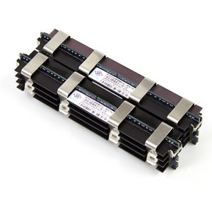

You need modules like this:
I recommend you return them and pick up memory with the appropriate heatsinks (as shown in Spacedusts post). You can use the Mac Pro 1,1's 667MHz modules if you do not want to pay for the Mac Pro 3,1's 800 modules.

Had the same issues on my Mac Pro 1.1. Memory worked, but the fans were always running more than needed and the temps were high.
Eventually ordered the correct ones as per photo above from eBay and it's been quiet and cool since then.

I did for the 8GB x 8 667Mhz server-grade Crucial sticks I bought for my 3,1 although I am only using 56GB with High Sierra - see link in my sig for reason. I procured the cheapest Apple FB-DIMMS sticks from ebay, $10 I think, as well as thermal tape and replaced all of them with ease. You can also use thermal compound but the process is messy as I tried it and ended up using tape instead.
