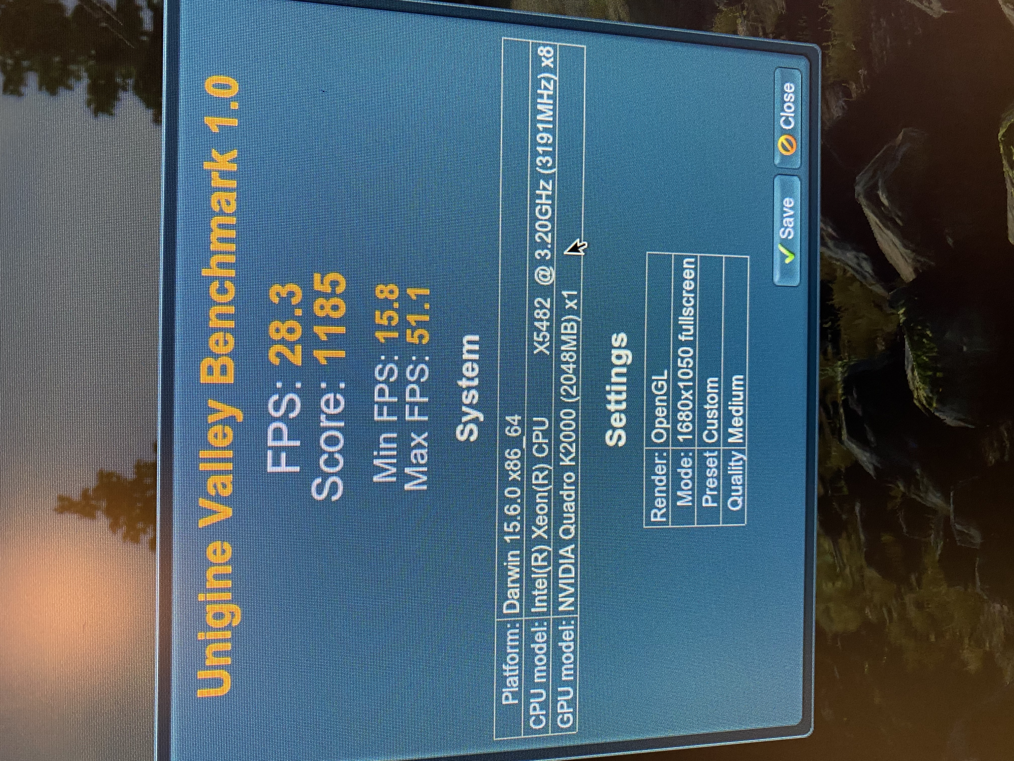

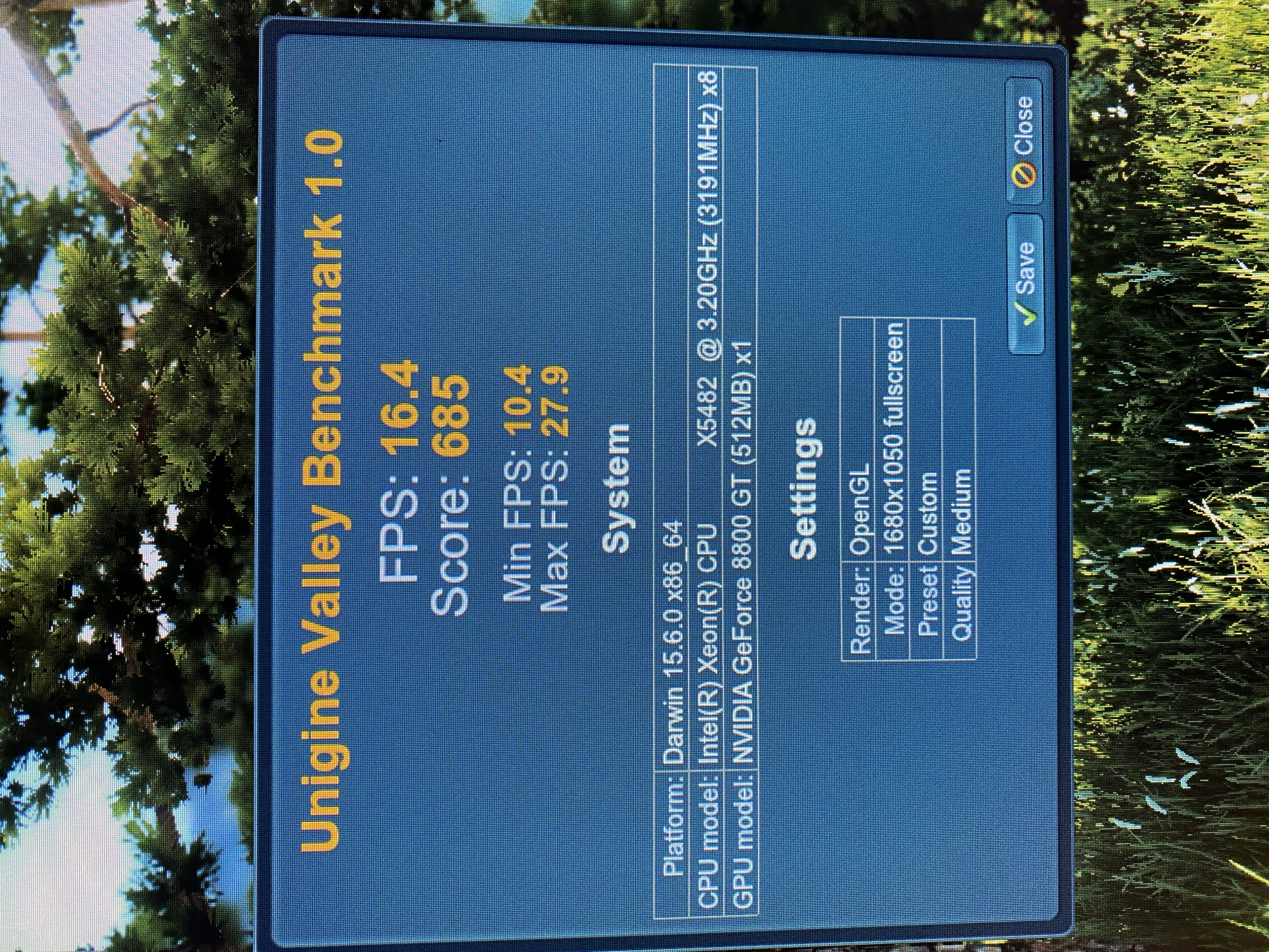

So I have an answer finally! I had time to run a time demo using the Engine Valley Benchmark to compare the graphics cards with each other. So in Mac OS El Capitain the Quadro K2000 was quite an upgrade to the Geforce 8800GT with a much higher frame rate and also 2048 MB of ram versus the 512 MB of the Geforce.
Not too bad for a free video card that was heading for the recycle bin and was pulled out of an old PC!
See attached photos for benchmark results....not sure why they are sideways here....
