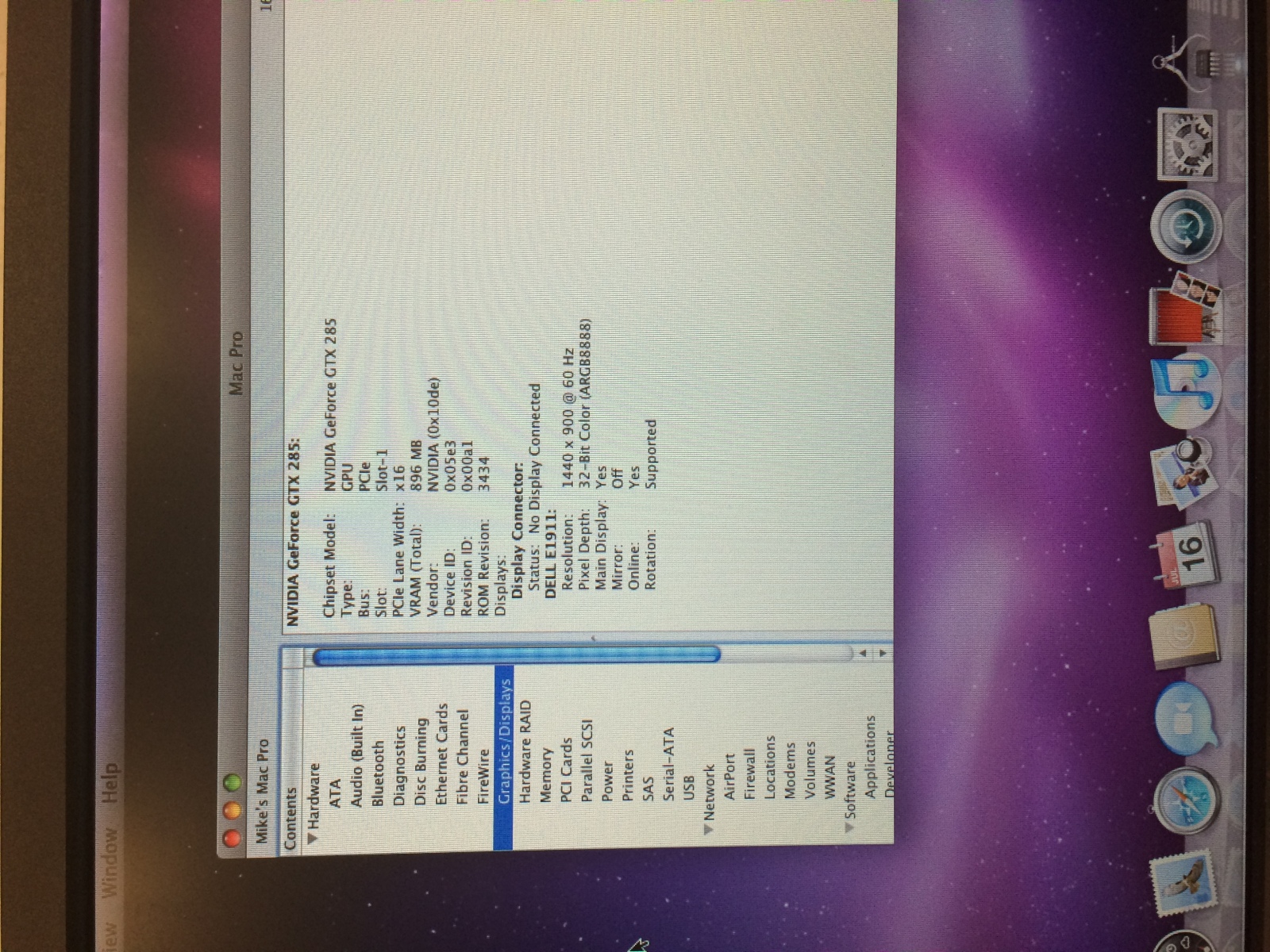

Downloading the drivers didn't help. As they would only install on 10.6.8. But i can't boot into 10.6.8 to try it. 🙁
From System Information
UPDATE: Put a nVIDIA GT 610 in the machine, Booted Mavericks install and it works flawlessly!
I think the issue is that someone less well informed flashed the card.
The giveaway is the 896 Megs of RAM.
Real Apple 285s have 1GB.
Some of our competition resorted to trickery to make money.
Looks like they put a GTX285 rom on a GTX260 or GTX275. Likely it just needs clocks and power reduced, or perhaps is just bad.
