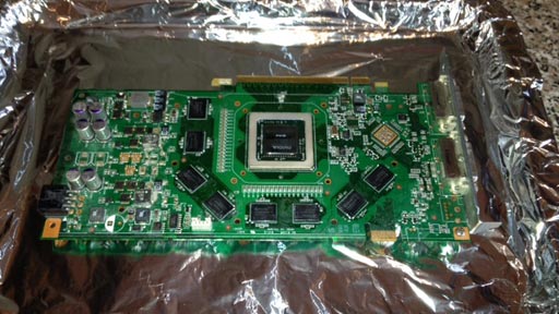

More tips for the Betty Crockers in the audience:
1. Set a timer. I do 9 minutes at 375-400 F. If you forget and let them go too long, the components on the backside of card start falling off like rain. Then it is landfill time. Also, the caps on the front will start popping like evil, stinky firecrackers. They will continue spurting out nasty goo for a few moments.
2. Either wear a gas mask or make a point to NOT BREATHE while pulling from oven. The smell being awful is a good sign that you shouldn't breathe it in. I hold my breath, pull the sheet it is on and gingerly place under the hood on the range. Run the fan and leave room. NOW you can breathe again. Let all the nasties out gas for awhile.
3. BE EXTREMELY careful during disassembly and reassembly phases. It is crucial to lay the fan perfectly flat on a table top but LET THE BRACKET HANG OVER THE EDGE. Otherwise you are flexing the card with each push on screwdriver. The whole issue is with fragile solder joints between the square metal GPU chip and the hundreds of little solder balls linking it to the PCB. The PCB can bend, the GPU is more rigid. So any flex between them can easily re-fracture the same solder balls that you just fixed.
4. As a general rule, cards that show screen artifacts have a good (50-75%) chance of resurrection. Cards that don't boot at all are FAR less likely to make a recovery (10%)
When 8800GTs were in demand we ended up with at least 100 that died in our possession. I would wait until we had at least 10 or 12 before we had a "baking day". We usually had about 50% come back to life. If they didn't come back after 2 bakings, they weren't coming back. It is an awesome feeling to bring a "garbage" card back into the land of the living.
BTW, 7300GTs can also respond to this. But be sure it isn't the "bulging capacitor" issue as those don't get helped by baking.

I'm not surprised choking on a dozen of them lol.
Washing and blowing air to remove debris carefully pre bake cuts down the smell.
Cracking the oven half open and leaving them for 60-90 mins to let them thoroughly cool undisturbed full stop. Advice from a mate who's probably done more solder work than this whole forum that I've heeded and seems to work.
Place card on chopping board topped with anti static sponge to reassemble.
The perfect kitchen computer repair methinks and not when the missus and kids are around :D
