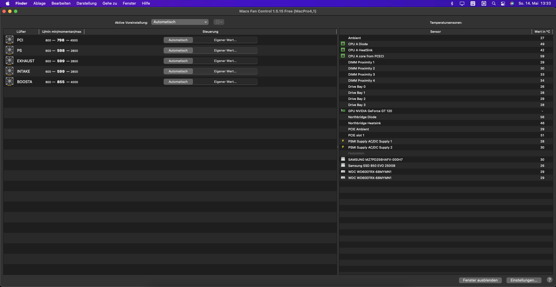

Check the temperatures with a tool like MacsFanControl. Especially Northbridge temperature and the delta between Northbridge die und heatsink. Post a complete screenshot of the tool.

Hello, thank you very much for your feedback!
Attached is the screenshot, hope it is the right one.

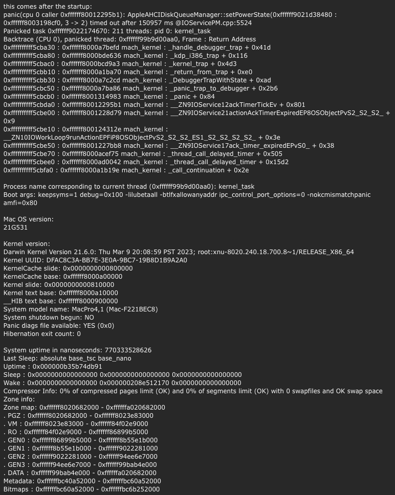

I also noticed that the Mac Pro at startup displays the message:
Your Computer restarted because of a problem. Press a Key or wait a few seconds to continue starting up.

this comes after the startup

For 2009 cMP, if you want to run Monterey, you better have at least two hardware upgrade.
1) CPU, the W3520 is known to have audio issue in newer macOS. You better upgrade it to something like W3690. If budget limiting, X5677 is a good choice.
2) GPU, in fact, you don't even need OCLP to patch anything, just get a low cost RX460, then you can run Monterey via OpenCore without any system file patching.
However, the above assume that you don't need wifi (I believe most 4,1 has no wifi card indeed). BT should work with some tricks in OpenCore, but if you need that, and can't make it work. The worst case is just to buy a USB BT dongle, then problem fixed. If you need native wifi / BT support for whatever reason, you should also upgrade the Wifi / BT card.
Once you have the hardware ready, you can flash your cMP from 4,1 to 5,1, then you can install all the hardware. And you can now use OpenCore to run Monterey without any system file patching.
In my own experience, this kind of setup is very stable.
