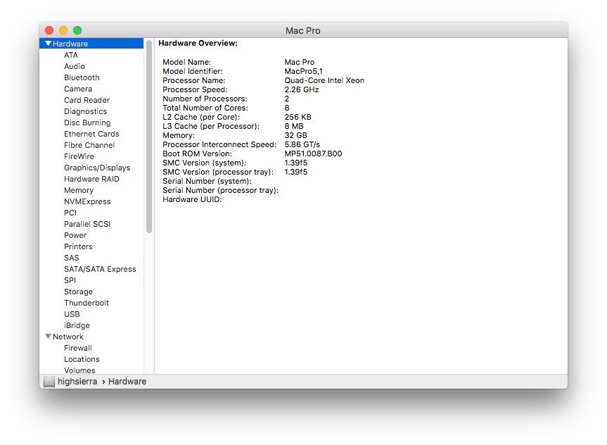

I installed the two new CPUs and booted up the system. I got the startup chime, but this was the one and only time I got the chime with both new CPUs in, and also the only time the CPU in slot A showed any signs of life. I saw the Apple logo and progress bar for a few seconds, but it froze and wouldn't progress further. I did a hard shutdown, removed some PCIe cards and external peripherals, and attempted to boot the machine again. I got most of the startup indicators (power light, fans, hard drive spinning), but no chime and no boot up (also no CPU fault lights). As I was trying different things, I switched the processor in slot B into slot A and left slot B empty, and the machine did boot up a few times this way and showed the correct processor information, but I couldn't get the two processors to work together again. As I kept re-seating the processors and adjusting the heatsinks, I eventually saw the CPU 1 fault light (with the "good" CPU in it), and then the good processor never worked again.

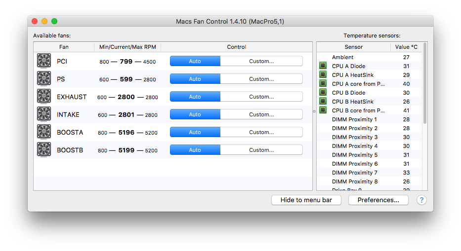

I tried several times switching one or both of my old processors back in, and they worked every time. Ultimately I left the old processors in the machine and started using it again, and everything seems fine except an odd new issue where if you reboot the machine a few times (not a cold start), a few of the fans will go up to and stay at maximum speed, even though the CPUs are not hot... odd...
