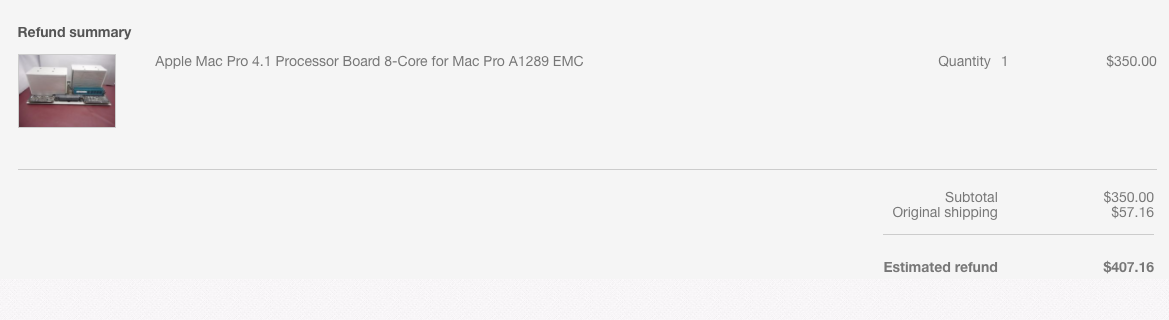

hi guys thanks for those replies.. really set me down on this.. below is the ebay item page
http://www.ebay.com.my/itm/142184632139?_trksid=p2057872.m2749.l2649&ssPageName=STRK:MEBIDX:IT
i do no see any return terms on restocking fee or shipping fee.. what should i do
[doublepost=1481162627][/doublepost]just checking on the refund section, i should get back this figure - shipping cost to return it.
