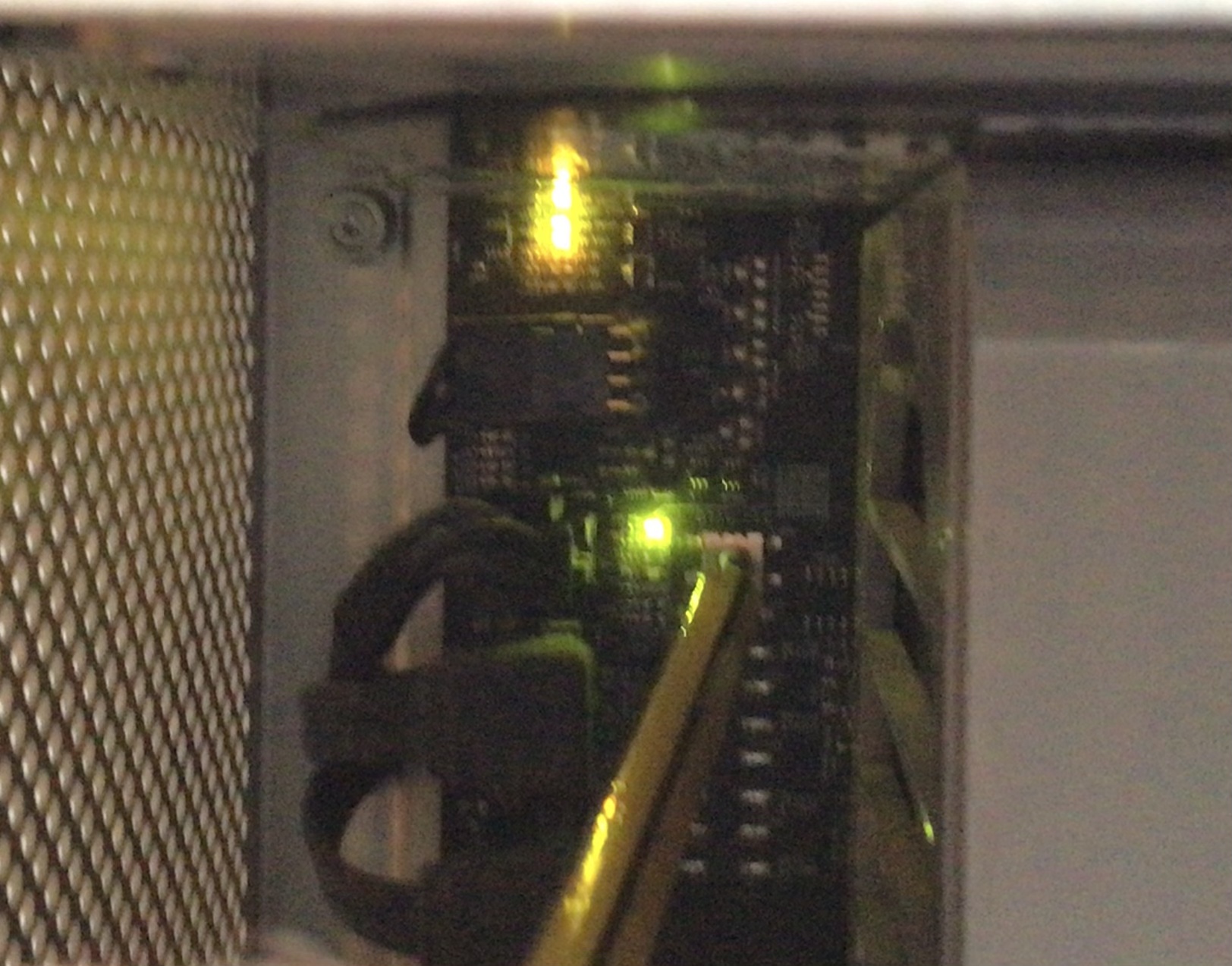

THX for answering. this is what I get pressing the DIAG button.
•PSU PWROK
•5V STBY
•SYS PG (next to the DIAG button to the left)
By the way first when I realized the problems with the DIMMs (1,5,7) and opened System Information there was no error message just Slot empty

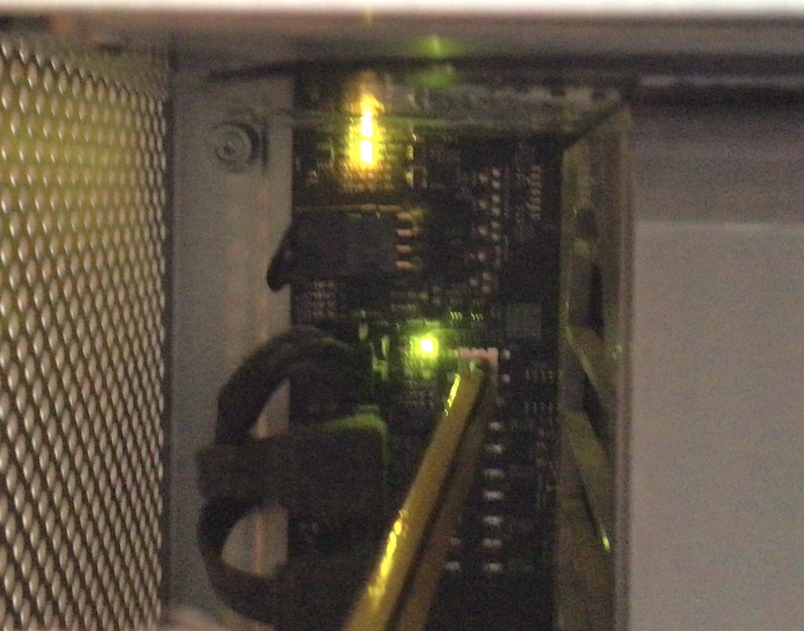

•PSU PWROK
•5V STBY
EFI_DONE is off, so you could have a brick or worse, a dead backplane. If you have access to another MP4,1 or MP5,1 I'd test PSU + CPU tray before buying or doing anything.
