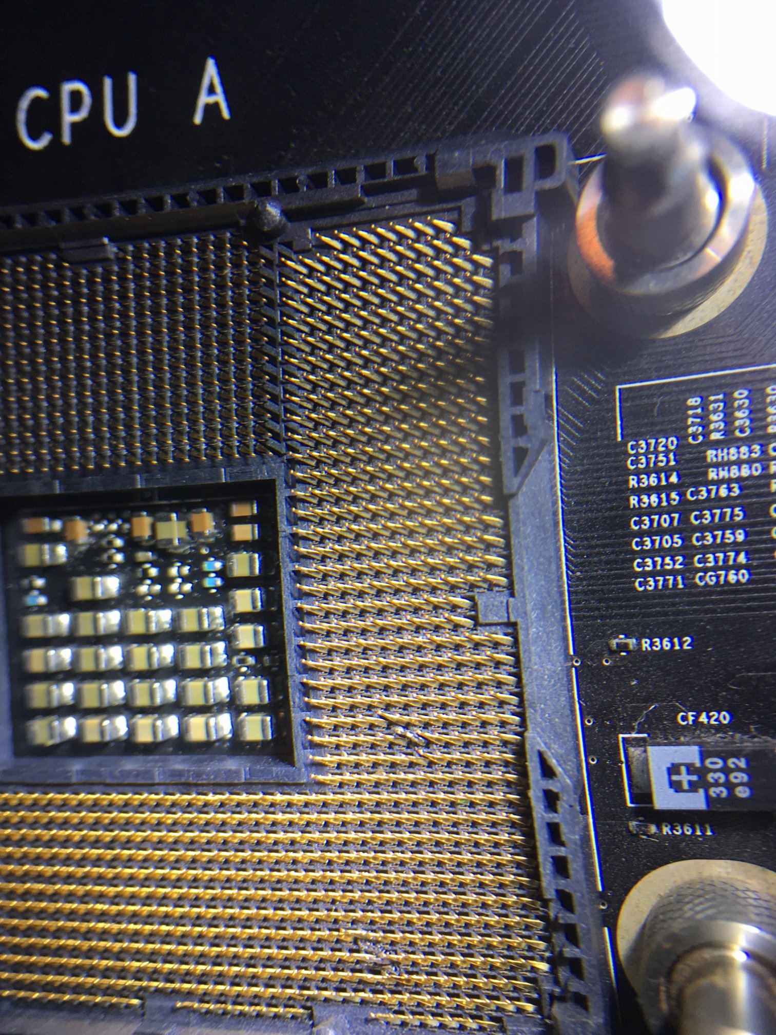

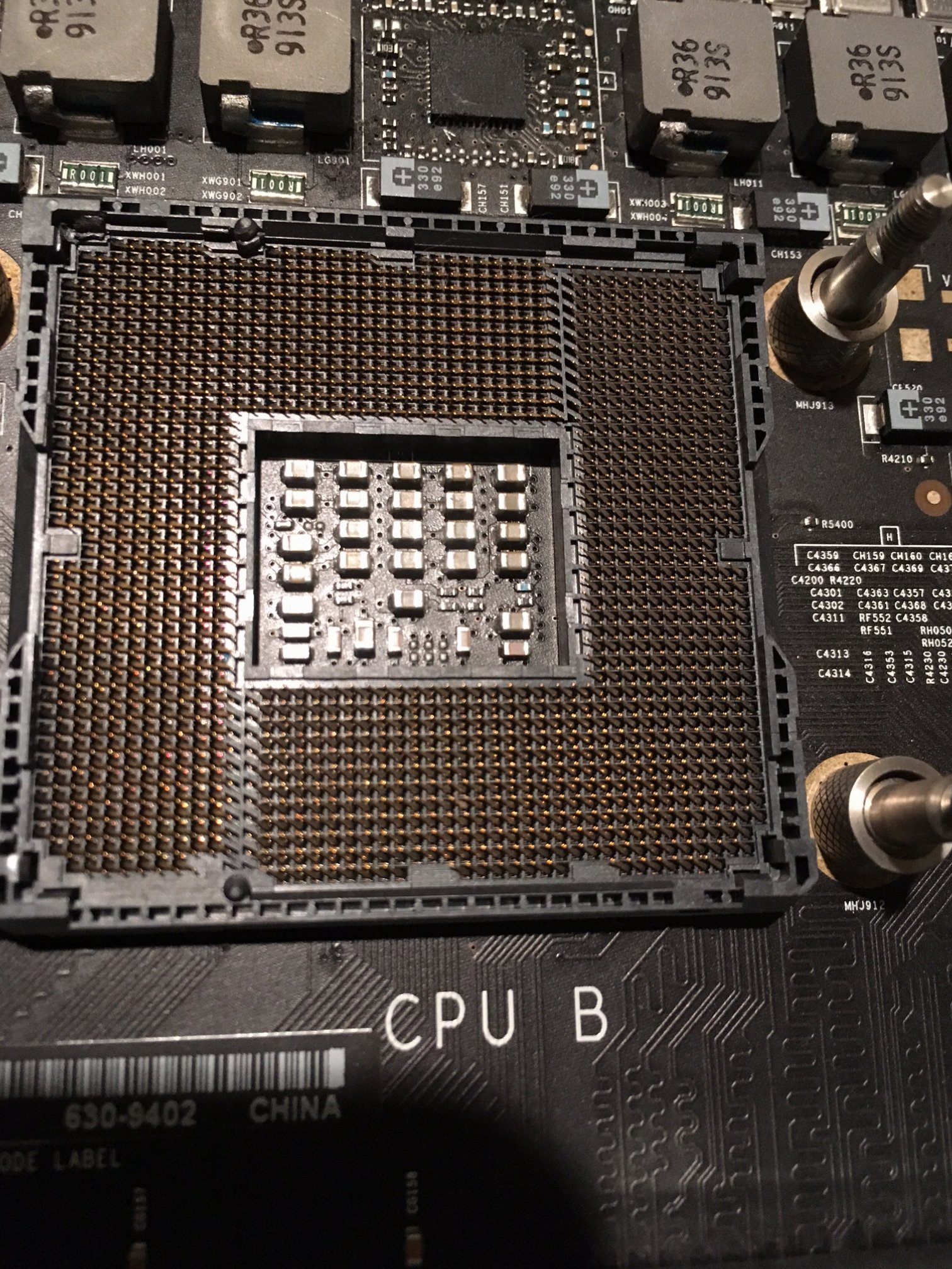

Well, Goddamn it, i took apart the board and here is what I found under the CPU'S (see attached images
AS you can see some of the pins are bent of both cpu's....
Now, the machine was running, but i am not sure if these bent pins would be the cause of the issue with the lights.
Any idea guys?
That looks exactly like the damage that Anandtech did when they replaced their stock lidless CPUs with lidded CPUs and over-tightened the heat sink:
http://www.anandtech.com/show/2800/upgrading-and-analyzing-apple-s-nehalem-mac-pro/11
Somebody botched a CPU upgrade job and the damaged goods have ended up in your hands.

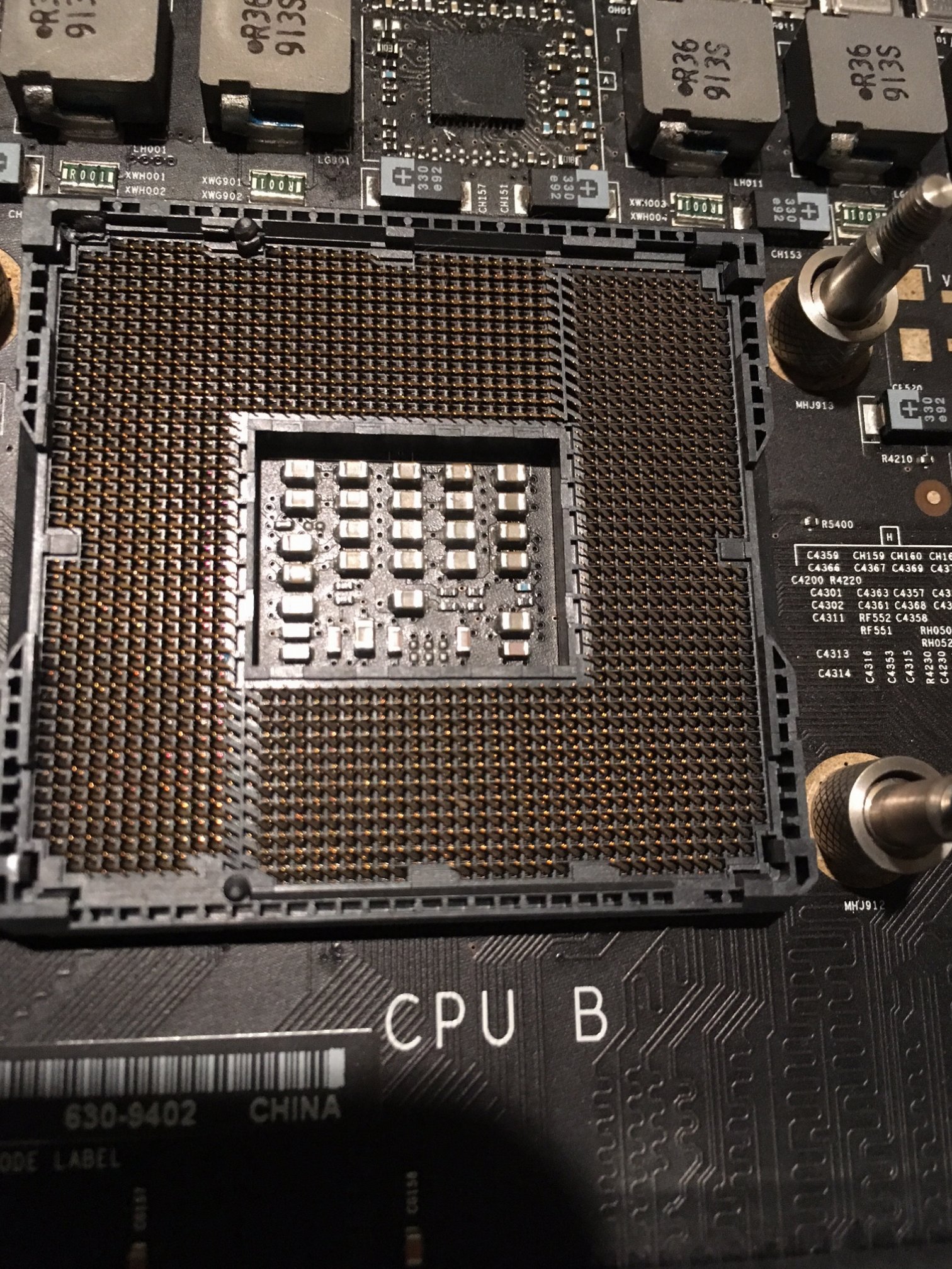

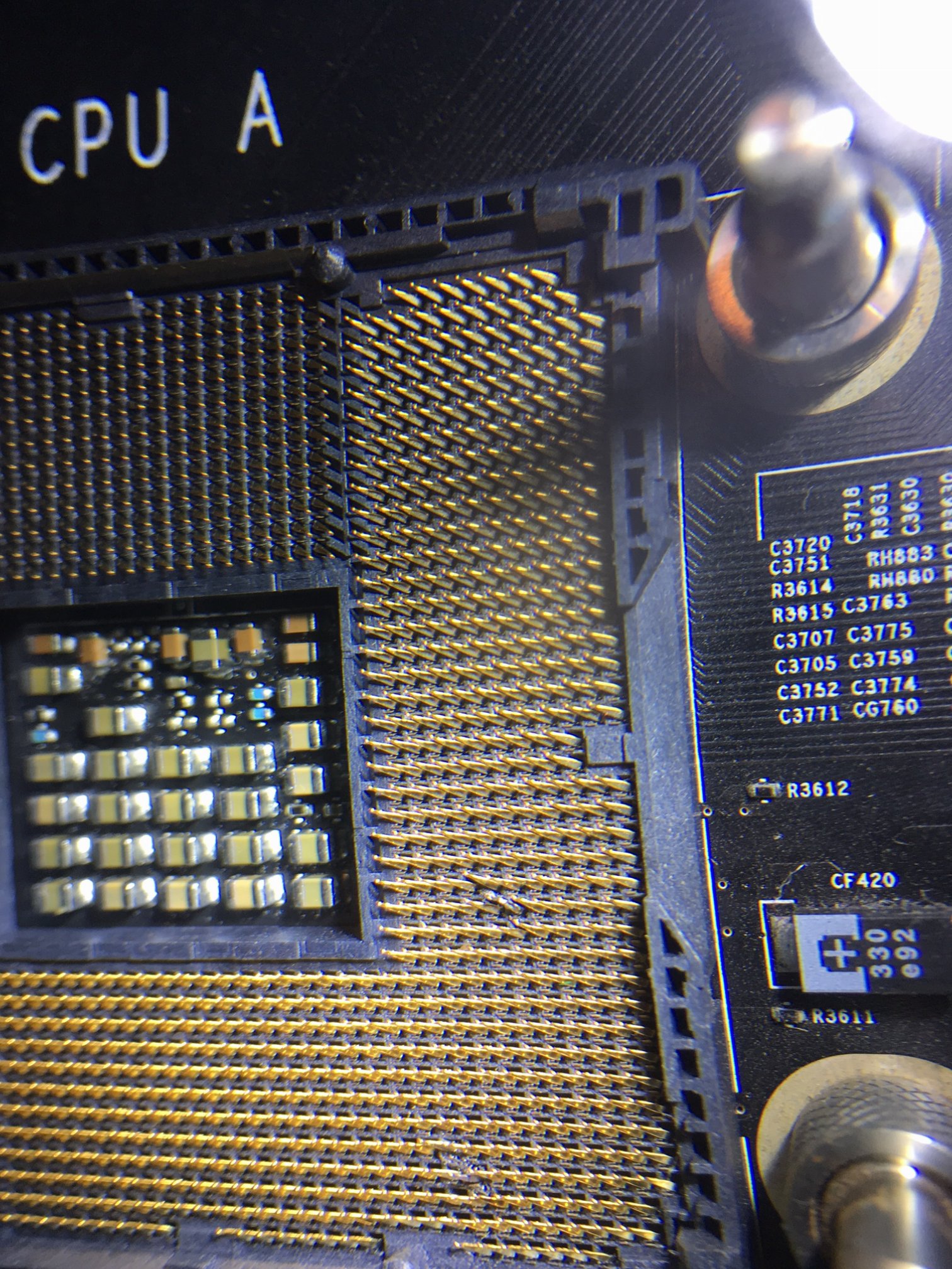

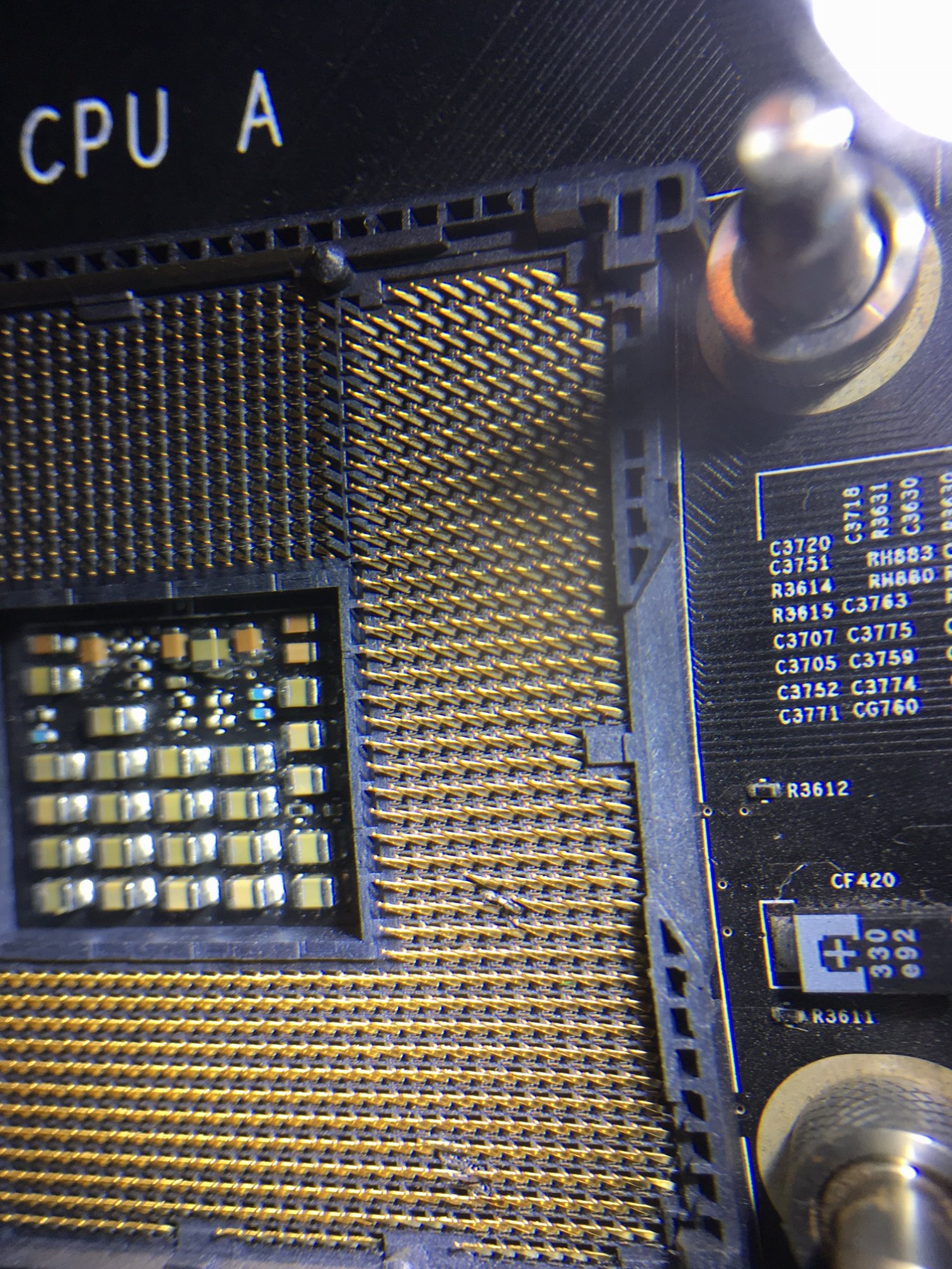

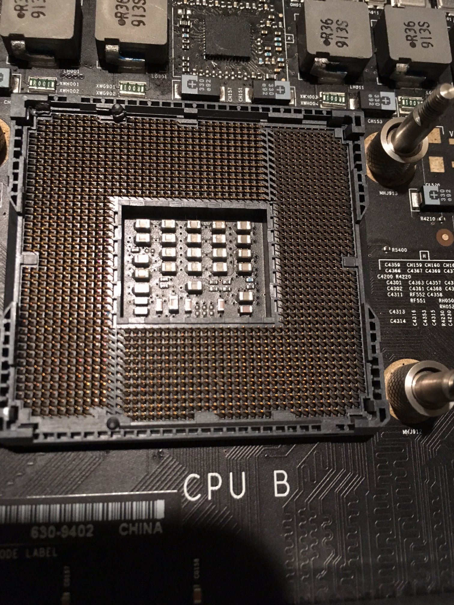

Well, Goddamn it, i took apart the board and here is what I found under the CPU'S (see attached imagesView attachment 644047 View attachment 644048
Any idea guys?
It pains me to see this! Cleary the guy that performed the upgrade had no idea what he was doing. I feel for you!
Now, this guy did tell me that he did the de-lidding of the cpu himself (IHS removal) but did not tell me that the tray was not the original and that he had bought it from someone else, my bad for buying something of off craigslist (price was just too good) so I Am not sure what could be really wrong with it.
As the same guy also delidded the CPU's you have no guarantee that they could still work as he might have botched that job as well! This part of your post could be the silver lining though. You said that he replaced the original CPU tray. If so there is a real chance you can still get that one back from him. The CPU sockets might still be intact. If he does not want to give it back you can file a police report for stolen goods.
I hope this helps you out! Please keep us posted on the progress and I hope it gets solved!
Feel free to contact me if you have any questions.
