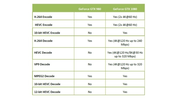

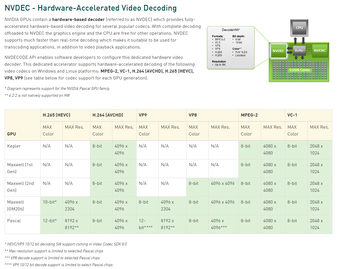

However the GTX 10x0 cards are more future-proof because of DisplayPort 1.4 (9xx cards have DP 1.2), and better HEVC support. For 4K UHD BluRay you need at least 3 GB of VRAM and HDCP 2.2.

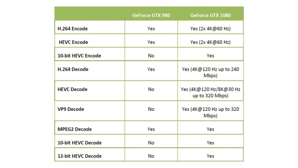

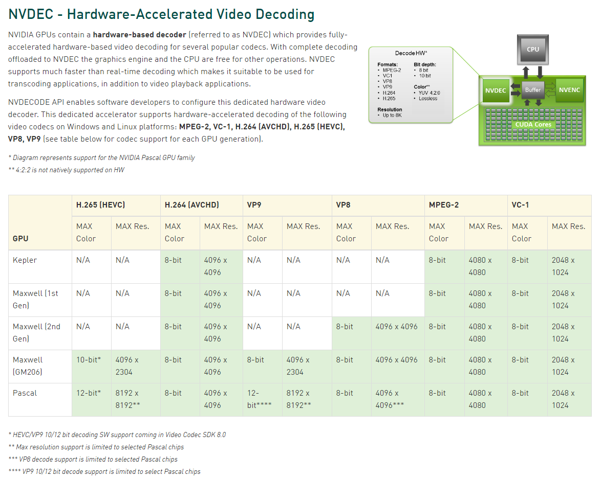

GTX 970 and GTX 980 have no HEVC hardware decode acceleration, though GTX 960 and GTX 950 (GM206) do.

From memory, 960 also support HEVC hardware decode. Therefore, for media content, 960 should be better than 980Ti. 980Ti has better compute / 3D performance, but not media support.

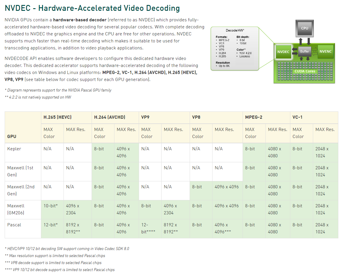

Yes, GTX 950 (Ti) and GTX 960 were the last Generation of Maxwell GPU's supporting HEVC decode acceleration: https://forums.macrumors.com/threads/mac-pro-4-1-gpu-upgrade-for-4k-uhdtv.2049842/#post-24668657
No OS X upgrade needed. Maxwell GPU's are supported in OS X Yosemity and newer, working of course only with the Nvidia web driver.

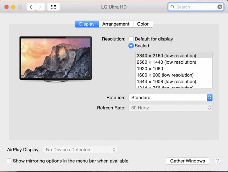

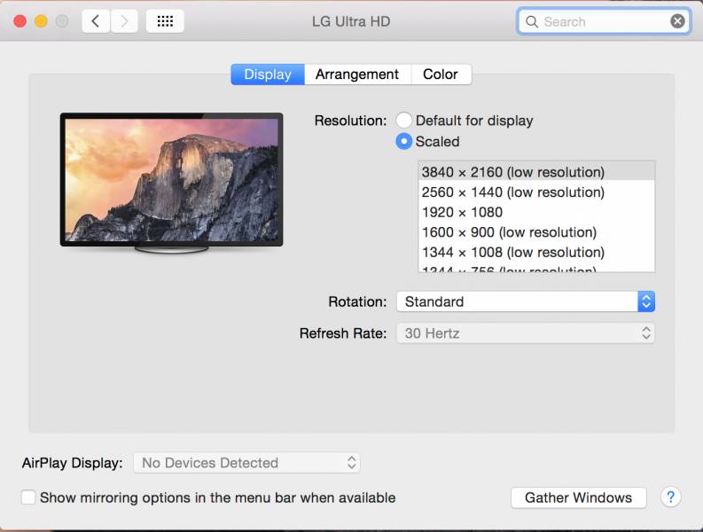

I installed the GTX 960 ACX+FTW today and the 1080p material looks great. But my TV and system profiler still shows that that display resolution is 1080p instead of 4K. Its using the HDMI port with HDMI 2.0 cable. I have a Displayport adapter coming, but is the HDMI the reason its only 1080p? Ive installed both of NVIDIA''s (via MVCs site) and CUDA drivers (via NVIDIA).
I also read that the 960 comes with its GPU acceleration disabled. How do i enable it? Are there other ways or settings to make the GPU put out 4K?
Hold the Alt-Key when you select a resolution and you get all resolutions:
If that doesn't work use SwitchResX.
If you installed the Nvidia web driver, and you can play 1080p footage, acceleration is probably on.
