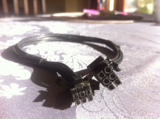

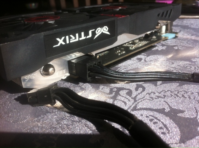

Any help would be appreciated, I got the mini-6 pin power connector, as bladerunner suggested, but my Asus gtx960 strix is not working, my mac pro 3.1 starts, light is on, but everything is silent, nothing going to the screen. Is there anything else I am missing? I don't think its getting enough power.
So first of all, is this the correct power cable, and secondly, can anybody send a link to the correct web drivers for Mac pro 3.1 running Yosemite, my current web driver is 346.01.03f01. I have attached pics of the power cable.
Thank you in advance.

power cable is correct and drivers are correct!
you could try to start your mac with both installed gtx960 AND the original GT120 and try to reinstall drivers?
have you selected the Nvidia web driver before restart? have you installed CUDA?
Hi Socket, thank you for the reply, I have tried to start it up with both cards, however, only my original 8800gt is recognised. I have tried the 16x and 4x slot, nothing.
Alright, maybe I can uninstall and reinstall drivers. I'll do it now.
After you've installed the driver, you need to go into system preferences and tell OS X to use them instead of the OS X Default Graphic Driver.
