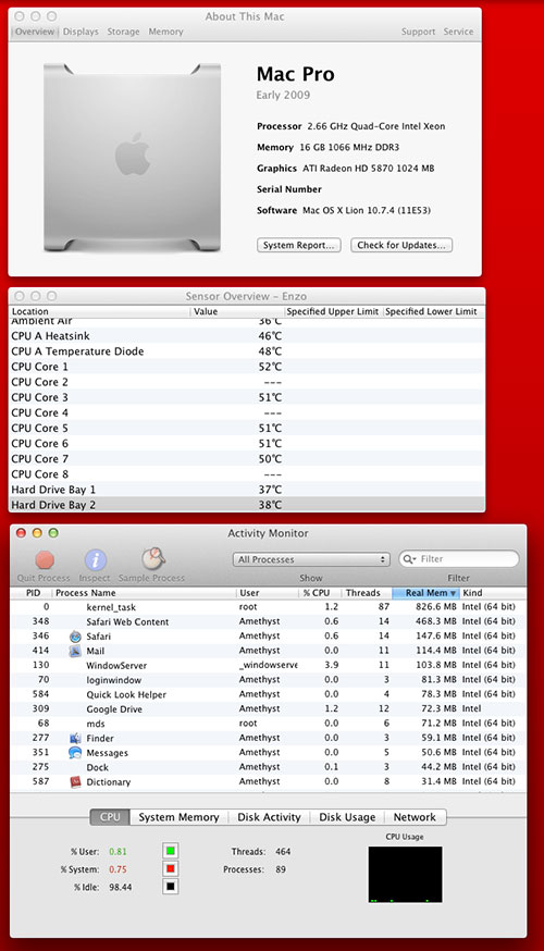

After bought 4,1 (Mod to 5,1) for 2 weeks without problems.
I've found idle temp on my 4,1 is very hot!!
Around 51c on all core so i'm very frustrate.
Is it normal?

It's quite normal. Your Mac is not overheating. The Intel processors used in Macs are designed to automatically shut down to prevent damage if they truly overheat. CPU Tjmax = 105C, GPU Tjmax = 100C on i3, i5, i7 processors. (Source: Intel) If you're not already using it, iStat Pro will give you accurate readings of your temps and fan speeds, among other things.
Unless there is a rare defect in a Mac, most temps are well within the normal operating range, considering the workload being put on it. Websites with Flash content, games and other multimedia apps will put higher demand on the CPU/GPU, generating more heat. This is normal. If you're constantly putting high demands on your system, such as gaming or other multimedia tasks, expect temps to rise and fans to spin up accordingly. It's just your Mac doing its job to maintain temps within the normal range.

That's only 13C warmer than your body. Relax.
I noticed that the ambient air is 36C. You will always have CPU core temp warmer than ambient air in an air cooled system.
I notice 90c when load!!
At this point i surely is doesn't normal.
What is the temperature in the room? If it is truly 36C then the room is a bit too hot. "Operating temperature: 50° to 95° F (10° to 35° C)"
If the room is not that hot, you need to improve the circulation around the Mac Pro. Even then, 90c under load is not a big deal.

My room is around 25-28C.
I'm looking to put new arctic silver on cpu.

Read my earlier post. It is quite normal to reach temps of 90+C under load. Relax. Your Mac will manage temps and fan speeds to keep temps in a safe operating range. If it ever truly overheats, it would automatically shut down to prevent damage, as I said earlier. There are hundreds of threads like this. It's perfectly normal, even though you might not be used to it.
