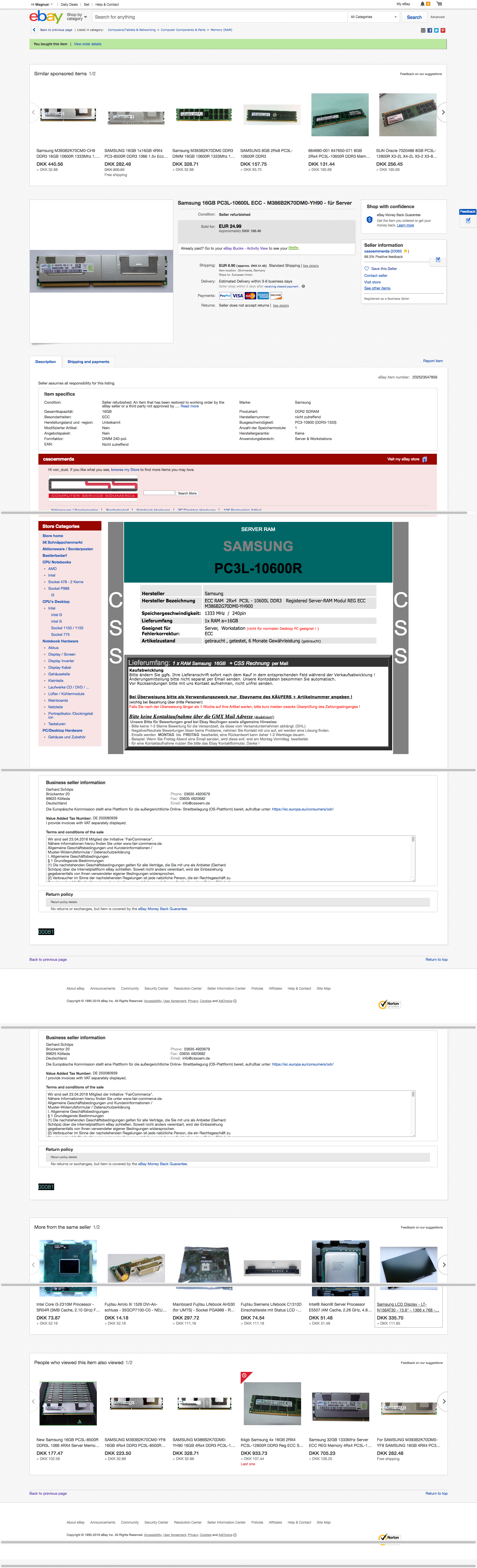

Well okay then I will look into if I can test the ram in some way then before I contact the seller. Just for good measure the one i linked should have taken you to this listing (see picture)
