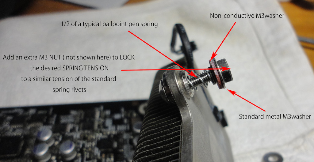

You can use the "Nut & Bolt technique but the spring should have approx the same locking strength as the original . .. or use the original rivet springs.
This is how my spare 4,1 tray is set up.
