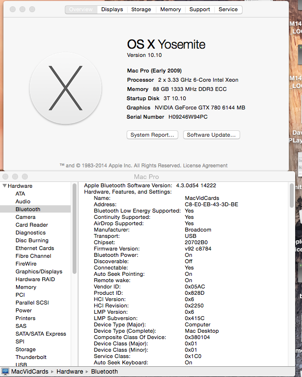

It can be done, sadly much easier in a 3,1 so far. That being said, the BT 4.0 in 3,1 is running at USB 1 speed.
I have to move some cards around but I'll make you a screen shot. The key is to use the board from a recent iMac.
We are trying to offer some options but my inability to type in Chinese is a problem.
I can pretty much guarantee that there will be options, either Apple cards or 3rd party with driver tweaks.
2009 MP 4,1/5,1 works with BT 4.0
This required a USB plug routed back into PCIE slot. Will be working on more elegant solution, but good to know it can be done.
100% easier on a 3,1 since Apple seems to have gone off-spec on the Mini PCIE slot in 4,1 and 5,1.
I have some more ideas, but there will be options, it just may require a PCIE slot and a USB plug.
NVR: only need USB

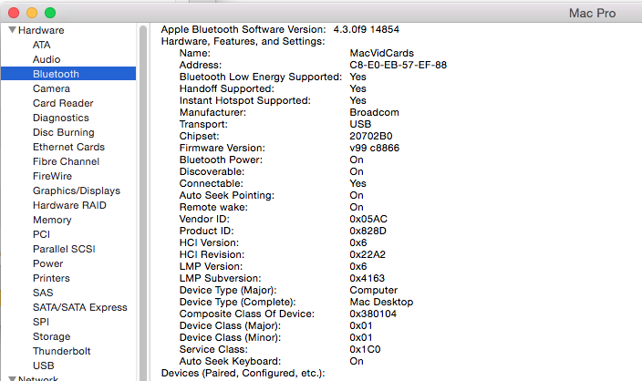

I would like an internal solution if at all possible.... i have mid 2012 mac pro.
We have a super-elegant solution, completely internal.
Uses existing Mini-PCIE slot and BT jack.
As we promised, perfectly functional in GM.
