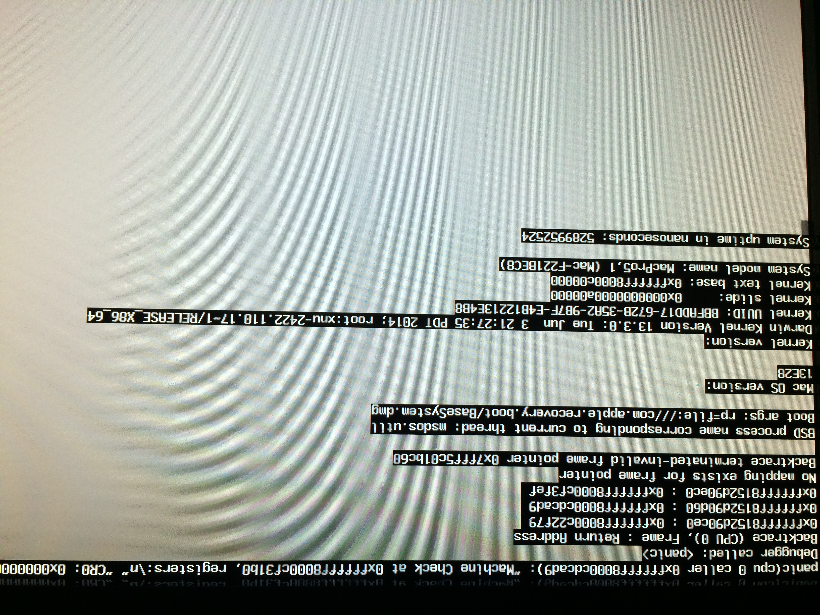

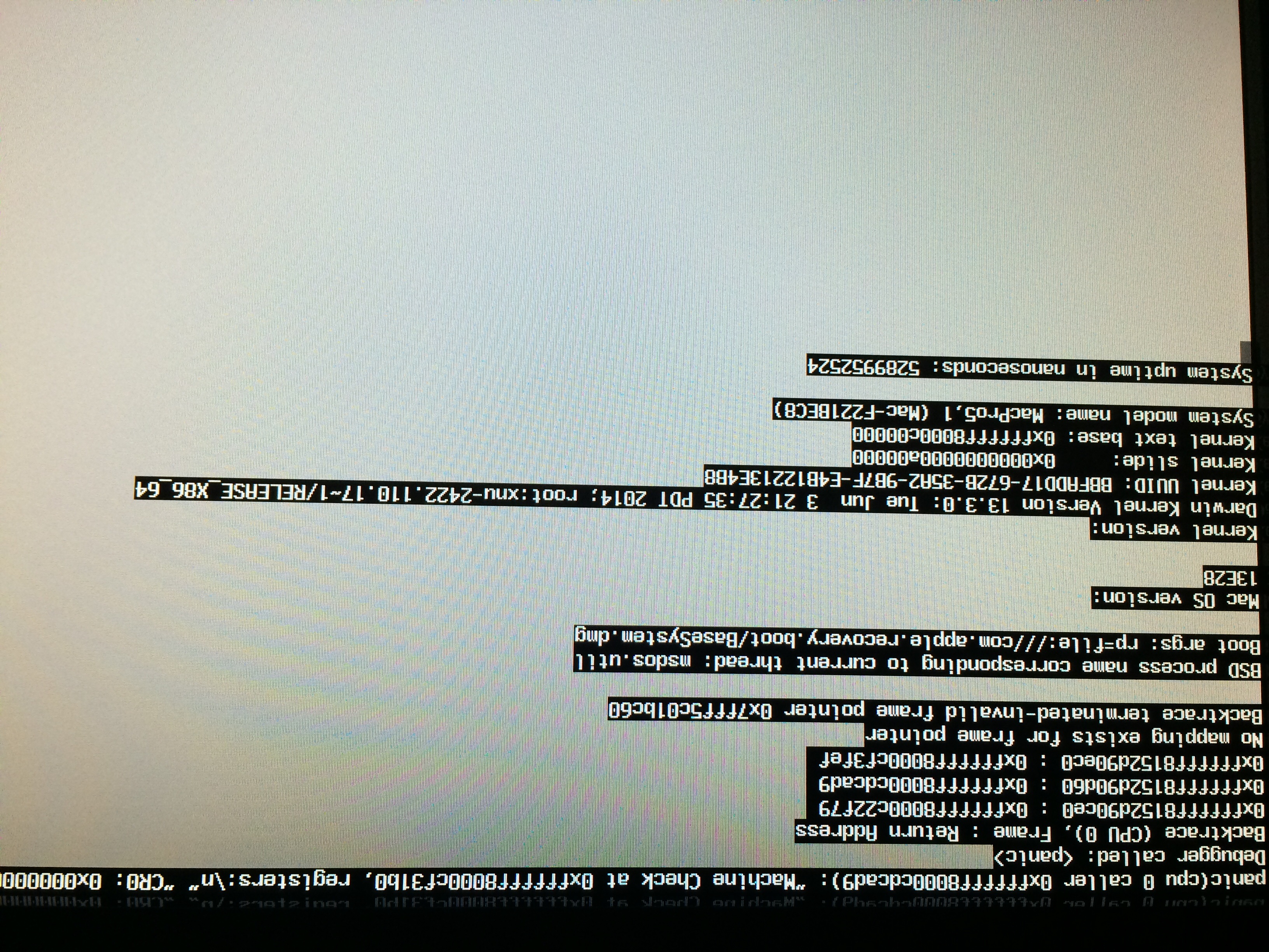

Ok, so I am trying to upgrade my early 2009 Mac Pro that came with 2.66 quad core to a 5,1 with a 3.46 hex core processor.
I have downloaded and upgraded the EFI to a 5.1 and went ahead and installed the processor, and then went to boot it.
Now it won't boot in either 10.9 or 10.8, nor the recovery discs, and each time I try, I get the same kernel panic (see attached). Sorry for the huge picture, I'm working on my iphone here.
I'm about out of ideas how to get my mac up and running again. Any ideas?
If all else fails, pull the new CPU, inspect the CPU socket carefully and if no damage is visible, reinstall old CPU. If everything works, check to be sure your Mac shows as a 5,1 (to be sure the EFI upgrade worked) and, if so, reinstall the new CPU. If it doesn't work, it may be bad.
After you upgraded the firmware, did it boot normally with the old processor?
If it did, I would reinstall the old processor to verify the system.
EDIT: Looks like DPUser beet me to the punch.
Well I did reinstall the old processor, and it did boot normally. I then put the new 3.46 hex core in it, and it still panics. However, it will boot in console mode. I can get into /var/log/, and browse the logs with VI, but I'm not sure what I am looking for yet. Being able to get into console mode is making me wonder if it a software issue, it maybe I should try a fresh install of mavericks.
Btw, if you look at my screenshot, it is identifying as a 5,1. Should I also check the firmware edition? I wonder if it logged somewhere, so I don't have to swap the processor again.
Your screenshot is truncating the most important bits to the right hand side. If you want to post the complete kernel panic, maybe someone can help you- otherwise, you might be able to google the machine check codes and figure out why the machine is panicking.
-SC
Maybe a bad CPU. if you purchased off ebay, take advantage of your buyer protection asap.
I did this upgrade, and followed the path of, 4,1 -> flashed to 5,1 -> installed new cpu. Boot and ta-da.
There should be no OSx conflicts, no software conflicts. If 4,1 worked, 5,1 should work without a hitch.
Make sure your ram is seated properly, gpu etc all that stuff. If that looks good, and your old cpu boots no problem. REturn that new CPU asap.
I second Korican
Should work, if not likely a bad CPU
As this is single CPU machine, really no way to screw it up.
I would be 100% certain that all the little gold dots on bottom of CPU are clean
Slight possibility it could be the ram trying to do 1333 and failing?
Did you zap the PRAM after the install? If not, then it should be running the old speed, which would be safer. To be more sure, you could pull out all but one DIMM, try it, and if it fails, try another dimm. If still fails, its gotta be the CPU
Check if hex CPU doesn't have any missing parts (micro resistors specifically).
If your machine boots with old CPU, then CPU socket is OK.
You may also reset PRAM to clear boot args, because it looks like your MP tries to boot from recovery partition.
Im sending it back
Well after reseating the chip three times, and checking and cleaning the bottom, there is still no change in the behavior. From all reports, it should not be this hard. So I am sending the chip back. Hopefully I can get another 3.46 chip soon.
Im now using the machine again with the old 2.66 quad core processor in it again. For those who are curious, here is what the panic log looked like. From what I can tell from my Google Searches, the Machine Check error means the panic is hardware related. So it may very well be the chip.:
