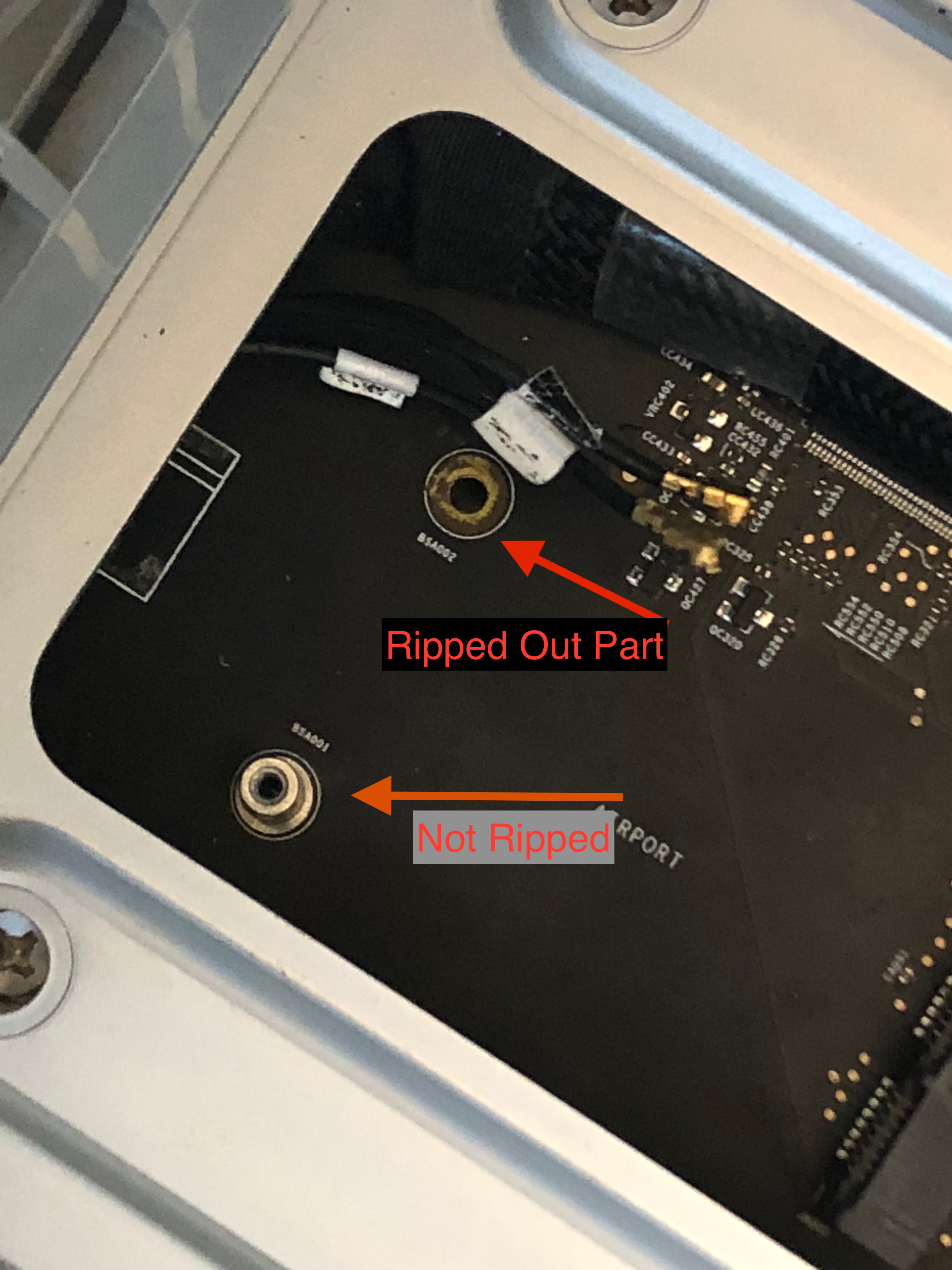

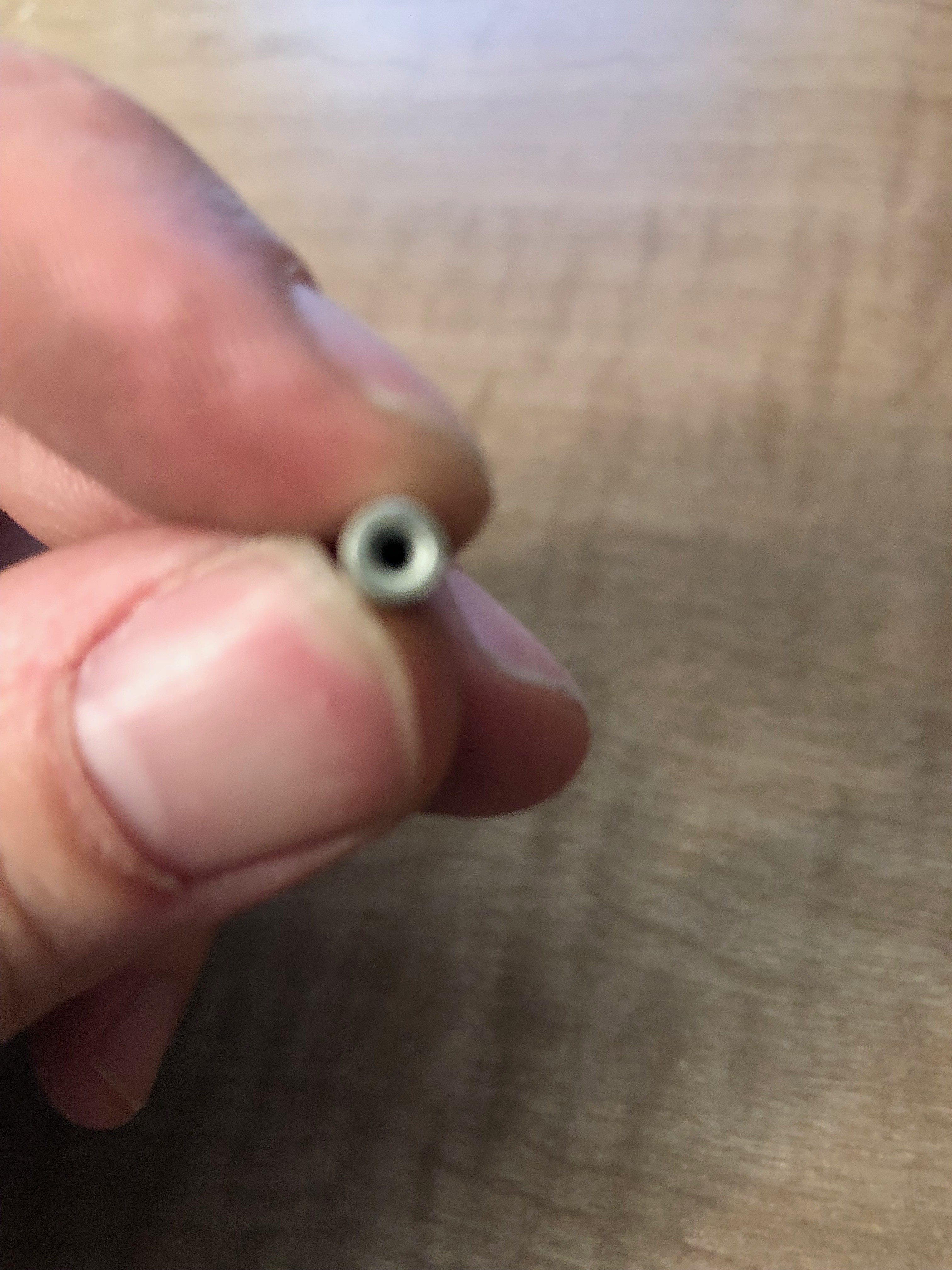

It’s really hard (for me anyway) to diagnose this without CLEARLY seeing thr result of your “pulling” the card out, and any possible damage to the LB by forcing and/or breaking the boss that holds the standoff in the blurred pic here.
I worry that you may have caused more damage than you think. I could be, and hopefully AM wrong, but I really can’t even take a good guess based on the information available here.

Totally get it. I will try to be more clear.
When I pulled the card with the stripped screw it took off the piece that the screw goes into with it, which is what I am holding in the photo. I do hope this damage isn't too serious but can see that it may have broken something else.

I have attached a picture of the damaged area inside the tower.
