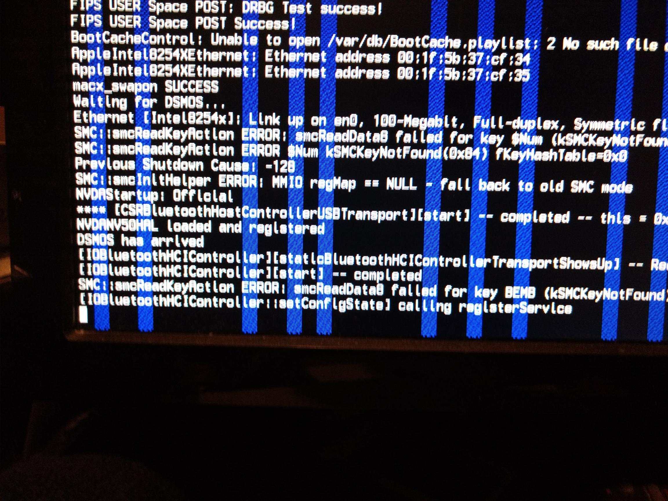

Anyone knows what this means. The last line is right before it stop and keeps rebooting itself.
Did all that. Wonder if it could be video card because of those blue lines?
Those blue lines looks strange to me as well, but a bit hard to believe you get a GPU fail right at the same time.
Anyway, did you verify both CPUs are good (by only installing one CPU in socket A)?
