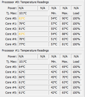

[doublepost=1479738826][/doublepost]I am currently running Folding@Home at 100% load on both cpus. The first CPU is 76-84 C warm, while the other cpu is 60-64 C warm. Can I draw the conclusion that CPU 1 should get reapplied thermal paste?

Just as a footnote to the above, the X5680 and X5690 have a TDP figure of 130Watts I believe, ( whereas the 5670 and 5660 are 95W). That extra 35W per CPU can translate into quite a lot of extra heat under intensive tasks. I notice this with 3D rendering (Cinema 4D). I've found (like advice above), that using MacsFanControl to set the minimum spin speed (idle speed) of the inlet and exhaust fans at 1500/1600 rpm (rather than 1200) did help keep the temps down without making the machine unduly noisy.
The rear CPU always seems to run hotter by some 6 to 10'C.
TAMM
I don't know which CPU is 0 and which is 1, but the CPU in the back of the case will normally run hotter because it is being cooled in part by the warm air from the CPU in front.
Nonsense!
CPU A always runs hotter than CPU B, because CPU A is cooling the Northbridge chip too!
Under load usually around 10C difference.
Nonsense!
Mine seems to be more than 10c difference, swapped the processor and it is the same. I can even see that CPU A is drawing a higher current. So that seat is powering more than just the processor.
I said 'around 10c' difference, 12-15c I've seen often.
You might try re'applying the Northbridge chip cooling paste, I had succes with several MP's.
Not so easy to describe, but when the heatsink is of CPU A, try to 'wiggle' the NB chip, you should be able to feel the difference between dried up paste and paste as it should be.

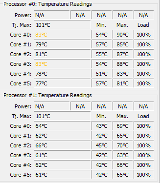

[doublepost=1479738886][/doublepost]View attachment 673810

Since this thread is being revived and I had overheating problems after upgrading to the X5690, I needed to lap the die more and revising my thermal compound choice after delidding because the heatsink base wasn't sitting flat on the die.
Make sure the heatsink is actually touching the processors. Also for some reason liquid metal didn't work very well (My guess is liquid metal was too thin for the uneven surface between the heatsink and delidding processors). I ended up using graphite thermal pads.
