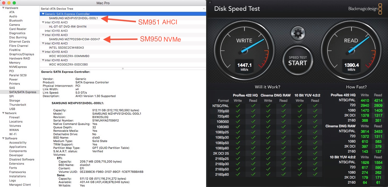

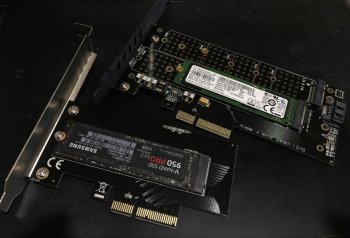

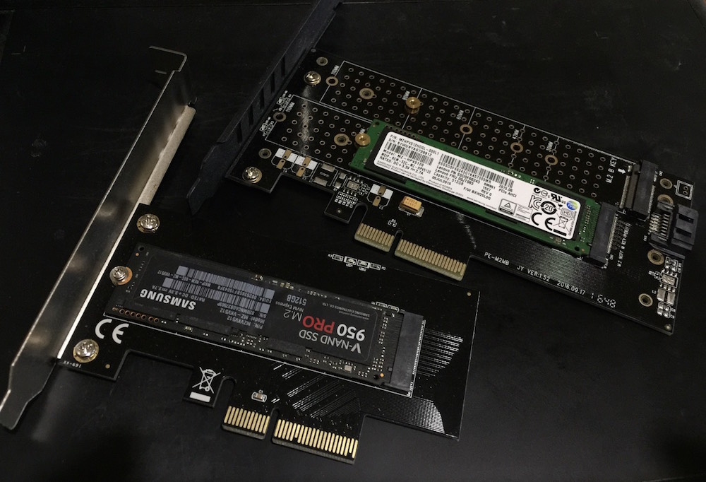

I can confirm that both working perfectly together at pci-e x4 (#3 #4), I am using SM951 (512GB) AHCI in slot #3 for boot drive and SM950 (512GB) in slot #4 as data drive. the speed is almost the same at maximum 1,4xx MB/s for both read/write.
PCI-e to M.2 adapter is only the cheap one got from China.
