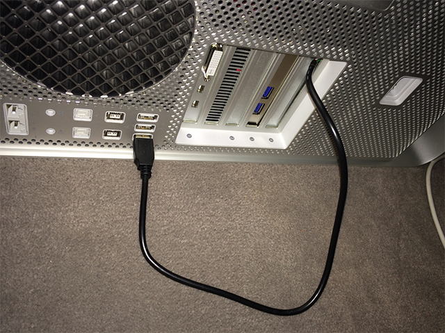

Hi,
I want to buy a new WiFi and Bluetoothcard for my Mac Pro from OSXWiFi.
http://www.osxwifi.com/apple-broadcom-bcm94360cd-802-11-a-b-g-n-ac-bluetooth-4-0-with-adapter-for-macpro-2009-and-macpro-2010
But I’m a bit confused right now…
I don’t get why I have to use the custom USB cable.
MacVidCards offers the same WiFI card without the need of an USB cable.
But their cards are almost always out of stock...
Can someone explain the difference between the MacVidCards and OSXWiFi kit ? Maybe someone who got the OSXWifi Kit ? Do I really need the extra USB cable to get Wifi AC and Bluetooth 4.0 work ? I don't want a solution like seen in the picture lol 😀

OSXWiFi needs the USB to power the BT card I believe.. the macvidcard solution uses the BT power plug.
I actually scored a macvidcard kit last week and installed it on saturday..easy as pie
In case you hadn't figured it out, the Bluetooth part of the card is a USB device. The mini PCI-e adapter board doesn't carry the USB signal, so you need to connect via USB to get the Bluetooth part.
Is MacVidCards really the only source for this adapter? I have the BCM94360CD already, and it's on a PCI-express board in one of the slots, but like you I have to run the USB cable out of the computer and around to the USB ports. I bought a USB 3.0 card with an internal port thinking I could plug it in there, but if I do then Coherence doesn't work. Like, at all. No phone calls, no text messages, no handoff, no nothin'. Run the cable out of the case and it's fine. The mini PCI-e version from OSXWifi seems like it still has to run the USB out of the case. I sent them an email a few days ago to verify and got no response - I take that to be confirmation enough.
Since MacVidCards doesn't seem to have just the adapter listed at all, and even the version bundled with the card is out of stock, I'm just waiting and scouring eBay.

OSXwifi and MavVid works the same way except how they power USB. Of course MacVid is better as it uses actual BT power on the board (for MacPro 4,1 and 5,1).
You can just make the cable yourself using actual BT power cable. Just follow the posts of https://forums.macrumors.com/threads/1748061/ , read and read and read. You will figure it out. It's actually pretty simple.

Solution has been upgraded to make it a fully internal solution.
New USB cable connects to the original Bluetooth data cable Internally.

Installation is pretty easy, you just replace Wi-Fi card and connect custom USB cable to original Bluetooth data cable.
Yes the installation guide is updated.
