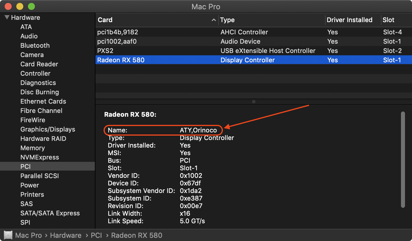

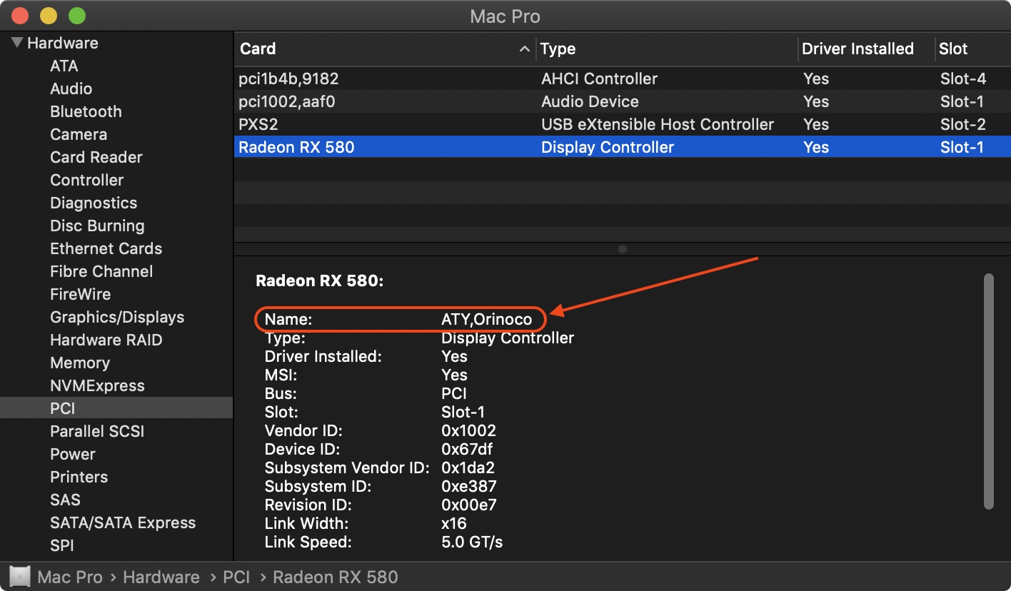

Do you install Mojave yet? And what you see at here?

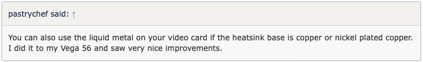

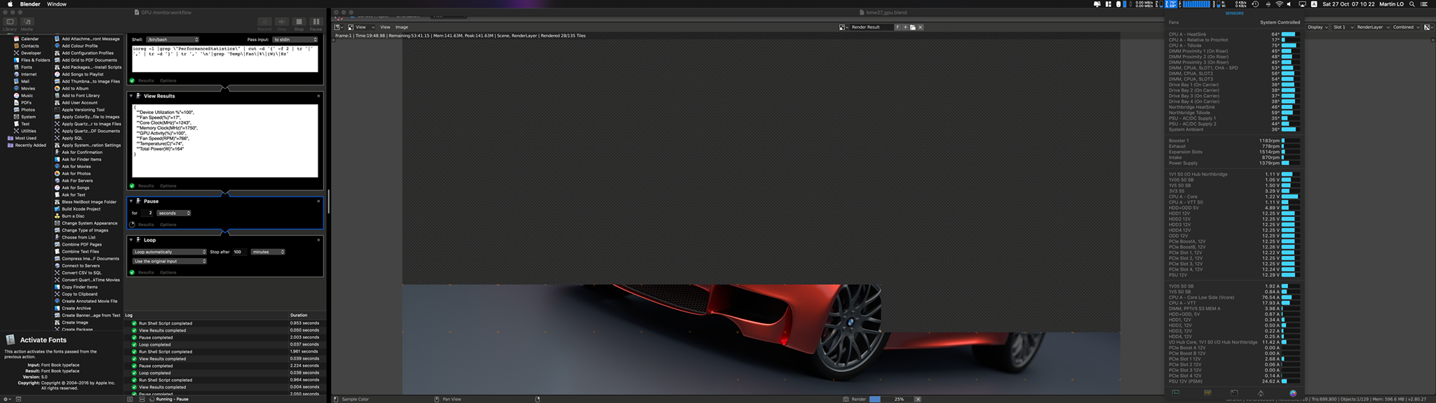

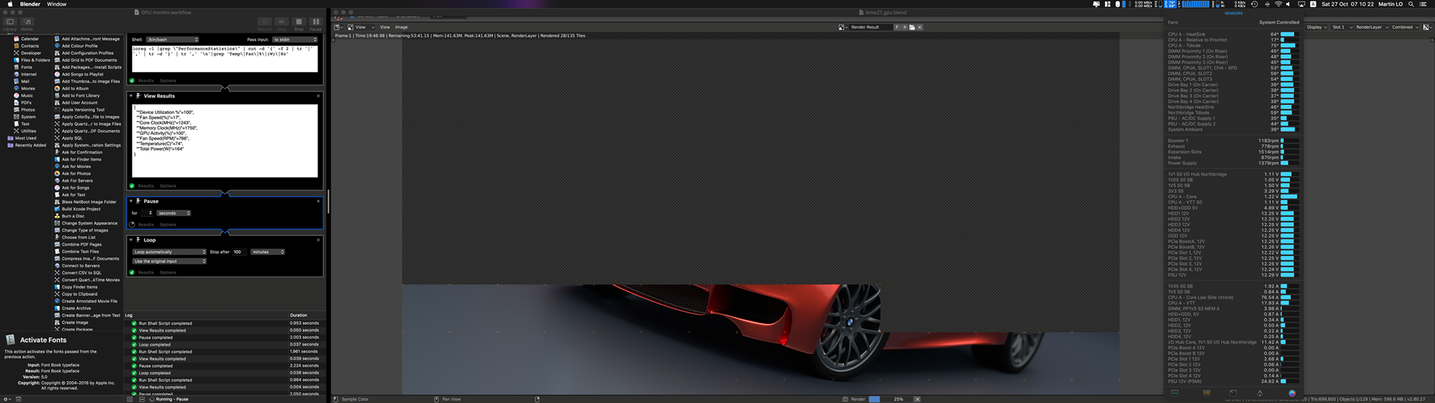

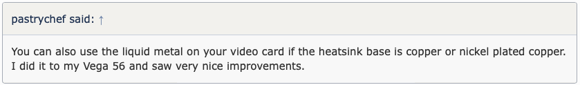

I just modded both my RX580 and 1080Ti with liquid metal. The cooling performance improved a lot. My downvolted RX580 can now run OpenCL rendering for hours but the fan speed still below 800RPM. That's pretty quiet actually. In fact, even Furmark now can't make the GPU go beyond 75C (target temperature) and the fan still a bit below max.
My PNY XLR8 1080Ti is even more crazier. With liquid metal, it can now run at 2000MHz but the GPU never goes above 71C.
From both graphic cards. I can now understand that the stock cooler is actually very decent, and can do the job well. The problem is the thermal paste bottleneck. In fact, the same thing applicable to Vega.
However, I won't recommend anyone do this mod. It will void the warranty straight away, and poor liquid metal application can kill the PCB because they are electrically conductive. But just want to let you know that the cooler isn't that bad......usually.

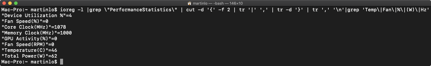

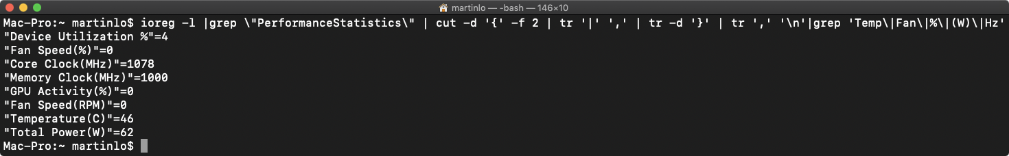

Just ran the terminal command you did. My temps are 38C and the fan speed is 2000 RPM. So stupid. Total power is 58W.

Yes, liquid metal is a kind of thermal paste, but due to it's base on gallium, it has super good thermal conductivity and electric conductivity.
For thermal paste like AS5. Despite the manufacture says it has 8.7W/(mK), the lab test shows the actual performance in real world is just 0.94W/(mK).
But for gallium, its thermal conductivity is 40.6 W/(mK). Even AS5 can perform as expected, gallium still 5x better. And in real world, gallium can be 40x better.
Silver of course can conduct heat very well. However, how to apply is the issue. Gallium can be used as thermal paste because its melting point is about 30C. And gallium alloy can easily stay at liquid form in room temperature. Therefore, easy to apply with a little brush.
Anyway, I really wouldn't recommend anyone apply liquid metal because of the risk, unless he know exactly what he is doing and how to avoid them. e.g. Before I apply liquid metal to my graphic cards, I actually applied some clear nail polish on the resistors that right next to the GPU die. Just in case if there is any liquid metal spillage, they still won't easily short the circuits and kill the whole graphic cards. Despite lots of review said liquid metal is hard to apply. IMO, it's not hard at all, just "very less margin for error", but the process itself is very straight forward. I've done that to all my 8700k, W3690, RX580, 1080Ti, no difficulty at all. Even I almost kill my 1080Ti, but those nail polish work as expected, protected the resistor, and the card still running flawlessly at this moment. The risk is there, but avoidable.
Also, please take some time to read though that Vega thread. 38C, but 2000RPM, your card is suffered from the fan speed bug. Some work around was discussed in that thread, you may give it a try.
