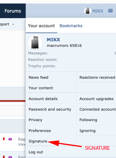

In your case it would be a good idea to make a "SIGNATURE" in your Macrumors member profile.
As an example my "SIGNATURE" is at the bottom of this post. A signature will automatically be included in all your Mac Pro forum posts, it will allow us to instantly know how your Mac Pro is set up.
