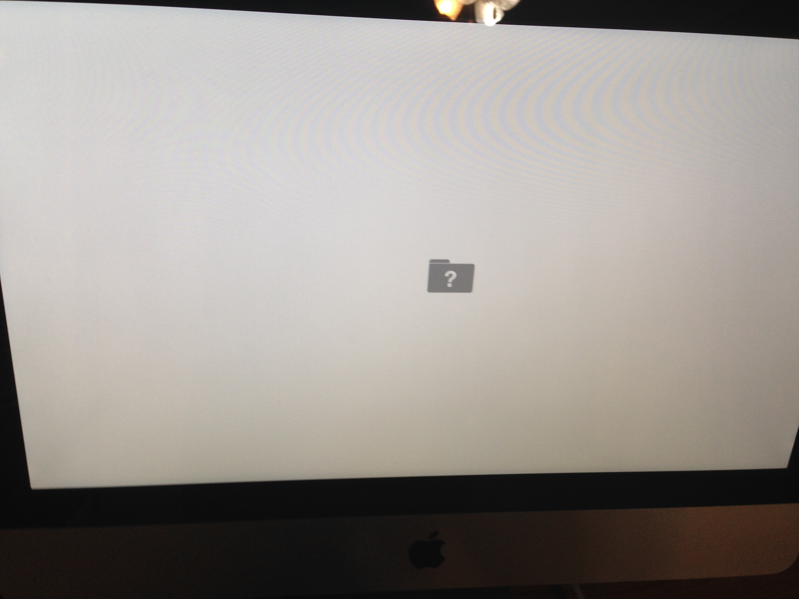

When you have an AppleOEM GPU you should see exactly like any other Mac of the same generation, the grey screen when the display powers on after the chime, followed some seconds later by the Apple logo, then the failed disk image (folder with interrogation) when the Mac Pro doesn't find any disks.
You won't see any of these with a PC un-flashed GPU.
