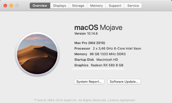

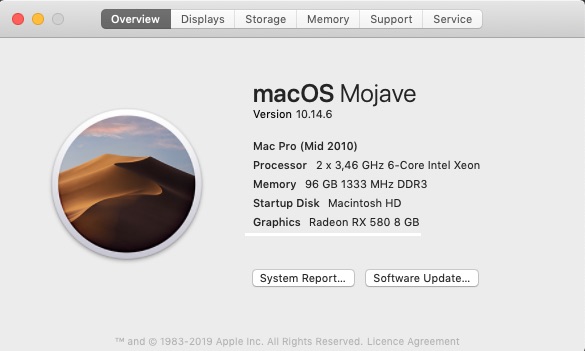

I have a mac pro (mid 2010) 5.1, 2x5690, 96 GB ram, Sapphire Radeon RX 580 8GB, and runs on Mojave. I am super happy with the setup, in special after upgrade to Mojave the computer works super great, fast and stable. Among heavy programs I use is premiere pro and After effect..works great. But when it comes to Blender 2.81 3D program, I think its more to get out of the computer. It works ok without any lag or Blender hanging or crash, but quite slow on cycles and rendering.

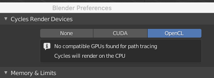

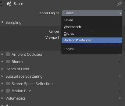

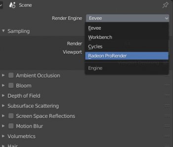

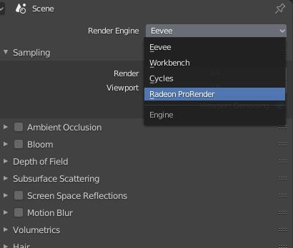

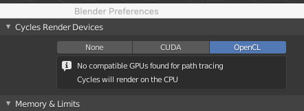

As you know the Amd RX 580 Gpu will not maybe give the best performance for Blender, there is not an option for OpenCL, I have installed and tried the addon, AMD Radeon pro render for Blender and got that to work witch then use GPU for rendering but the quality is not good enough. So mostly I work in cycles, and then it uses the 12 core CPU.

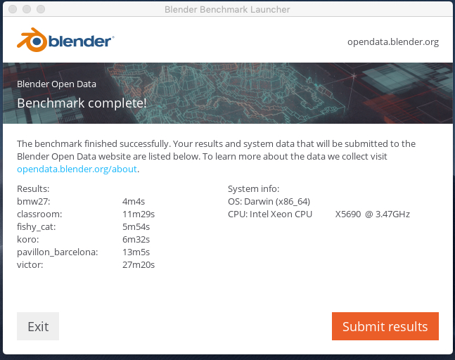

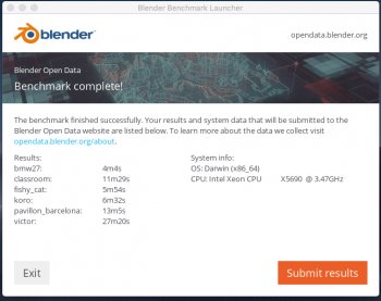

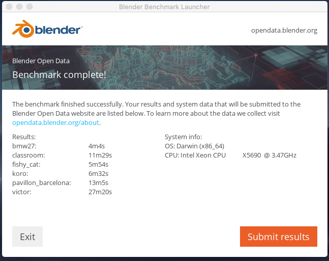

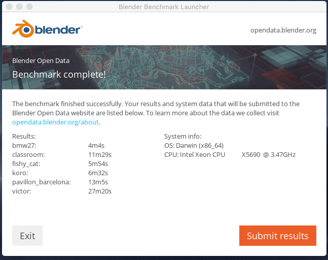

Here some Blender benchmark with the 2x5690 (and the rx580):

As you said, OpenCL isn't supported anymore in Blender 2.8. So, if you want to use AMD GPU for rendering. Radeon Pro Render is the way to go.
I only use Blender for fun, and I just make a quick screen recording to show you that what can expect from a Radeon VII. (Please watch the Youtube video at 4K, otherwise may looks quite blurry)
Ohh thanks for the youtube video showing how it works for you under Radeon Pro Render, extremely useful for me....It looks quite similar to how it works for me. Thanks for the info about this. Have you done the blender Benchmark? It would be interesting if you get the same result as mine. Thanks to you and Tsialex's generous info, I then so far just stay with my RX 580, as said, after all, works ok. The reason I wanted to maximize my set up is that my learning some years ago stranded due to mush limited hardware, but better now, and able to do tutorials. I also use Blender just for fun..but its extremely fun and addictive. Again super thanks.
Not yet, but I expect 100% slower than yours due to the only device that I can choose to benchmark is my W3690, and you have 2x X5690.
