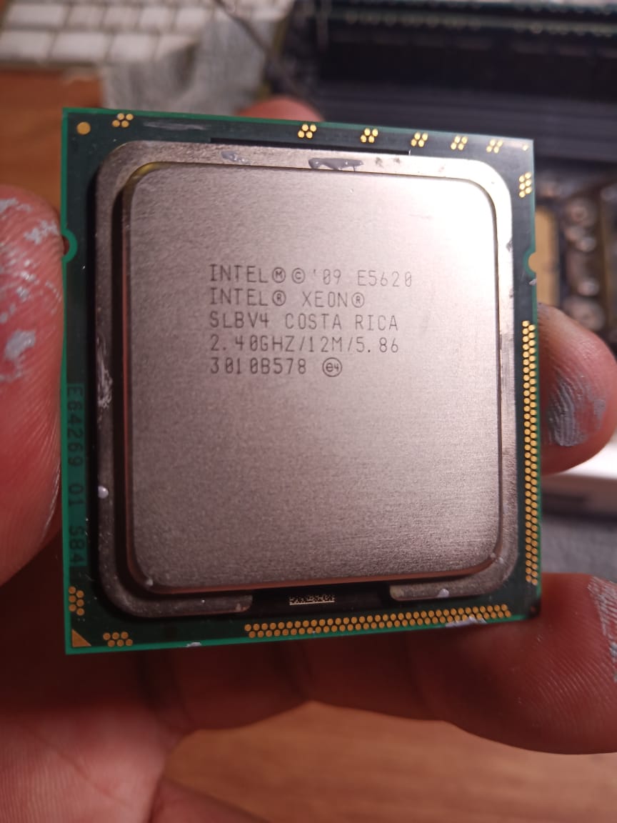

@tsialex
So I tested the CPU one by one;
Cpu A in CPU tray A: Chime ON, Fan Ramp Up to 100%,
Cpu B in CPU tray A: Chime OFF , Fan Ramp Up to 100%
I found a cheap CPU as we speak..i want to reconfim this to you before i buy it.
So, you confirmed that at least one Xeon is defective.
While matched pairs don’t exist for this Xeon generation, you need to buy one identical to the Intel SKU ( needs to be the exact same SKU version/frequency/model ) or another pair.
Ok, mine is Xeon E5620 2.4gHz. i attach the CPU picture...i just need to get the same isnt it? ill upgrade it in the future, for now, if this work, itll do.
