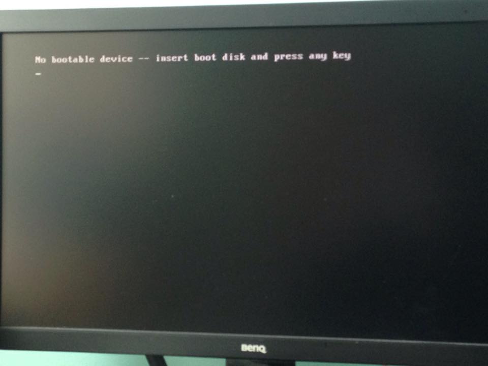

My Mac Pro 5.1 was laying around since like 7 months, today I decided to turn it on. It has no hard drives in it or anything, keyboard and mouse dont work but it always boots, the problem is it boots into Bootcamp even tho I have no harddrive or anything, and I cant do anything. I cant even pram reset it since keyboard doesnt work, I tried many things.
Got any suggestions?

No, that is not what happens when no bootable drives are connected////
Your MacPro will bring up the flashing folder/? .
The screen that you show is one that is expecting to boot to Windows.
Reset PRAM - if you have a wireless keyboard that is not, then you need to try a wired USB keyboard. If you don't have a USB keyboard, borrow one.
I'm guessing that your GTX 770 will not boot into the Option-boot screen.
That's one of the reasons that you would keep the original graphics card - Swap the GTX 770 for the original graphics card. it will help you get your MacPro going again.

Oh, my mistake then. It's what happens on my computer when no drives are connected, but one of my normal drives is a Windows drive.
Im using the apple GT 120, HDD are connected but it wont let me do anything, keyboard and mouse are not working but connected.
Is that the Apple mouse / keyboard? Is it the wired one?
HDD connected means the OSX one? Or the Windows one? If the Windows HDD still there, plug that back in and boot to desktop, then you can use bootcamp apps in Windows to assign the boot disk back to OSX HDD.
