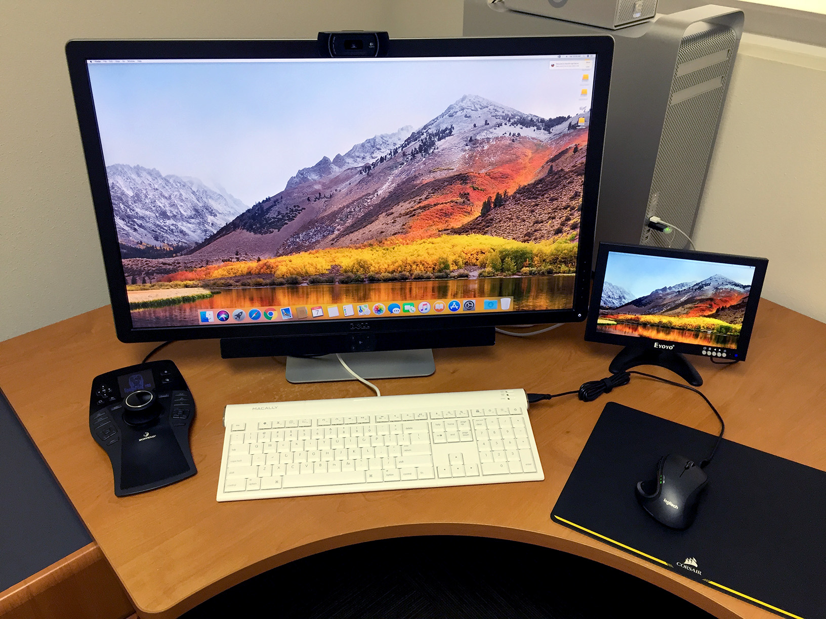

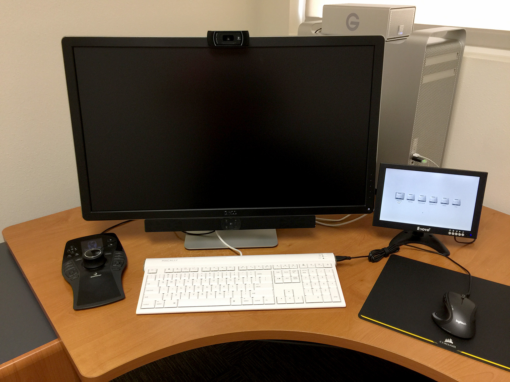

Yes ! This is exactly what I do. I run two (non-flashed) 1080 TI's and an Apple GT-120 and it works very well. A small display connected to the GT-120 and my main display connected to a 1080 TI.
I see the boot screen on my small display connected to the Apple GT-120 and when the Nvidia web drivers kick in (about half way through the boot) my main display connected to a 1080 TI goes active.
No web drivers are needed for Windows.
Below: Boot screen from the the Apple GT-120 on my small display. Works every time.
Below: Both Displays are active after boot.
It's actually a great setup for me. I watch a lot of YouTube and Vimeo tutorials for graphics programs (Cinema 4D lately) and I can put the tutorial on the small display and follow along with my large display. I actually love it. Plus it's very handy for Photoshop or any other program to put your pallets on the small display while working on the main display.

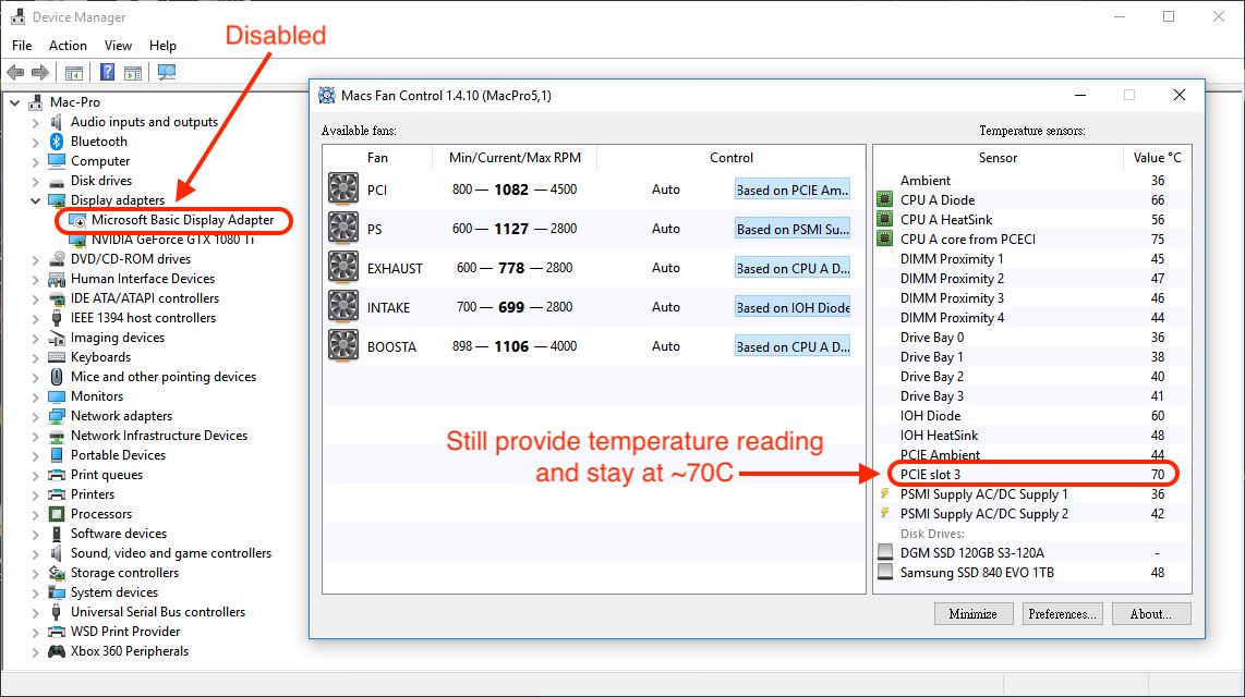

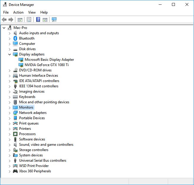

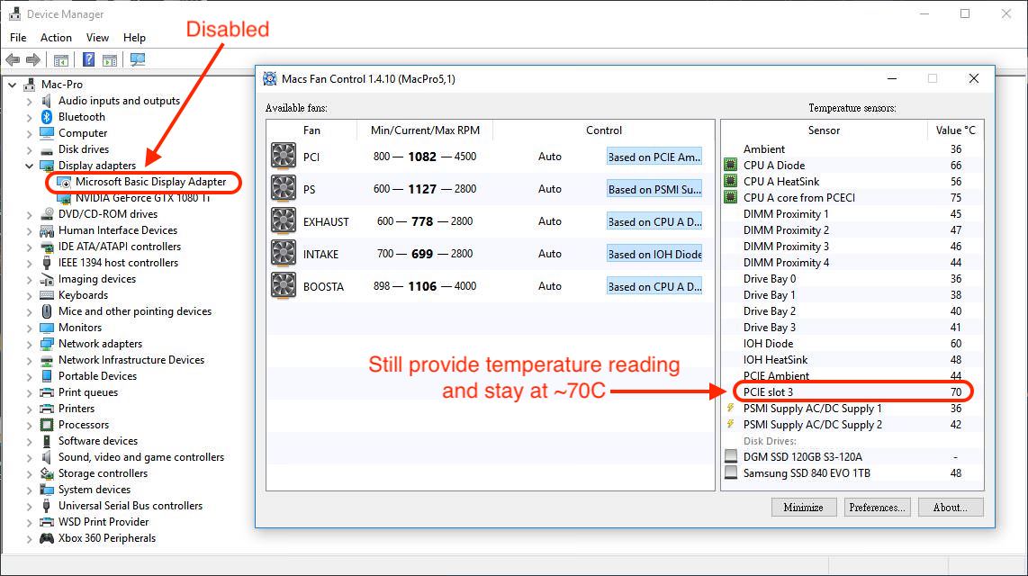

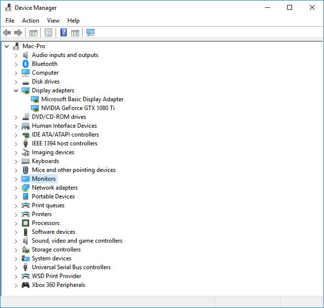

Right click the GT120 in device manager (it may call itself 9500GT something like that), select driver update, manually choose Microsoft Basic Display Adapter.
After driver selected, you can disable it. Don't worry, it will still work, still display, even can still provide temperature reading.
Then you can install the latest Nvidia driver for the 1080.
