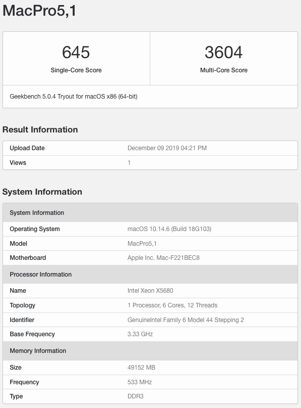

Here's my latest Geekbench, went up a little actually with the Noctus Thermal Paste and fans.

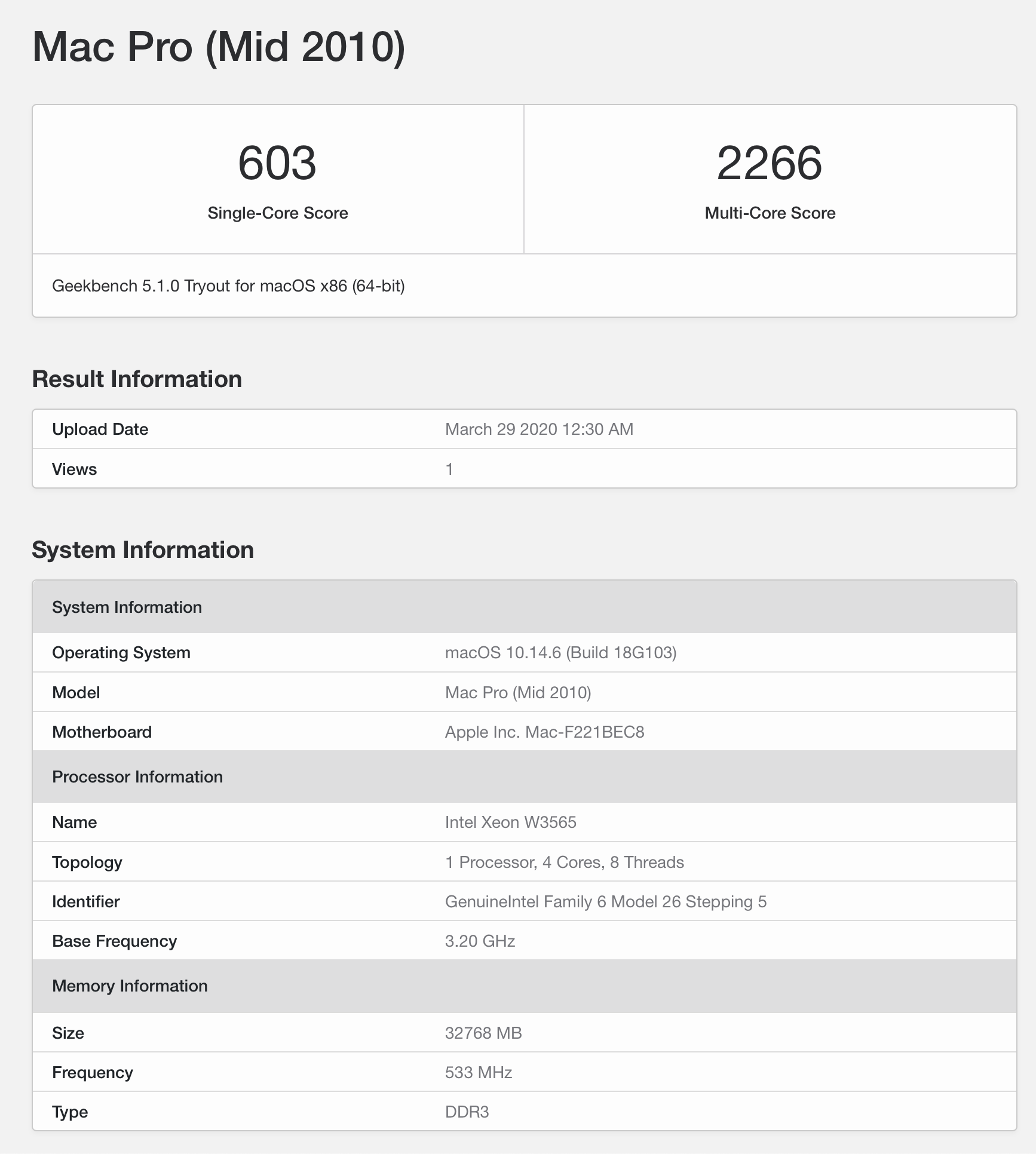

I just went to Geekbench and my results were not good. 😞

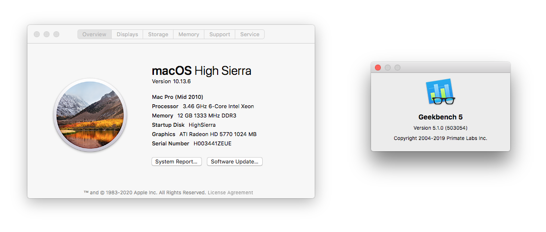

Is that Geekbench 5? I'm running Geekbench 4 still as I'm still on High Sierra.
If upgraded to X5680 3.33 GHz (and 3x16GB) you would get something like:
So single core would be up 7%, and multicore 59%. That's geekbench, real world tests with apps ofcourse is what matters the most.
I have Geekbench 5 on High Sierra...
