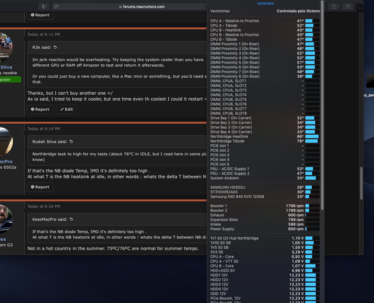

Northbridge look to high for my taste (about 76°C in IDLE, but I read here in some place that for a 2cpu machine is ok, don't know)
Fun fact: When use IStats to put the coolers up looks like it can export (the heatsink and tdiode get cold about 51°C) But all of this is not scientific because when I leave the fan speed in the middle power looks like I can export (most of time I export, but in some times I cannot) So I don't know, don't know what to do to get more precisely in diagnostic , don't know what to do to solve the problem, do no nothing =/
If that's the NB diode Temp, IMO it's definitely too high .
At what T is the NB heatsink at idle, in other words : whats the delta T between NB diode and NB heatsink?

Not in a hot country in the summer. 75ºC/76ºC are normal for summer temps.
I think so but for example, now I'm running my system at 77C in tdiode and 65C in heatsink and I can do everything pushing the CPU and GPU, like render 4k video (render inside the software) with noise reduction and LUTS and 3d effects etc... or maybe transcode video using the max of CPU and the NB goes 85C and the system still running. So what is the relation of those high temperature with the fact to export the video?
What im trying to say is:: Those temperatures are high, fine, I agree with that however If the high temperature was the problem why the system doesn't goes down when im doing others things instead export a video? Any ideas ? =/
I’m inclined to see that the temperatures with your case are a symptom, not the real cause.

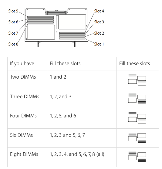

Maybe a far shot, but do you really have 5 DIMMs installed?
That's not a recommended setup, normally you'd want to install 2, 3, 4, 6 or 8 DIMM's.
So, if you _do_ have 6 physical DIMM's, but only 5 are identified as in your report, you might have a DIMM problem.

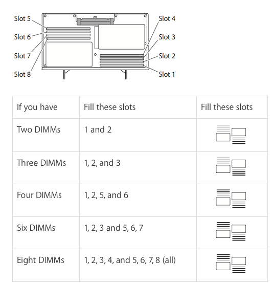

since you said that a strange thing happened, 2 days ago I was with 18gb of RAM, after removing the rams for cleaner a get 20gb (don't know if was the ram o if a changed the slots)
Than after and update and reboot here I got 24gb (with the same amount of rams installed)
So don't know, maybe
don't know why is missing but is there inside istatus and is normal as the others about 38C high now
If CPU A heatsink is ~ 38C at idle, CPU A diode should be only a few degrees higher like ~ 3 degrees max
If CPU diode is at 52C (at idle) there's very poor contact between CPU and heatsink.
In that case you should repaste and reseat the heatsink(s).
Reactions: Rudah Silva
If the issue was with the CPU overheating wouldn't the symptom be one where the machine simply turns off? Instead here it's restarting.
