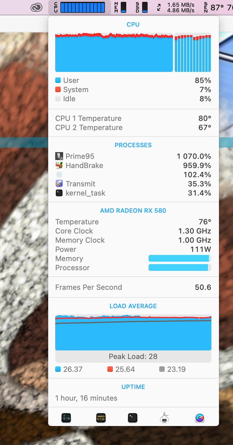

You may stress test the PSU for an hour in order to check the stability.
1) Run Prime95 to stress the CPU
2) at the same time, run Furmark to stress the GPU
This can create a power draw that higher than any moment of video editing.
If your cMP survive, then all power (and cooling) should be at gold standard.
Espect high fan speed during this kind of test. If you still worry about the temperatures, you may manually spin up the fans. However, in order to know "if the system can work at your existing setting", you better just leave it alone, and let it manage the fans by itself.

Thank you for that.
OK, I am not sure I understand how to use those apps properly, but I ran both of them together for a while. I was busy running some handbrake compression and file uploading as well that I didnt want to quit. Eventually the fans began to be heard but not that loud. Here is a screenshot from iStat CPU page - does it make sense?
No blackout happened but maybe not run long enough. But the 'blackouts' I was having were far more frequent and often just opening a 4K video file in FCP would crash it, not even doing any playback. Even creating bezier clipping paths in Photoshop would get the fans going.

All number looks normal to me.
If the cMP can survive under this kind of loading, then the PSU and cooling system should be fine.

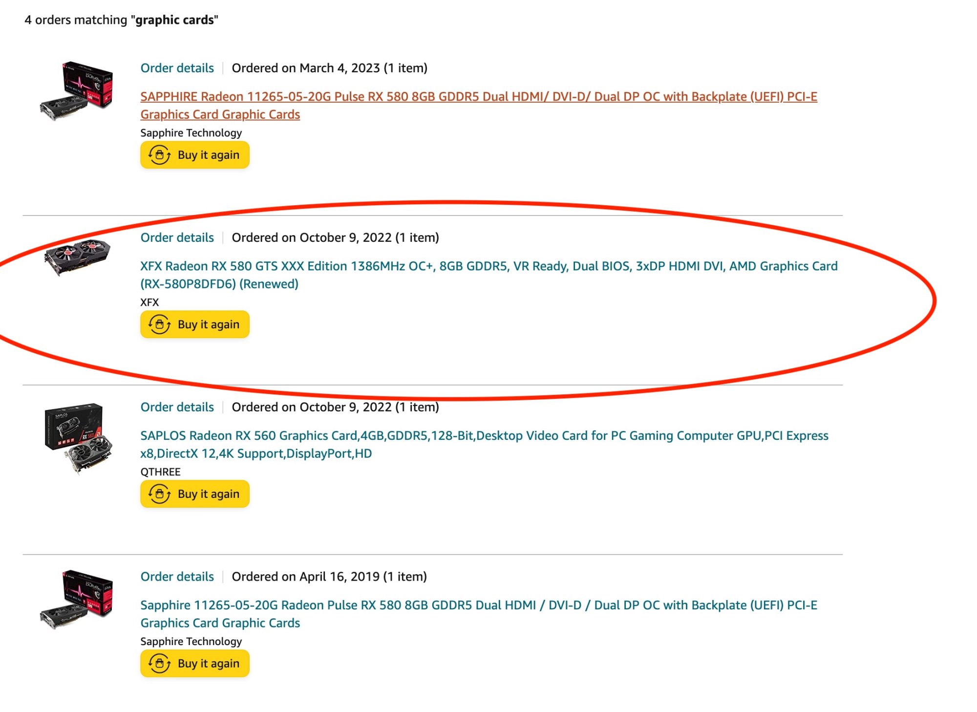

1 thing i noticed is that this only happens when i am using the saphire Rx580. In 2020-21 i purchased a saphire Rx580 and it worked great. Then this started happening so i purchased another. and another. People told me it had to be a faulty card or the thermal paste needed to be applied again or the cables were bad and that i should buy american cables or that the PSU was going out and I needed a new one or that the new one i just purchased was faulty and needed another new one. All of this was a very expensive money pit.
What i can tell you is that the RX580 that is not a nitro included in the picture below doesn't suffer this issue (yet) and this issue doesn't happen with the RX560 that i purchased just so i am not left without a computer for work.
The other day i was told to alter the config file in the device section and add instructions to it, basically telling the computer to not throw some much volts at it when rendering? I did it to my config and it worked for a week and then back to the same problem.
I am researching what other folks did and it feels like going down a rabbit hole so I know how frustrating it is for you, believe me i do. At the moment I would suggest getting a smaller card like the 560 if you need to work with your computer to make money. I am using the 560 and rendering 4k video albeit a lot slower it still gets the job done. Best thing is it is self powered too and requires no cables. Alternative number 2, buy a non nitro card like the one i got recently and cross your fingers.

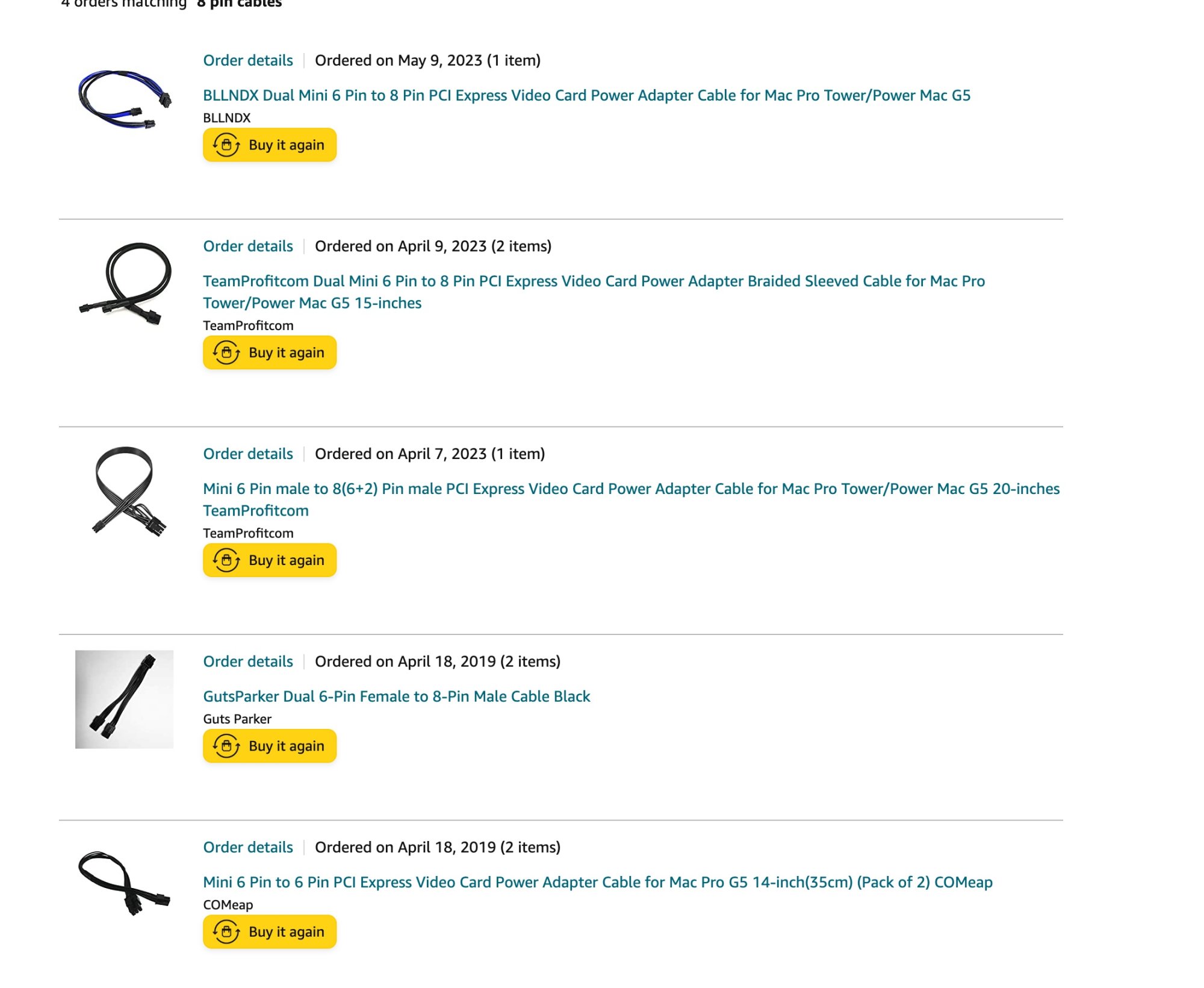

I wanted to show you what cables i have tried so you don't make the same mistakes I did going down that route as a possible solution.

Just to clarify, from your attached screenshot of RX580 GPUs, the brand of GPU you purchased is a XFX brand? If I recall correctly, XFX brands sometimes would give problems to the classic Mac Pro.
That may be so. I did not realize at the time that that' particular card had any issues with the mac 5,1. To be honest i didn't know there was any difference at all with the RX580 because i was/am a rookie at this and listened to the wrong people. What i can tell you from my personal experience as of today that XFX card is the ONLY RX580 that will work properly rendering graphics on MY mac. I don't know why, it's just the experience as of today.
To reiterate the problems squarely lay with the SAPHIRE RX580 and not the other two portrayed in the picture above. I forgot one thing to the original reply. The saphire RX580 has a switch in the back of the card where it can boot from a different ROM? Just want to add that whether i boot with the switch is to the left or to the right it makes no difference with clearing up the problem that I was/am having with the black screen/fans full blast issue when stressing the computer with a GPU intensive activity i.e. using Topaz Video Enhancement AI, AI upscaling photos, running a Geekbench Compute test, etc..
