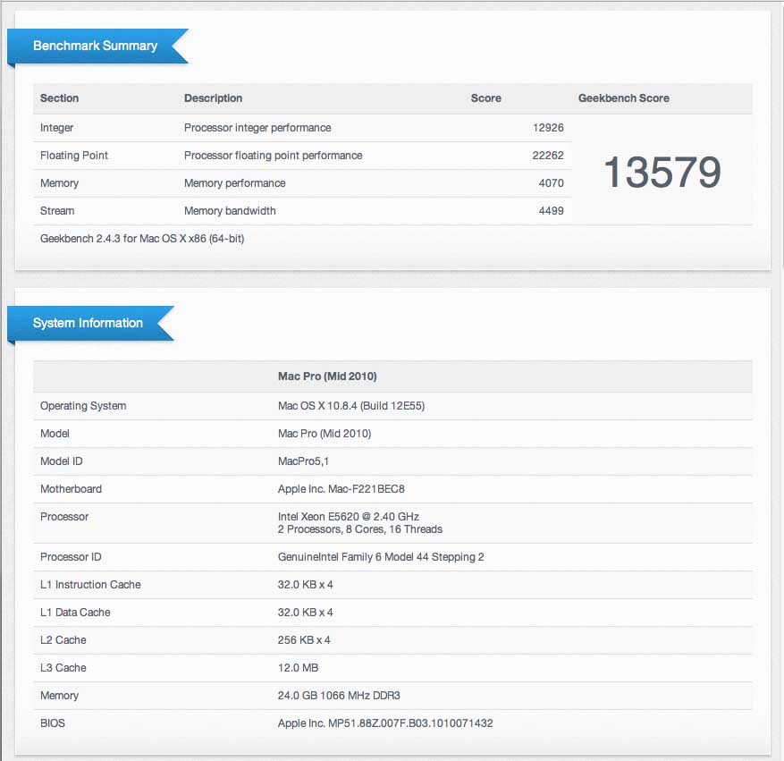

Thanks to Thomaspin for his post and blog on how he upgraded his 4,1 machine to use the W5590 (4 core, 3.33 GHz) CPUs:
https://forums.macrumors.com/threads/1609476/
I had been contemplating upgrading to X5570s due to the lower TDP, but Thomasspin's post and blog convinced me that the W5590s would run OK.
My machine is a 2010 5,1 and came with E5620s (4 Core, 2.40 GHz). The Upgrade was far easier than the 4,1 due to the CPU carriers design utilizing the CPU holding mechanism and CPUs that utilize an Integrated Heat Spreader (IHS).
I had never replaced CPUs before, and was somewhat trepidatious about trying this but, I downloaded this excellent Apple Guide:
http://tim.id.au/laptops/apple/macpro/macpro_mid2010.pdf
I printed and bound it, and read and re-read the sections on Heatsink and CPU replacement until I could recite it in my sleep. The Thermal Grease and long 3mm socket arrived in the mail on Wednesday and the CPUs (refurb units sourced from ebay) followed the next afternoon.
I powered down the machine before supper and pulled the power plug. After supper I threw caution to the wind and opened my one month old machine and pulled out the processor tray. Thirty minutes later, all was complete and I powered the machine on. I was greeted by the White LED along with the Start-Up Chime. It appears that I had done it right😱

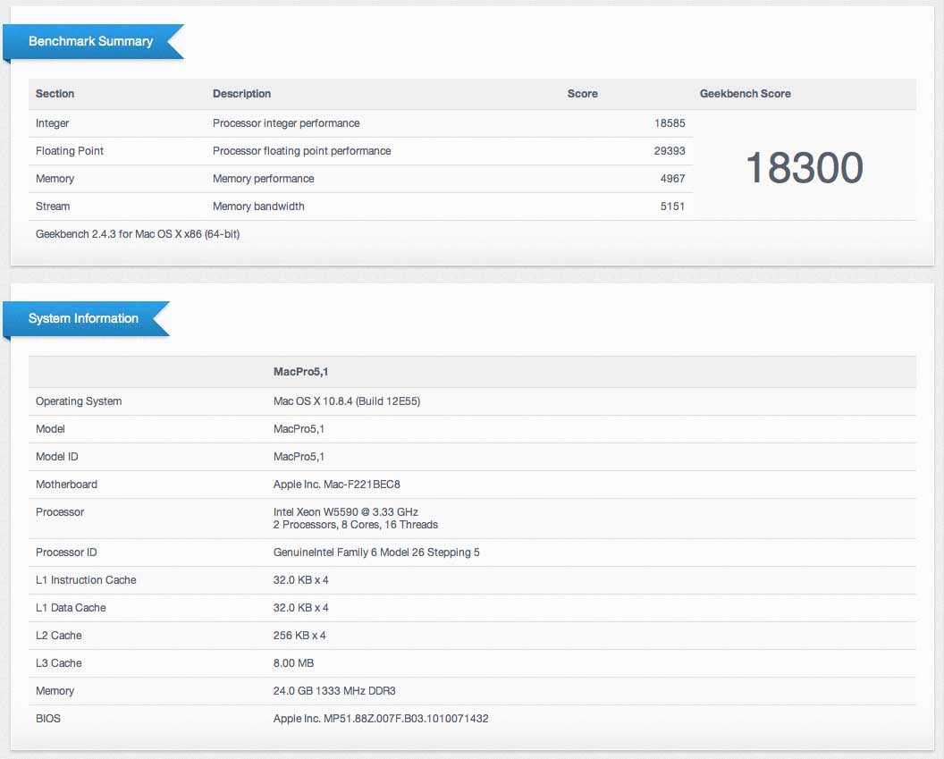

I was somewhat disappointed by the after Geekbench score, I was expecting something closer to 20K, but my results are a solid improvement of 35%.
The machine does run hotter (by 10° to 15°) and I am now using smcFanControl to speed up the fans. According my my UPS my wattage load has increased from about 250 watts to 340 watts.
My Before and After Geekbench scores are attached.
Lou

First, thanks for your post. I was also thinking about W5590 upgrade since the price has come down recently, but I am a little puzzled at your results on both wattage and GB score. The author of this link mentioned (toward the end of the article) that his W5590 upgrade on an MP4,1 only caused 3℃ temperature increase and a GB score of 20643. Did you happen to get the production or ES version of the W5590? I understand that Nehalem core is less efficient than that of Westmere, but 10° to 15° increase makes me wonder a bit unless you were referring to Fahrenheit instead.
^^^^Yes, sorry, I am American and sometimes tend to forget that not all us use the Fahrenheit temp. scale.
Also, IIRC something changed with either the OS or Geekbench about the time of the release of 10.8.3. There was much chatter on various Mac sites about scores going down. As far as my score goes, The Geekbench website shows that the 2009 4,1 Mac Pro with two X5570s (The top processor for the 4,1) scores 17,537 in 64 bit. So, maybe my score is not that far off. But, it also shows my previous configuration (5,1 with 2 E5620s) scores 14,146 where my machine scored 13,579.
Oh, I do have the production version of the W5590, not an engineering sample. The marking on the chip was quite clear.
Don't know if anything I've said makes any sense😕
Lou

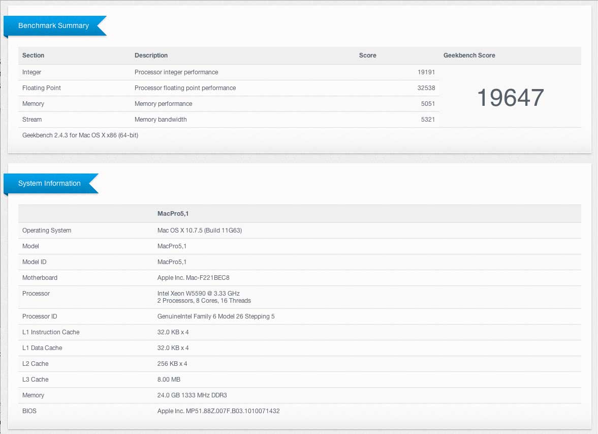

I have OS an 10.7.5 on an external Firewire 400 HDD. I ran Geekbench from the old OS and got the attached score. Much closer to my hoped for goal of 20K.
Lou

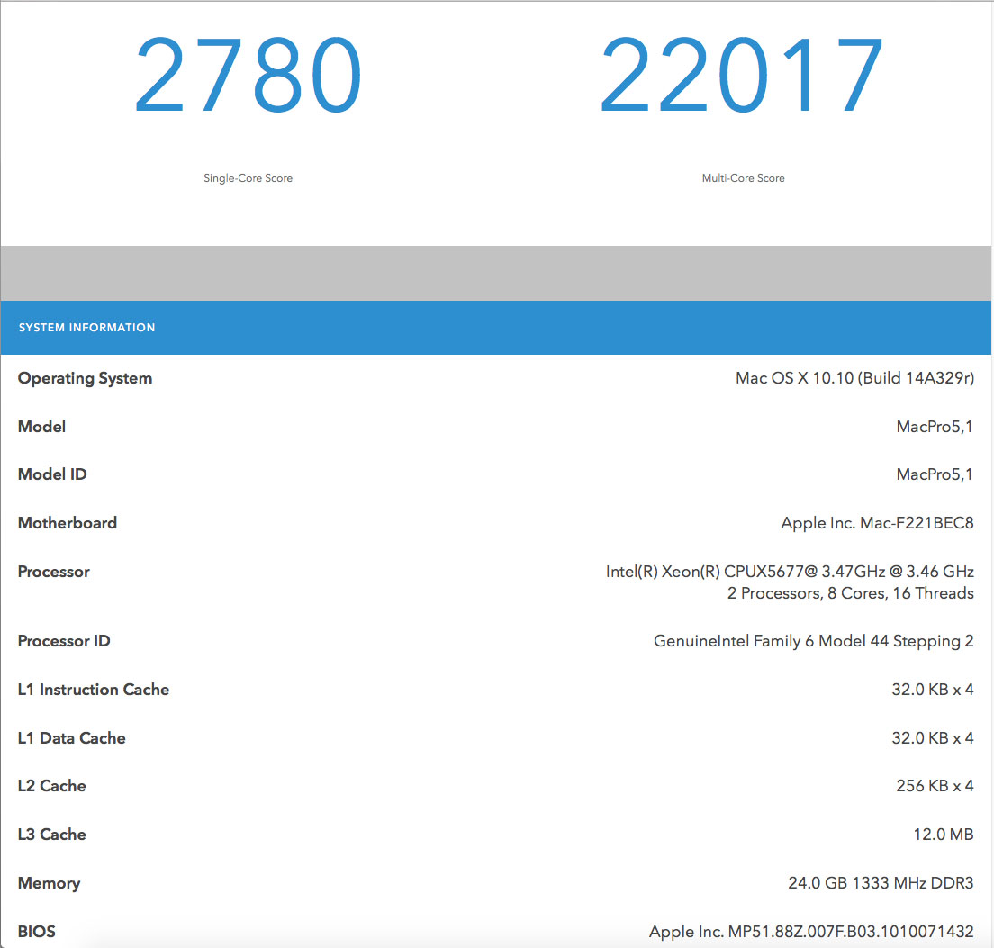

E5620 to W5590 to X5677 CPUs
I have since upgraded again, this time to X5677. I stayed with 8 cores because for what I do I believe 12 cores would be a waste. Also I thought the 8 fast cores would run cooler and consume less power than 12 fast cores.
