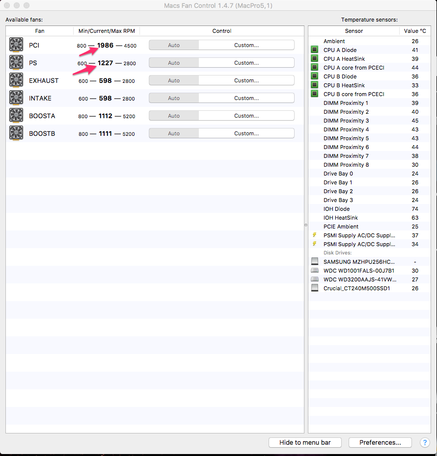

Just noticed that the fan runs loud and constantly when I open a browser like firefox or safari. So I installed macs fan control. See attached.
The PCI and PS(Not sure what PS is.?) seems to be running high for some reason and then slows down. I have OSX sierra. The main OSX is on a pcie ssd.

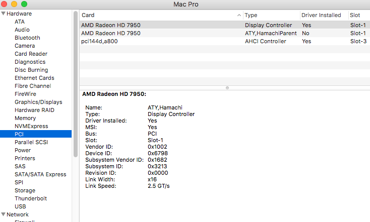

The graphics card is an amd 7950 and is the only graphics installed. See attached image of what I see in the system report.
The fans are quite now but they do run high when you open browser or some small app. not sure if i have to be concerned.

PCI and PS fans are ramping in my Mac when GPU is under load and hot, but 25˚C for PCIE Ambient is far from hot.
You can see my PCIE Ambient with two monitors connected. When I connect only one, it goes down to 30-32˚C and PCI Fan goes back to 800RPM.
