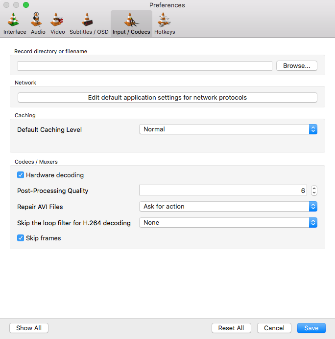

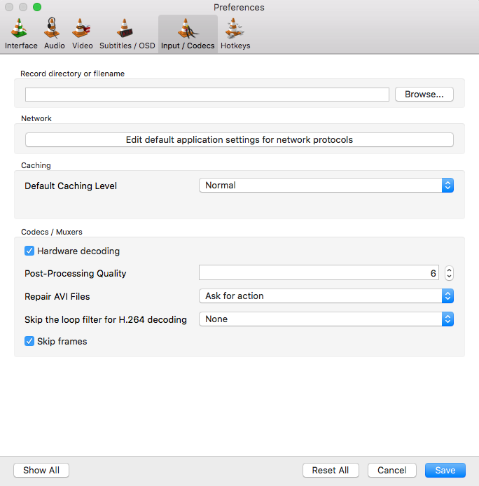

What version of NVIDIA Web Drivers?
What macOS version and build?
Hardware decoding checked or unchecked?
AFAIK, that hardware decode option has no effect on cMP. It's mainly for Intel QuickSync (or may be iMac Pro's Vega as well). For cMP, all hardware video encoding / decoding functions is blocked as OS level (in macOS). It's impossible for VLC to utilise the 1080Ti's video decoding ability (in macOS).

Turning that box ON/OFF can prevent a false triggering of GPU acceleration attempt, which could create playback issues (conflict) and/or crash during playback. Unsure what fail-safe measures are in place via software. There's also a lot going on here that the OP didn't report. Codec, bitrate, frame rate, HDR, profile and exact resolution were not provided.
