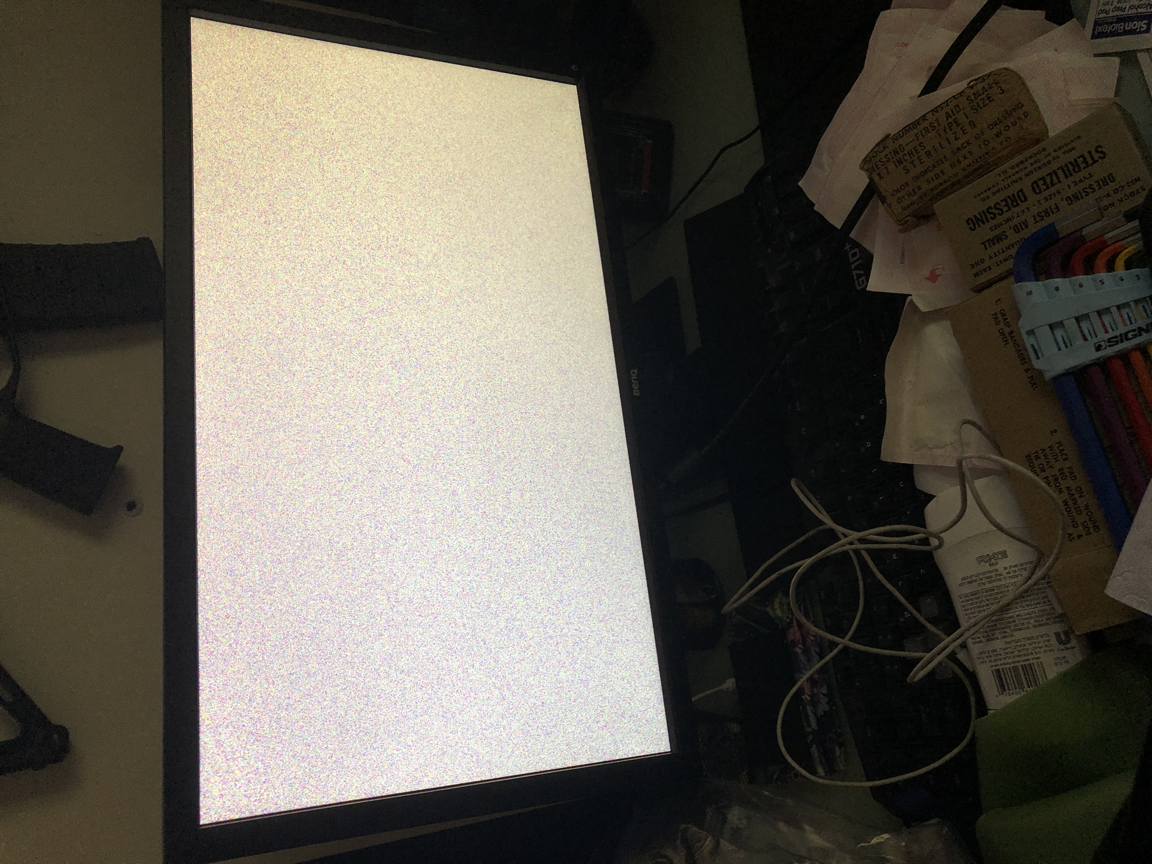

Regarding the gpu I had before the 980 - it doesn't work.
You said that there are no built in drivers for 700 series + but I tried using a GTX 680 to install the drivers and haven't gotten any signal with it.
I am confused. The GPU you have before 980Ti doesn't work? You mean it's broken, so that you buy a 980Ti?
I know for a fact the 680 does work, but for some reason when I put it in the MP I can't get a signal

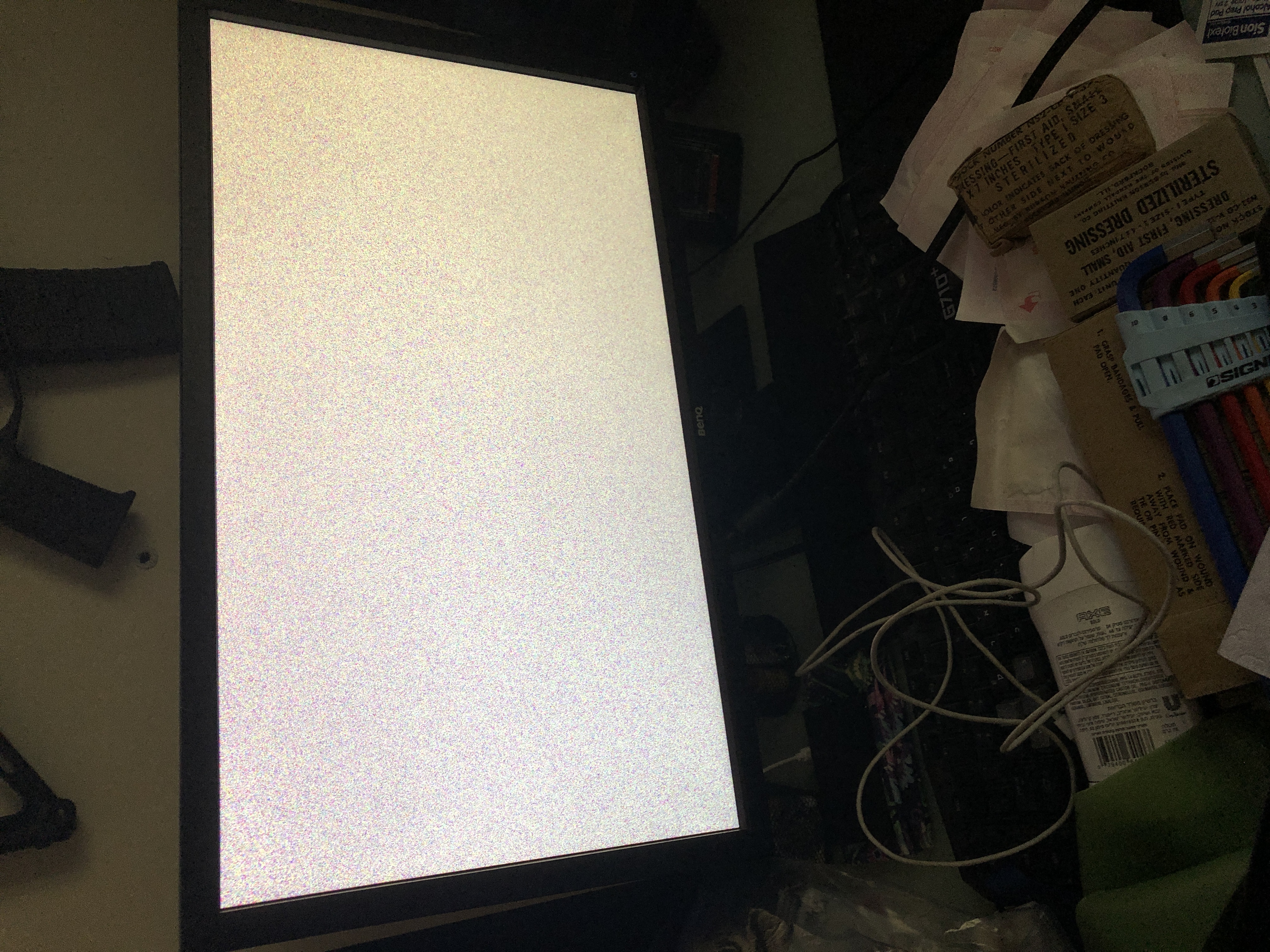

update: after booting with the 680 and waiting a couple minutes the screen appears static and doesn't change
