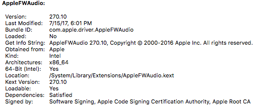

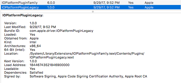

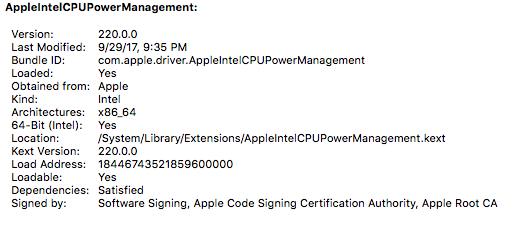

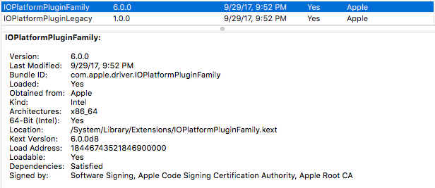

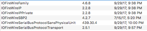

Have you filed a bug report with Apple? Sounds like they need a v1.2 audio update if simply copying kext files fixes this. Info from my 5,1 if it's helpful for comparison.

Here's the two that show on my 5,1. Wonder if there's a way to force FW devices to use the legacy driver?
