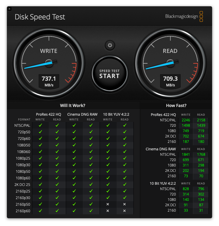

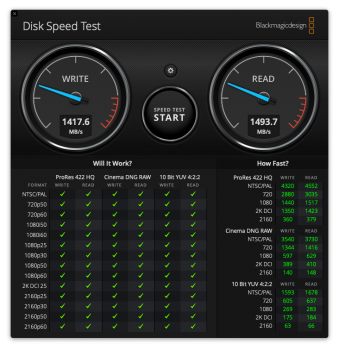

Others may find the basic performance stats of interest.
No Bragging just for interest sake, the mSata in RAID0 stripe is still only half the speed
