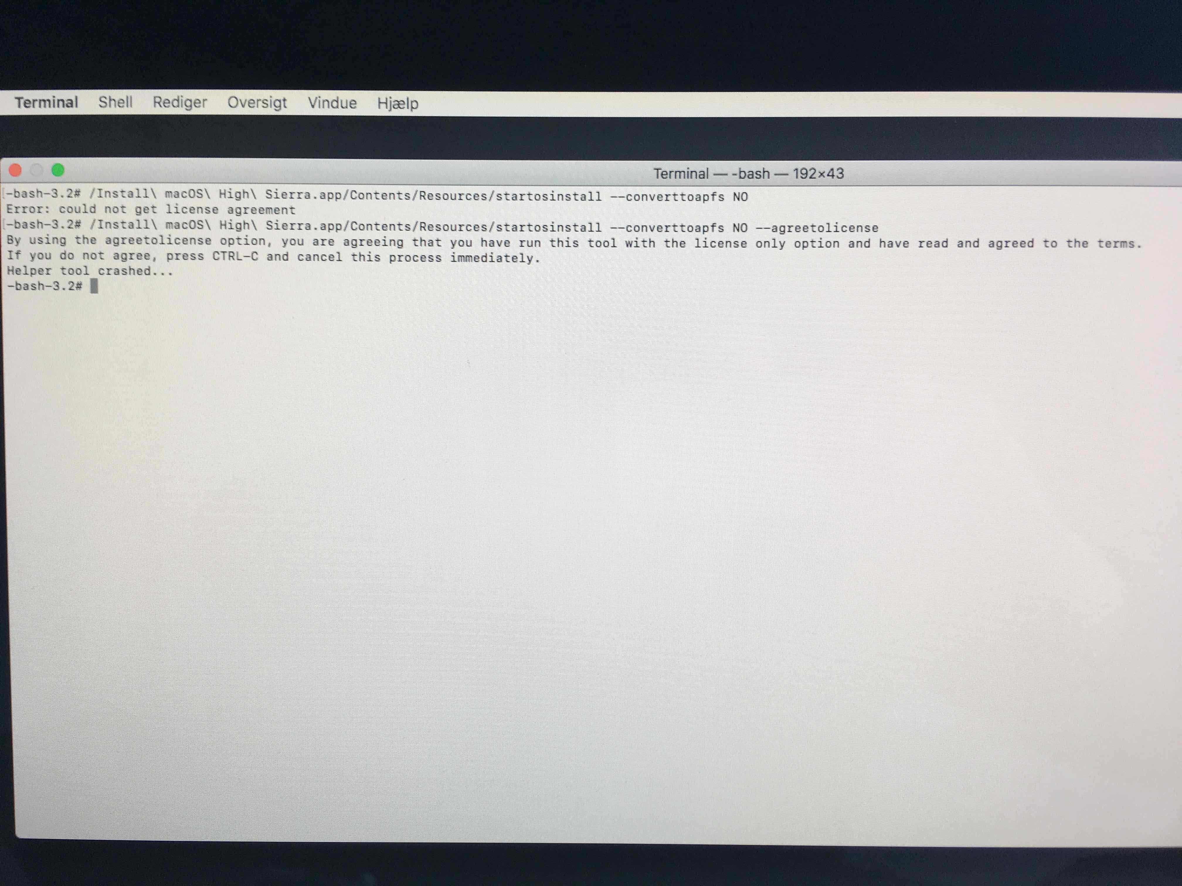

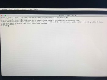

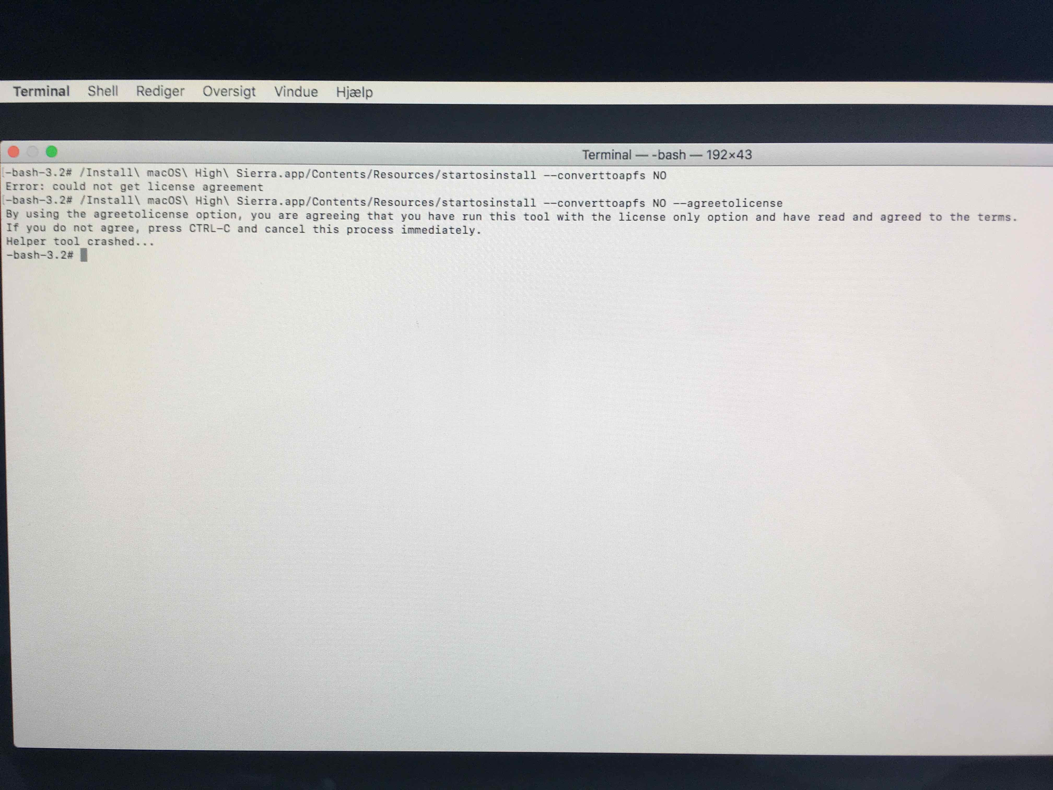

Maybe their is progress. Used /Install\ macOS\ High\ Sierra.app/Contents/Resources/startosinstall --converttoapfs NO
and got license error (that is new) so tried to put --agreetolicense and got the following result.

So far this is what currently seems to work:
1) Make a USB with HS installer on (bootable)
2) Only have the destination SSD connected
3) Make sure the destination SSD is formatted HFS+
4) Go to terminal and write the following command:
"/Volumes/Image Volume/Install macOS High Sierra.app/Contents/Resources/startosinstall" --volume /Volumes/name_of_your_partition --converttoapfs NO
You don't even need to name your SDD in the command - It apparently works anyways because you only got one possible destination anyways and the computer seems to figure that...
- By the way you need at wired keyboard and mouse (wireless stuff won't work when you boot from a USB it seems)
