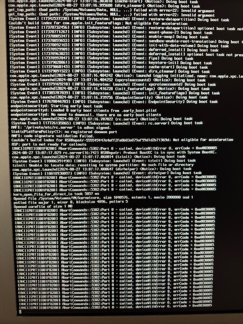

Yesterday I turned on my Mac Pro for the first time in the last 6 Months. Everything okay. Then i updated OCLP to 1.5. Also everything okay. The MacOS Version was 14.4 so i decided to make the Update to 14.6.1.
After that, i have the infinite Loop with this Errormessage:
So i deleted my SSD with Sonoma (i have also a Mojave SSD inside) and made an install with an Sonoma Install Stick with 14.4.1 (generated with OCLP 1.5). Everything fine. But when i migrate my Data from TimeMachine (via Synology) and after the first reboot ... the same Error.
I don't know exactly was this AHCI failure means but now i will install a clean copy and get my data manually back from my backup. I migrate the whole User but i don't understand, why this causes in a crash.
Perhaps, anyone has an idea? I also tried safe boot but this also crashes.
Here ist the line:
[AHCI][PRT][001F0200] AbortCommands: :5382😛ort 0 - called, deviceWithError 0, errCode = 0xe0030005
Here ist the line:
Disk/storage related message, all AHCI errors are storage related. The most probable is that your main disk is problematic/dying.

Mojave on the SSD (Samsung Evo 860) works fine for now. But when i want to upgrade, every attempt ends in infinite loops.
The messages with AHCI also appear, when i start recovery in OC. In the past i did my OC config at my own (with the tutorial here) and now i trust to OCLP, which worked fine for me the last two years.
Diagnose with Mojave, Sonoma will get you nowhere trying to diagnose this issue since, the missing AVX2 instructions can make macOS to have very weird behavior with crashes happening in weird and unexpected places.
Btw, frequent crashes can brick your Mac Pro since the crashes are written to the NVRAM volume inside the BootROM.
